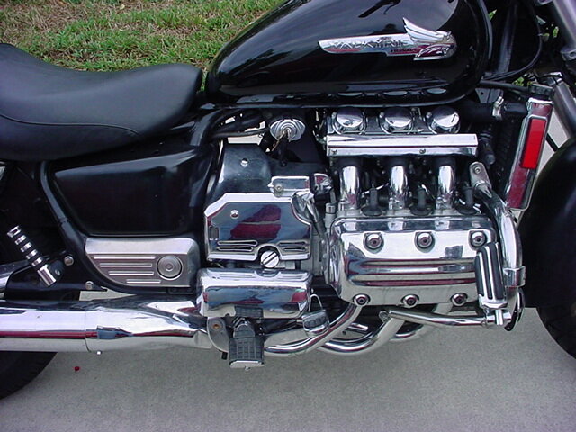

Maybe this will help.
My ex 99 Valks peg shot.
PS: They never were very comfortable for me, with the shifter being worse.
I had changed everything at some point.
Made a lowering bracket and tried other shifters. The Valk isn't a very adjustable bike. If it doesn't fit you. It can be troublesome.
Unfortunately the GL1800 is the same. For Hondas top of the line bike. Very little in the way of adjustability.

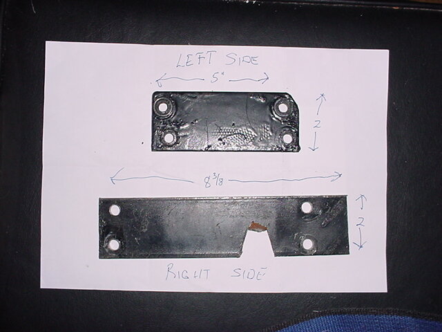

I looked where I thought the plates might have been and they aren't there.
Basically measure from the mounting holes of the foot pegs to the brake pedal mount.
Then add about 3 inches to the length.
To drop the pegs 2 inches is close to the ground leaning. As a trike should be more then enough.
Drill holes to use the OEM bolt holes. Then make a 2nd set of holes as low as you wish to go.
Passenger side the pegs and pedal will all drop as if it were one piece.
Repeat on the drivers side.
I used about 3/16s to a 1/4 inch steel 8 or 9 inches x 6 inches max on the right side.
Smaller on the left.

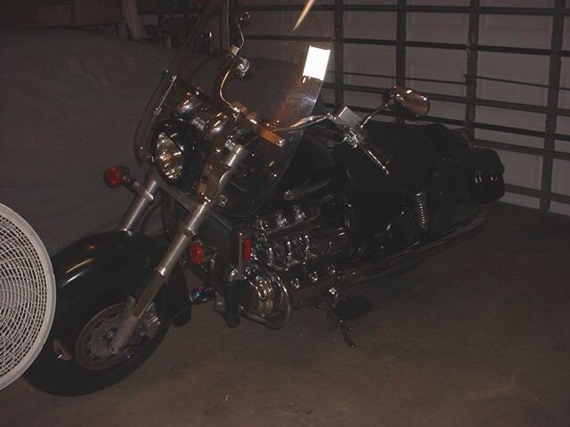

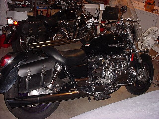

Heres a pic of both sides to show how low they were.
Sorry the 1st pics so crappy. But you can see them.

Heres a pic with some measurements.
Its in inches my metrics stink.
Cut outs for the brake pedal stuff.
