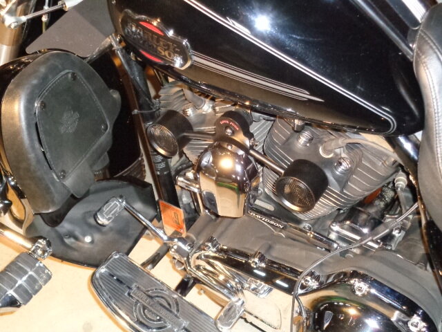

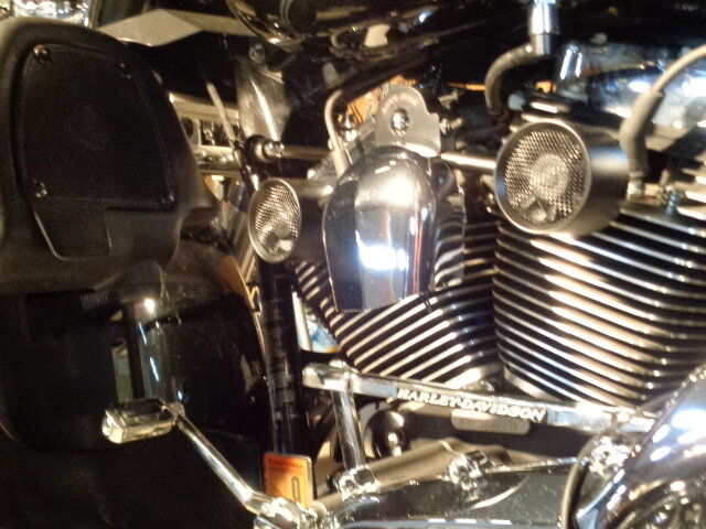

Will the 6 Row Jagg Cooler fit with the Love Jugs installed?
If you call the owner of this site at CUT-SHOOT Customs he sells to site members Love Jugs at a very good price. Plus you help him stay in business and this site up and running.
That is where I got mine great person to deal with... just sayin... Fred
Interesting Kevin however I was looking for the fan assist you know getting trapped in traffic. I would not object to having two but I believe one should have a fan to assure cooler oil. Is there a fan assist available for a upgrade for OEM? :Shrug: travel safe Fred
With your Love Jugs, don't think you really need a fan assist for the oil cooler. But, if you want one, since you have lower fairings, then the lowmount Jagg or Ultracool are the choices.
The 6 row will not work with a fan assist.
