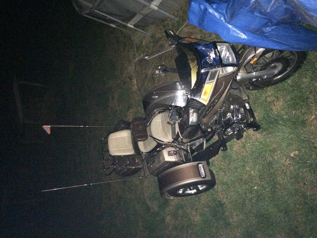

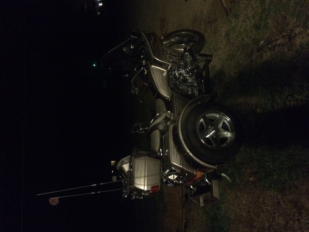

I have an 84 GL1200 Aspencade with a trike conversion kit on it. This one is a Richland Roadster kit from Trike on America. I’ve had it about 3 months, the odometer is broken but original owners says it’s around 180k miles. Doing good so far
