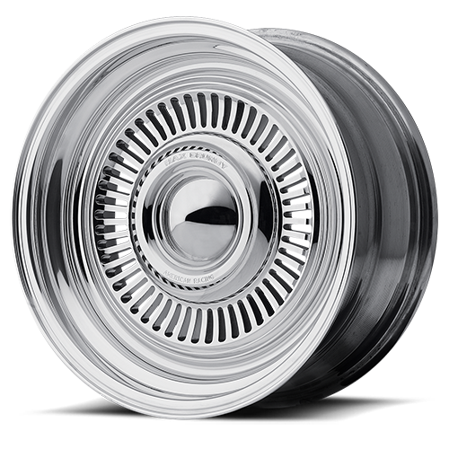

American Racing also has another option. Basically they cut the wheel to your specs.
..........................................front offset................ finish
VNB478560XX15" x 6"Blank -19mm to 10mmTWO-PIECE GLOSS BLACK W/ MILLED CENTER72.61580 lbs$670.00MG478CAP2
VN478560XX15" x 6"Blank -19mm to 10mmTWO-PIECE POLISHED72.61580 lbs$680.00MG478CAP2
asset.php
http://www.americanracing.com/wheel/14099/VN478 Turbine

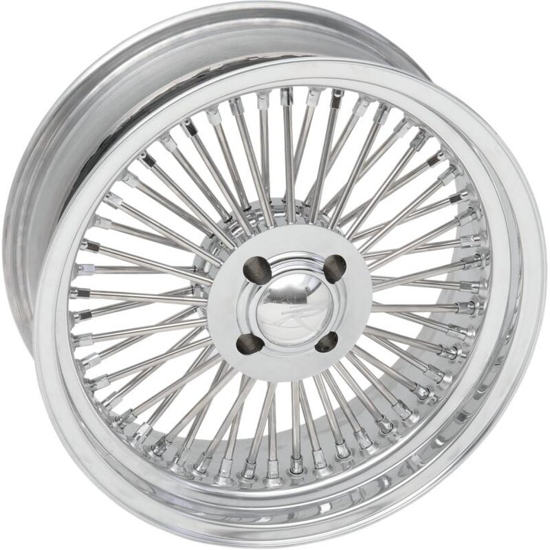

Today I came across one of the Cragar spoke wheels with 4/4.25 lugs. They have only 4 heavy spokes, but they were in 13". Tire guy is trying to find a set in 15".
I don't think Cragar ever offered that wheel in anything other than a 13" size.
asset.php
0 offset = 3.5" backspace. -6mm offset = 3.25". -12mm offset = 3.0. A 15x6 wheel with any offset between those numbers will fit.
