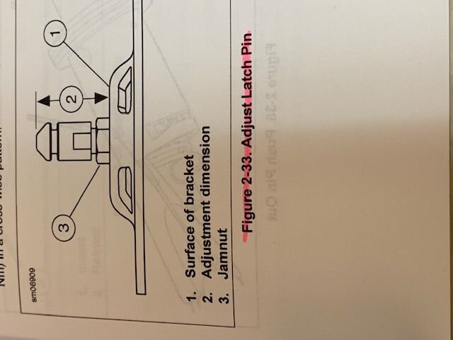

The first ride I took on my new 16 TGU was for about 100 miles. During this trip my trunk popped open 4 times. Needless to say I was not a happy camper. I tried closing slow and easy, slow and harder, and finally slamming it. When I got home I looked at my 2016 Trike Model Supplement Service Manual and found the process for adjusting it.
Well I have tried to post this picture vertical (the way I took it) but something insist on turning it. Anyway, the manual says to adjust the height (2 in pic) to 1.050 inches. I played around with this a bunch of times and ended up at a measured dial indicator reading of 1.125 for mine. Now when I close it I just raise it up, then with my thumbs on the top corner on each side, I just push on both corners firmly and hear it click in. I keep it oiled (not too much) periodically and once or twice a year I squirt a LITTLE liquid graphite in the key hole. My trunk has not come open one time since I did this. I am a firm believer in the DON'T SLAM IT suggestions. Hope this might help some of you.
