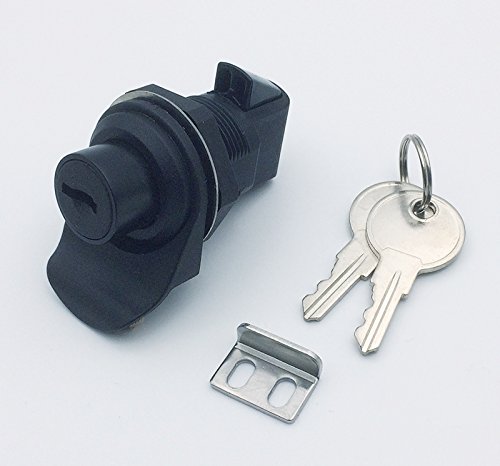

John, Welcome to Trike-Talk.......:wave4:...There isn't a cable ....Its a spade that a small plate drops on the spade and locks in a groove on the spade..
There are quite a few post's on that lock refusing to open.....
I wonder if you could remove all that fancy stuff and replace the lock with one like this...
On Amazon
Or this...
On Amazon
