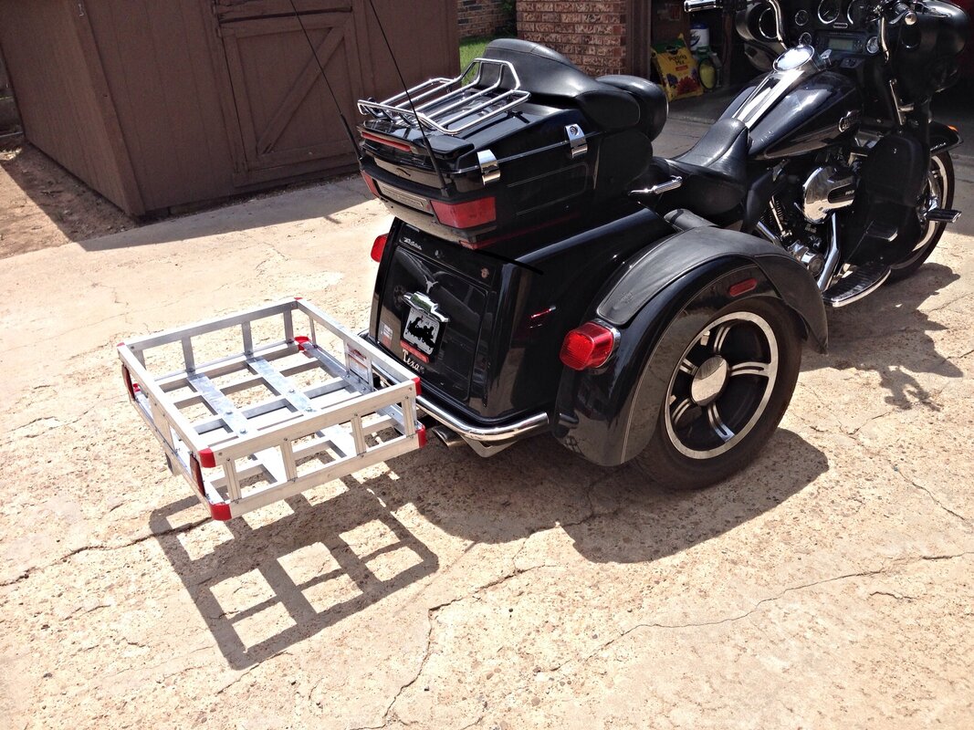

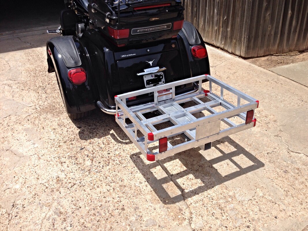

I went to Harbor Freight and picked up one of their aluminum receiver hitch luggage carriers and a hitch adapter to take it down to the proper size. I narrowed the aluminum rack so it was inside the rear fenders. The receiver hitch I used has a 7" rise in it so my exhaust doesn't cause any heat problems on what ever I'm carrying. Use it to Sturgis and back this year and worked like a champ. Carried my tent, tent poles/stakes, air mattress, bedroll (appx 40#) with no problems.
