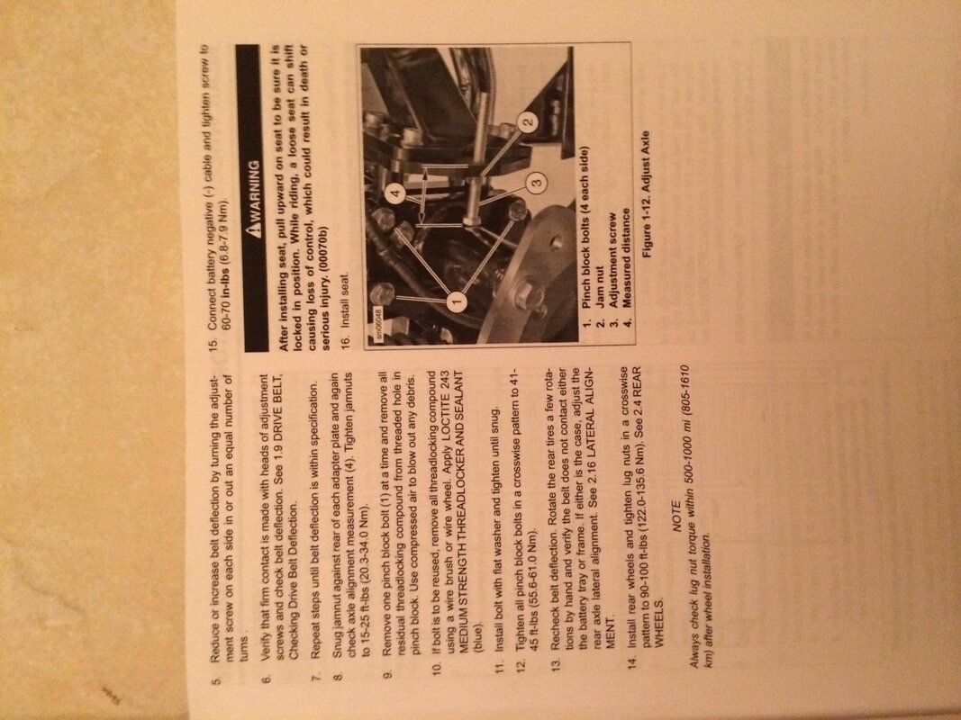

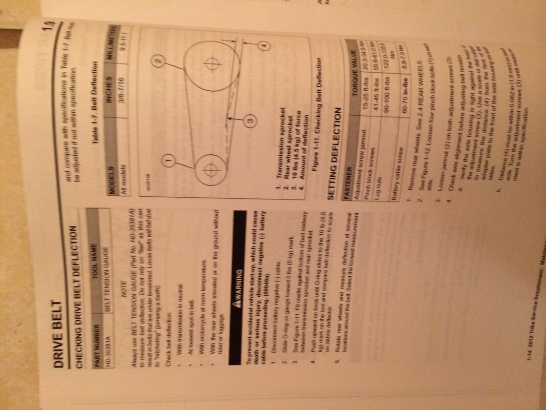

Adjustment Screw Jamnut 15 to 25 ft lbs
Pinch Block Screws 41 to 45 ft lbs
Lug Nuts 90 to 100 ft lbs
If you send me your email address I will attach the supplement SM
Hope the attached pictures help a little I know they look terrible but its all I got.
