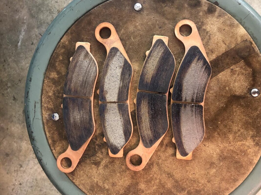

Pad wear after 40 Miles. Rotors had been ok. Might be toast now. Wheel off. Will check runout on neighbors truing stand. Pistons still push in ez.IMG_4760.jpg
Pistons can be pushed in by fingers. Takes a bit of effort but doable. Pushing pistons out on right side while left caliper still on I used a wedge between pads to not possibly over extend pistons and when pads tight on wedge continue squeezing and you could see retraction of the pistons on release of lever. Left side just not enough hands to see same action but pistons push in by fingers.
Aftermarket pads to thick overheated and toasted rotors? Thinner OEM pads overheat because of toast rotors? I’m still at a loss. For now until budget allows for rotors no more trike riding. At least I’ve still got a 2 wheeler to help with my sanity.
I would try unhooking the lines at the calipers, maybe a bad line? The pad on the right looks like its barely making contact as if it's not seating straight in the caliper? & the pads look like they got really HOT.
