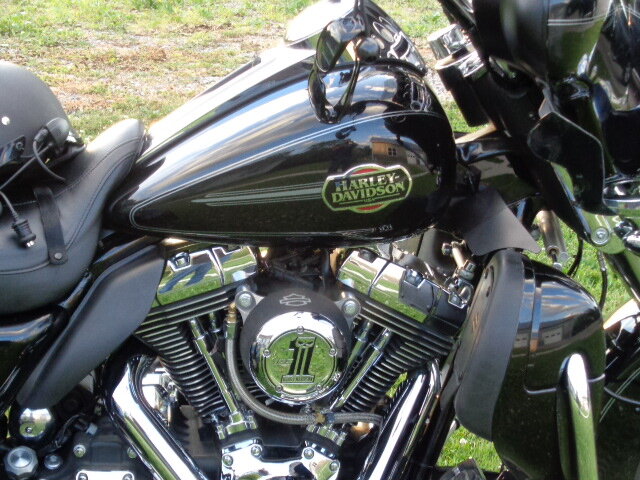

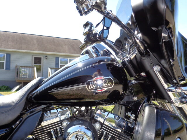

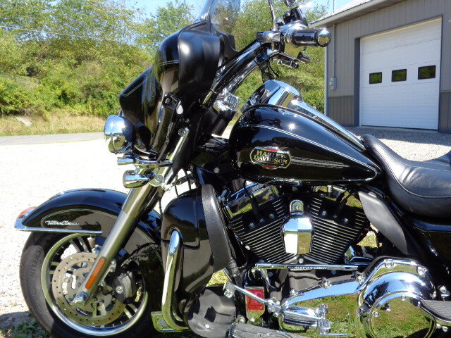

One of the first changes I made to old shiney, 2" front 1/2" rear. for three reasons all explained by Kevin of DK Customs. First pushes more air down on motor (good thing), also makes cleaning motor easier (good thing) and I think it looks a little gives it attitude if you know what I am saying. This is about the time I added Power Vision tuner great addition more than just fuel management it is information central for me. I also added the air deflectors when they were developed, now if I still smoked I don't quite 25 years or so ago (good thing). I believe I could smoke a 60 MPH, very little air in face and chest, More air on motor (good thing) very few critters on front of gas tank and those that to stick are well on the bottom 1/4 of tank front rocker boxes littered with remains of assorted bugs. On an 80-90 degree day 230 is the norm (good thing) we rarely see 248 that is in slow traffic, before It constantly was reading 255 to 275 and in slow traffic I was panicked when the motor temp went to 280 to 290.
Tank lifts alone will not solve heat issues but I believe it certainly is a great place to start and doesn't cost an arm and a leg to get done and you can do them easily yourself. I would wait till the fuel level idiot light came on, empty tank is much easier to handle. While you have the bolts out you may as well do air deflectors it really helps. Travel safe Fred

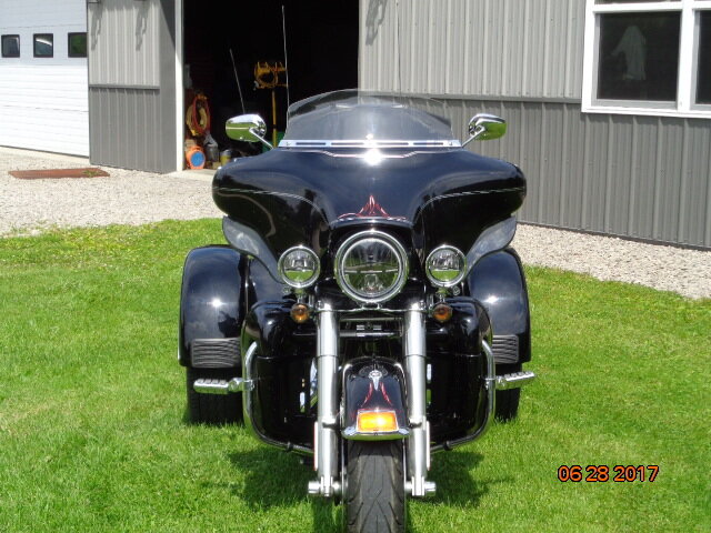

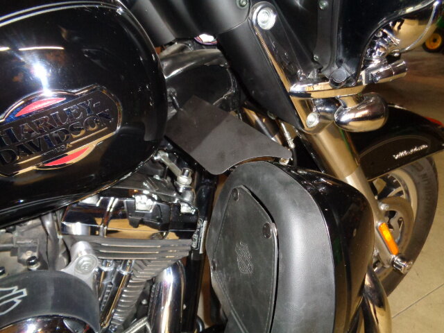

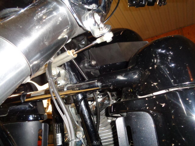

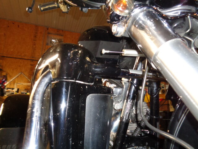

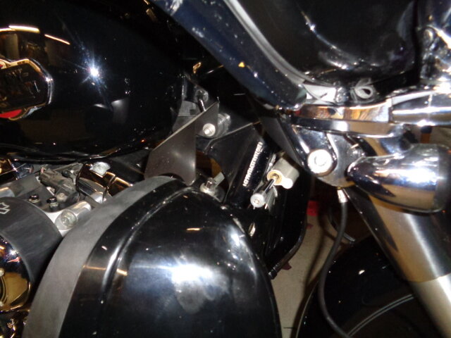

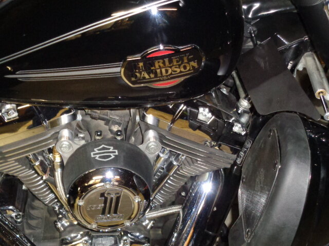

The deflectors and tank lift also help reduce wind buffeting a lot. I had the fork lower deflectors on mine before and they did a great job of eliminating wind buffeting, but reduced the air to the engine and to me. If fact I got very little air which was not comfortable as weather started heating up. The deflectors and tank lift significantly reduce the buffeting, direct air to the engine and I still get enough to stay comfortable when it's warm.
If I want more air I just turn the wings on the faring a little DSC00550.JPGDSC00551.JPG
Reading this post and seeing Fearless's photos reminded me that I wanted to try the deflectors. When I did my 1.5" tank lift I didn't get them. Ordered them from D&K and they showed up about 3 or 4 days later (usual fast service). Slapped them on yesterday and they certainly help on buffeting. Wish I would have installed them when I did the lift.

Fearless... "If I want more air I just turn the wings on the faring a little" You are correct about that. You can definitely put some air back on the rider and engine area playing with the fairing wings.
