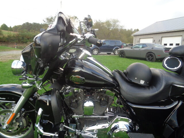

I went to a 2" Lift deluxe ie. 1/2" on back also I was changing Handle Bars then also to 2+2 wide sweepers from Khrome Werks really affordable and switched them also myself. Could not be happier with the results these were changed in an effort to lower motor temperatures. And these changes have worked wonderfully for us. travel safe Fred

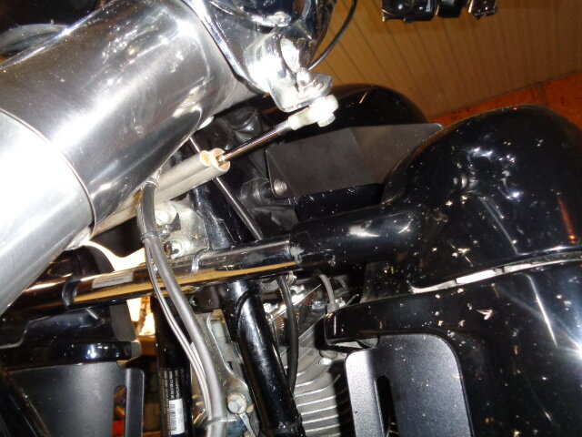

View attachment 77938View attachment 77939

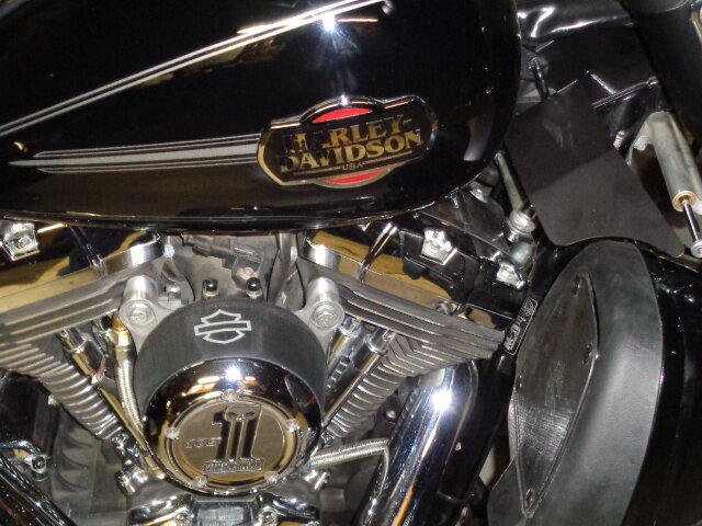

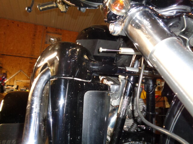

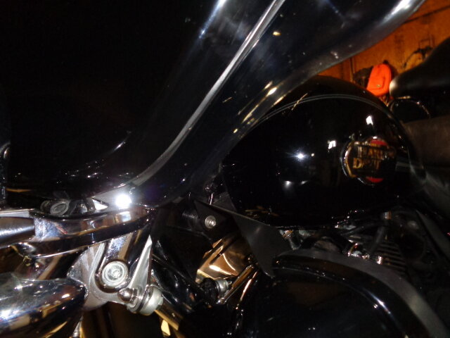

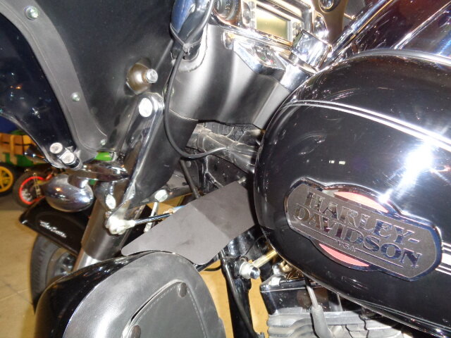

Didn't mention the air deflectors made a huge difference air coming up from the lower farings
Oh by the way I found proof pictures Bugs.. on the lowers none on the fuel tank or my jacket. since installing the air deflectors most all of the air is on the motor.
