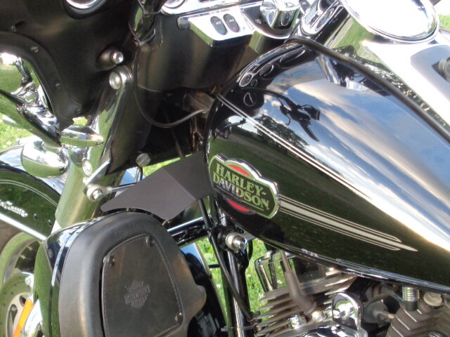

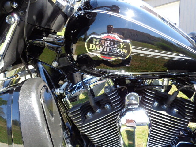

Raised mine 2" and 1/2" in back all the critters go down on rocker boxes not on fuel tank if that says anything I also added air deflection wings from DK Customs really stopped the glasses dance. These changes made a huge difference in wind in the face which means wind on motor a good thing. :good:ride safe Fred

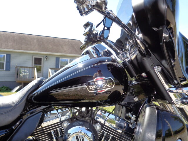

My 15 gauge changed some. Used to be that when the low fuel came on it took right at 5 gallons to fill. Now it takes 4.8 to fill. But I just lifted to show more chrome. I did not check temps before install, so would not know if it helped any by checking it now.
I just did the front lift. Even just doing that it may have made a little difference in how the wind came up around the lower part of the bike. I know when I ride with two other TG's many times when we stop and park their fans are funning for a minute or two and mine aren't on, so I assume mine is running slightly cooler.

In all our controlled testing of Tank Lifts on Twin Cams and M8's, the temp drop varied between 10-15 degrees. All our testing was with the Deluxe Option.

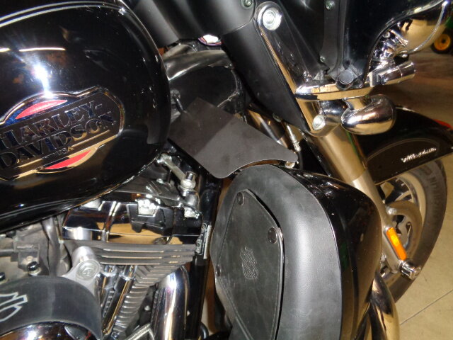

Just ordered these
I just ordered the DK Custom Wind Deflectors and the Deluxe 2" Tank lift for my 17 TGU. I figured any little bit I can do to lower the operating temp will be a good thing. I almost ordered the 3" lift but thought that might be a little to much?
I have a 2017 Freewheeler & went with the 1.5" lift deluxe option & can tell by my EITMS operation between this and last summer that it is cooler running & the various thermal temp readings I took range from 5-10° degrees cooler.
Yes, a 3" tank lift might have a clearance issue on the TG.
