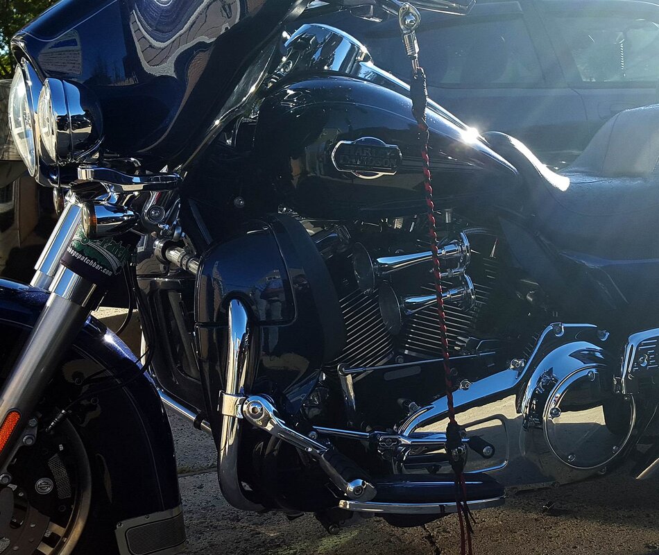

Buffeting isnt an issue for me since putting the higher shield on, mine is the updraft...combined with a beard and, well...I'll let a picture better demonstrate:
If I forget to put a hairtie in, I have to look through a wall of hair to see where I'm going LOL

Takin forever to grow though...be happier when it's 6" longer (and I'm sure I'll be saying "just another 6" then too...) never ending cycle. But it's at the point now female strangers ask if they can touch it, and random cats in traffic yell over "righteous beard" at red llights (I work door at strip club too....several of the girls made it ritual to stroke the beard for a good paying night....who am I to complain?).
Odd part is, I've had a beard (trimmed back at times) since becoming disabled on 05 (former LEO...had to stay clean shaven since joining Army in 89 at 18yo), and only recently its become "cool"...8 to 10 years ago, they would stare at me like I was homeless (with a Harley? :xzqxz:)

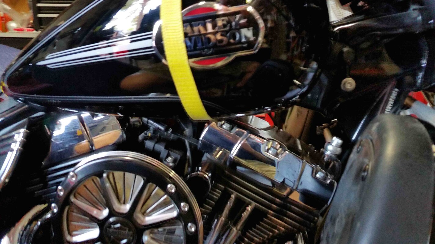

Installed the lift, got the 1.5" from DK, almost wish I splurged and went the full 2", but I'm still happy with the clearance over the heads now. Still have the updraft (though not as bad), but I picked up some stainless from Home Depot, going to make a baffle (this one: https://app.box.com/s/0dhgtkp547gvktfc64zn/1/431818932/3520037604/1 ). Only downside is I feel tighter in the seat with the rear lift installed...I did slide forward as far as I dared, left a 1/2" clearance between tank & fairing. I'll probably get used to it, only had time for a 3 mile test ride so far. the XIED's were just the ticket for smoothing the engine out.
All-in-all, happy with the results, and VERY happy with DK's service & shipping times ThumbUp
View attachment 30789View attachment 30790

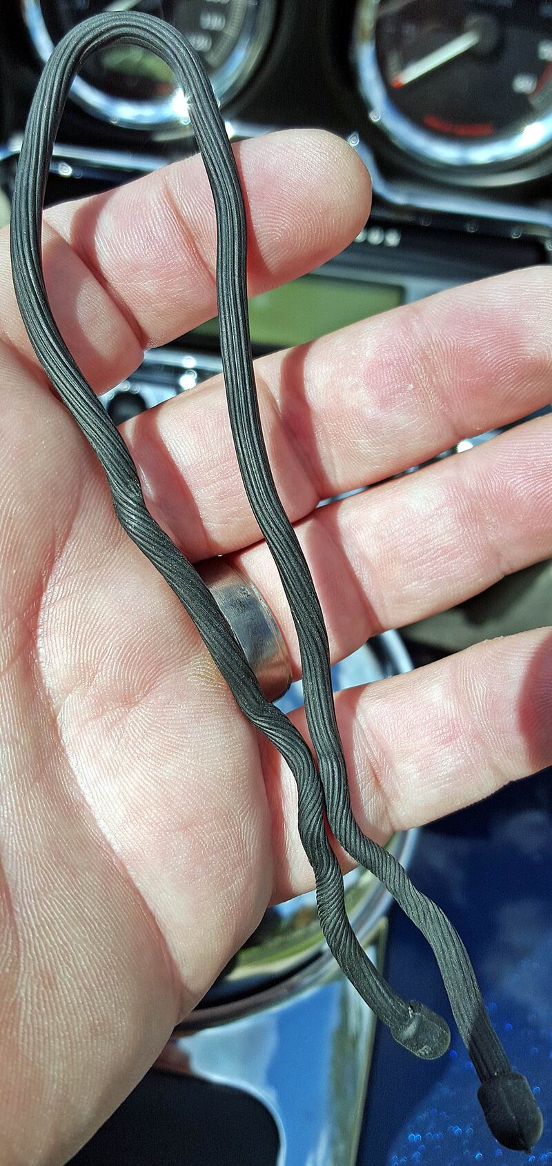

Thor, I see in your second picture that you are using something to hold your front brake leaver in the squeed position. Curious to that thing is your using?

Good eye!
I don't remember the "proper" name of it, but it's like a heavy-duty twist-tie wrapped in thick rubber...I grabbed it at Home Depot. They have different sizes and colors, and it was only 2 bucks for a pair IIRC. It was my alternative to finding a velcro strap...It's my parking brake, as I don't want to dick around with the lever settings :Dorag:

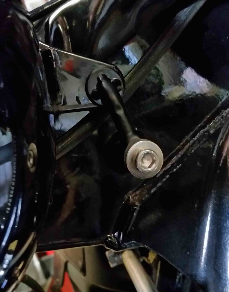

Installed the DK 1-1/2" lift today. Did not lift the rear, yet. Need to test ride in beautiful Las Vegas fall weather. I did not use DK supplied nuts, instead I used Ny-Locks and blue thread lock. I also trimmed the OEM rubber covers so they would cover as before. (If I installed the lift pieces inside out, so be it, I have no clearance issues.)

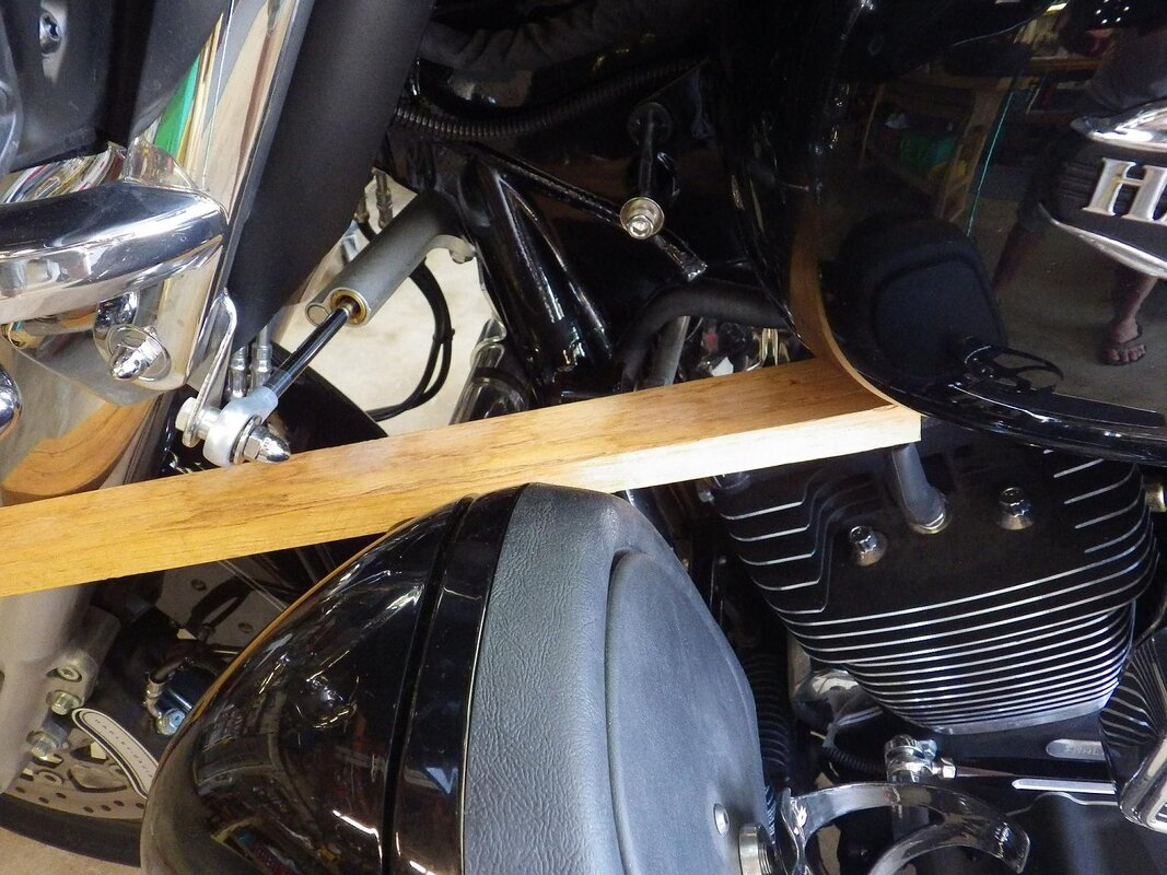

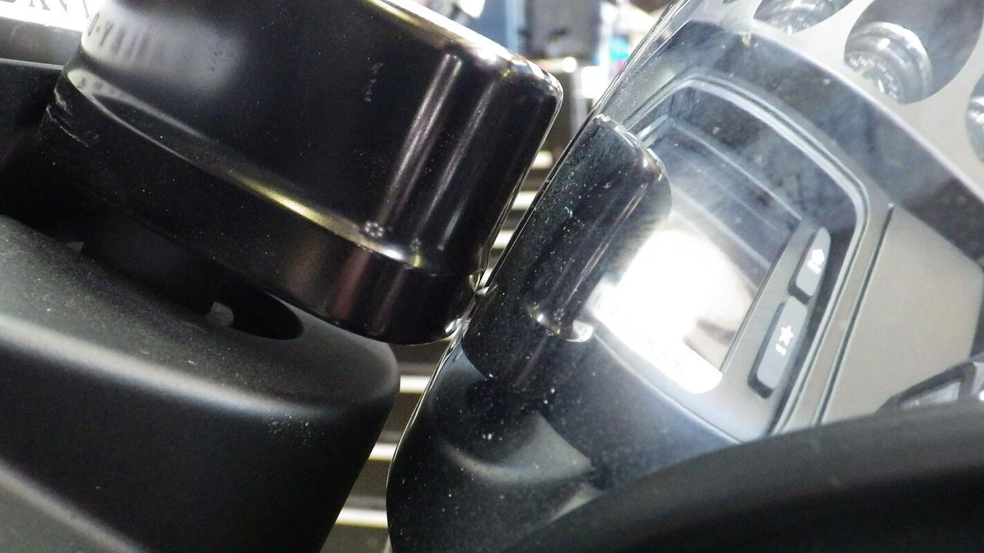

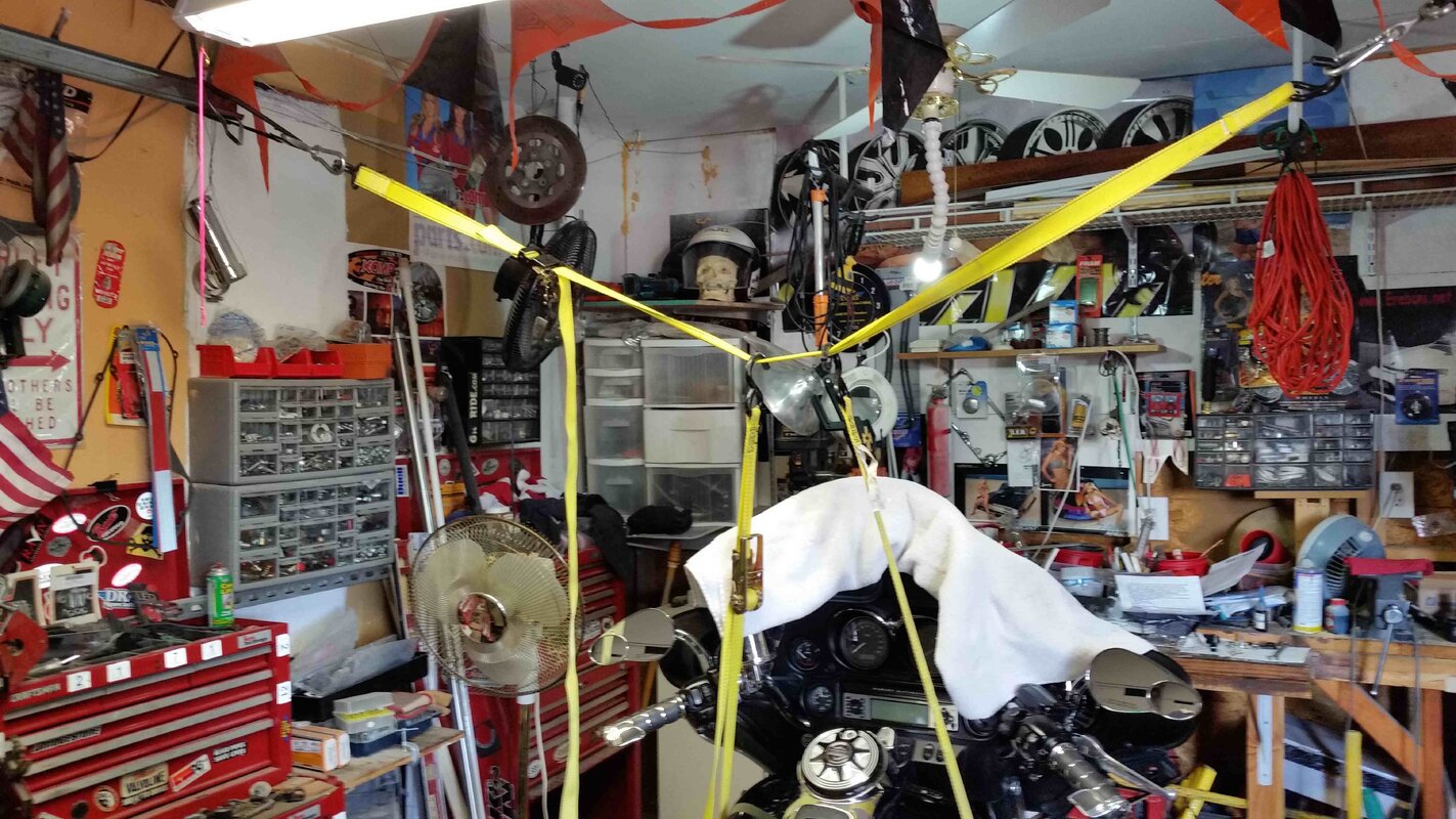

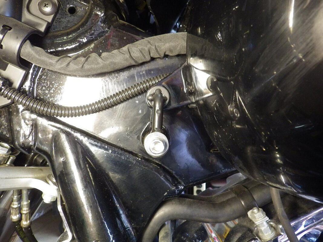

I got and installed my DK 1 1/2" Tank Lift today and it was easy peasy, and as expected with any DK product.....top notch. Because I did not have a helper or three arms, I chose to use a piece of wood as a pry bar to help lift the tank AND install the bolts, and it worked like a charm.

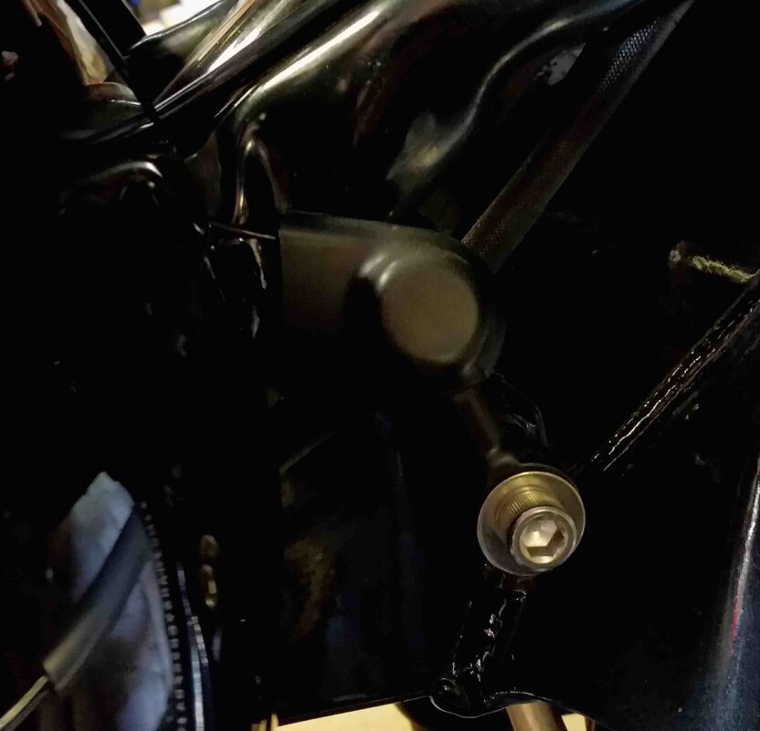

I also got the Deluxe Option rear spacers, and chose to move the tank as far forward as possible leaving just enough room for the ignition switch (with cover) to rotate. It wasn't much of a move, but now I hope the raised logos on the side of the tank will be forward enough so my knees do not rub up against them. And because the Deluxe option rear spacers also lift the front seat attachment point, it 'should' mitigate the slight sliding forward during braking that I have experienced after installing the Comfort Lift kit in the rear.
Gonna move mine forward a bit more. If you're having no issues with it that close, I'm going to follow suit ThumbUp

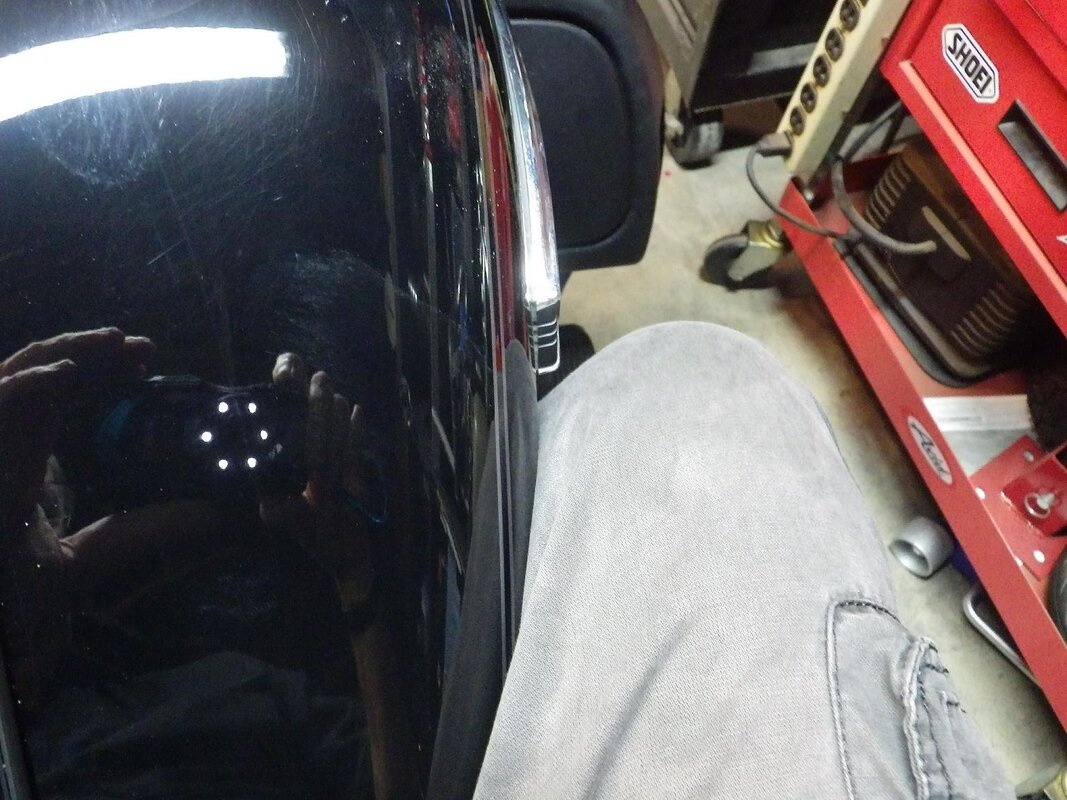

I went for a little test ride, and the seat now feels like a catchers mitt and my butt is the ball. No sliding forward at all, and my knees no longer rub up against the tank emblems. This was a WIN WIN!
