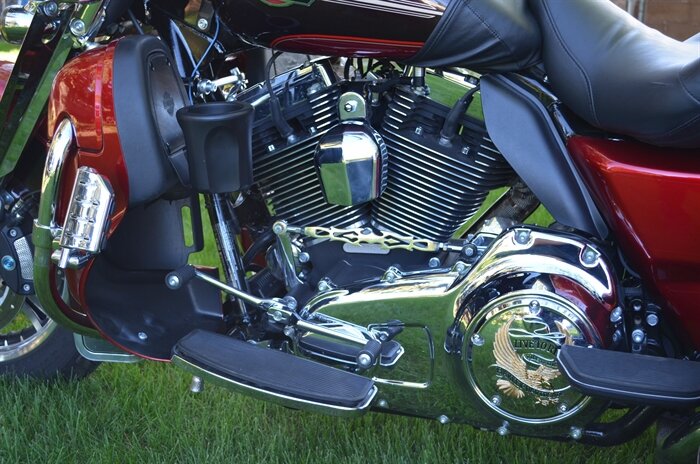

I have a 2" deluxe version on my '12 without a problem. Kevin (DK) has a 1.5" but he also has taller bars.

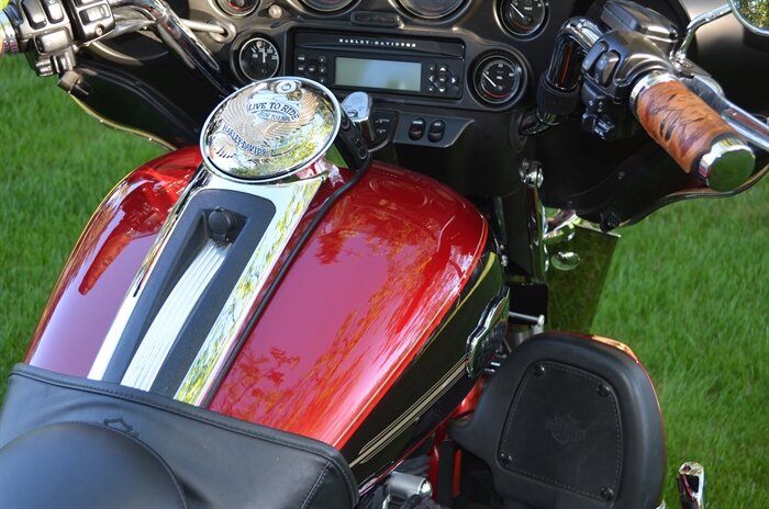

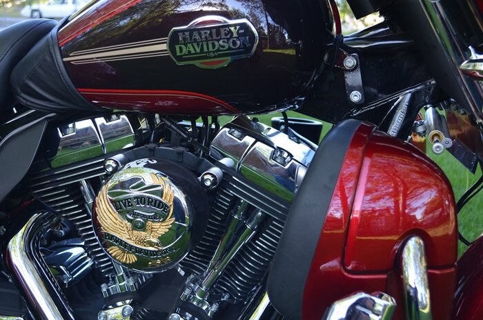

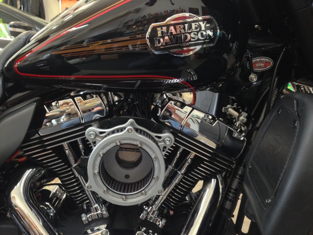

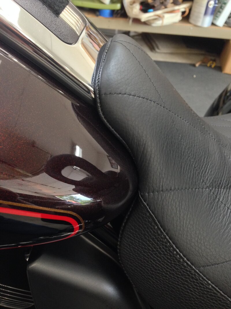

Here are 2 more pix's of a 2" lift w/1/2" in rear.

Here's a pic of my 2014 with a 1.5" with a Deluxe option with the stock bars and room to spare. It was a 30 minute install, max.
I installed the 2" lift with Deluxe option (1/2" in back) and had absolutely no problem. I still have the stock bars, and found that with this kit, you can move the tank forward and back by a surprisingly large amount. If you were not careful, you could easily have interference with the bars, but it is just as easy to move it back plenty to avoid contact. Great addition!

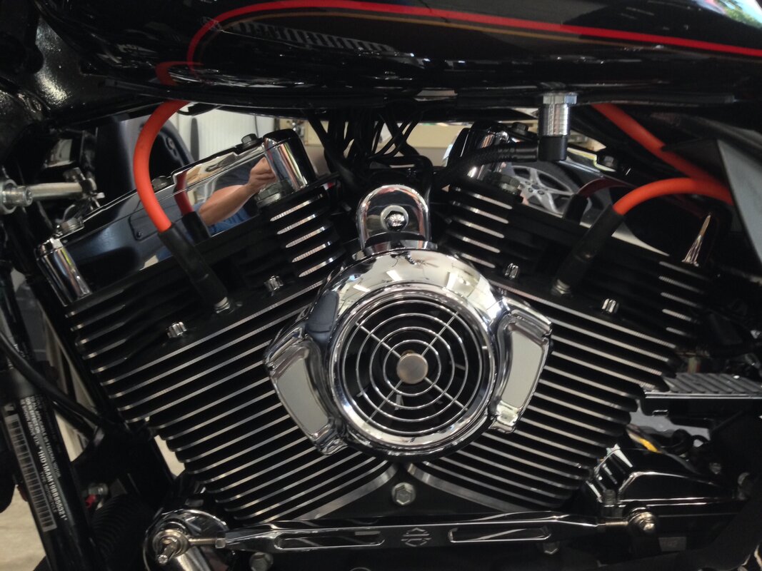

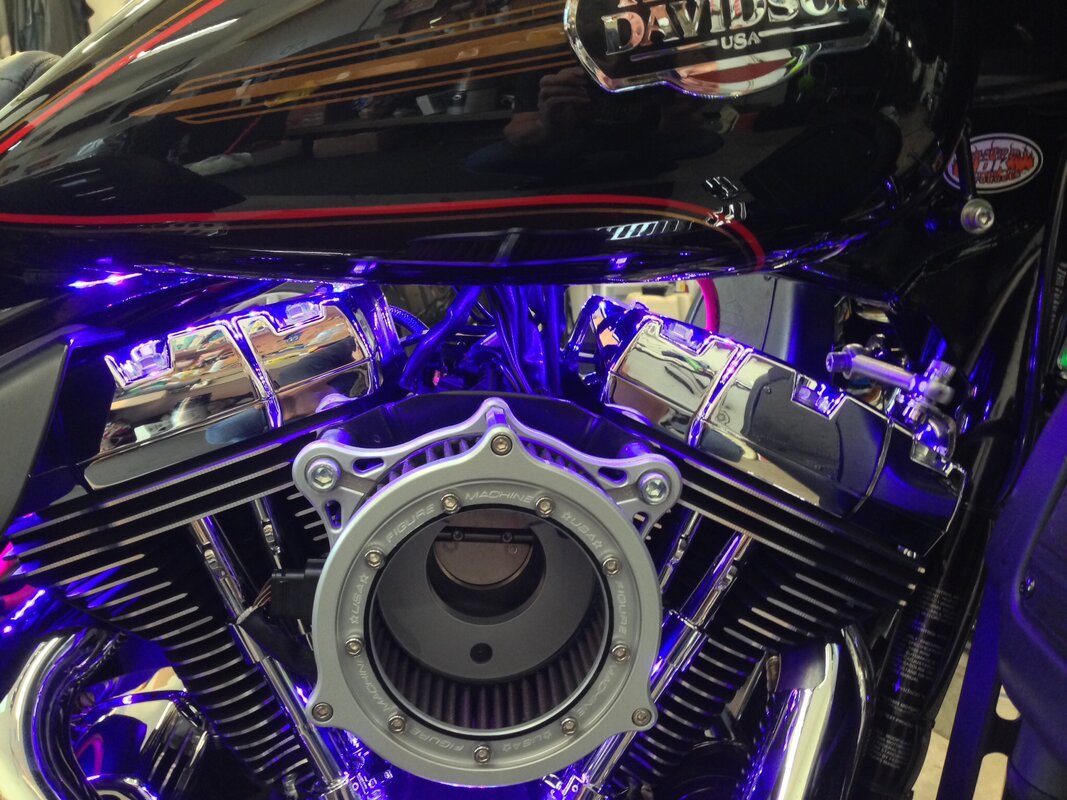

hope these pics help
lights made and designed in the USA by the way 19 colors and a ton more
micbear
