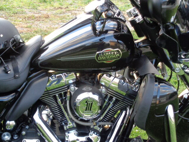

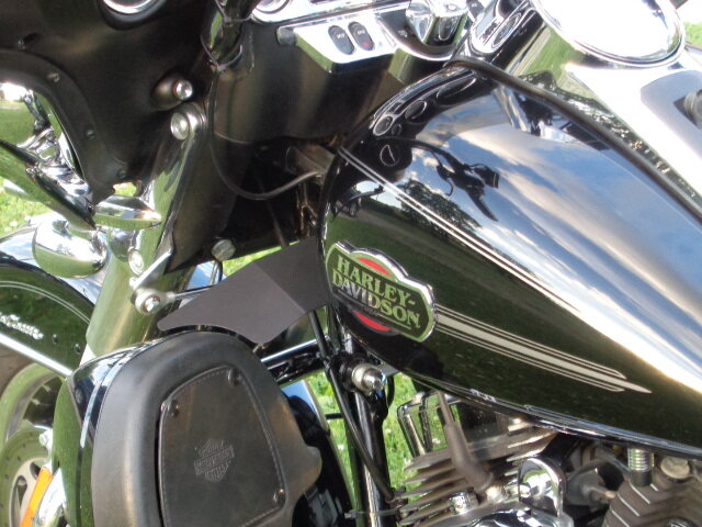

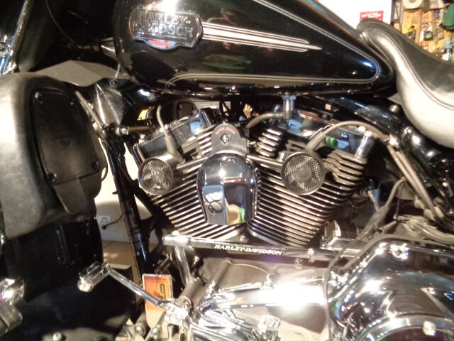

I did the 2" to make sure my 2+2 wide sweepers would clear worked out really well. Lift pushes air down on motor not up over on the chest and face. More air on motor cooler, cooler motor runs longer more comfortable for rider and passenger I like my choice. good luck on you height choice. :good:ride safely Fred
