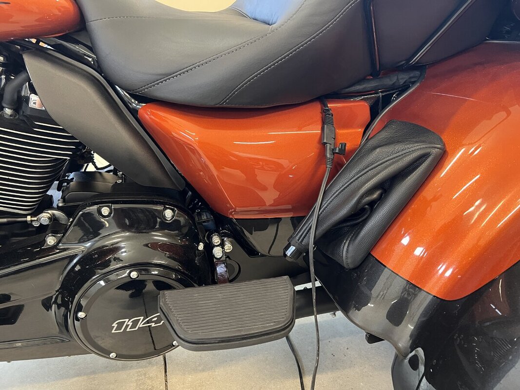

Decided after I installed my HDTR Roadsmith kit on my 2020 Ultra Limited last summer that I wanted the Aux gas tank to increase my range as we ride with some friends who are still on 2 wheels.
So I ordered the Aux tank kit and just got it this afternoon. It's a very well made kit! I'll be studying the instructions that came with it this evening and will probably get started installing it in the next couple of days.
Now for my question....
For those of you that have the Aux fuel tank, where did you mount the switch and 2 LED telltale lights? Can you post a picture of yours? The instructions only show the wiring diagram for it and just says to mount the switch.

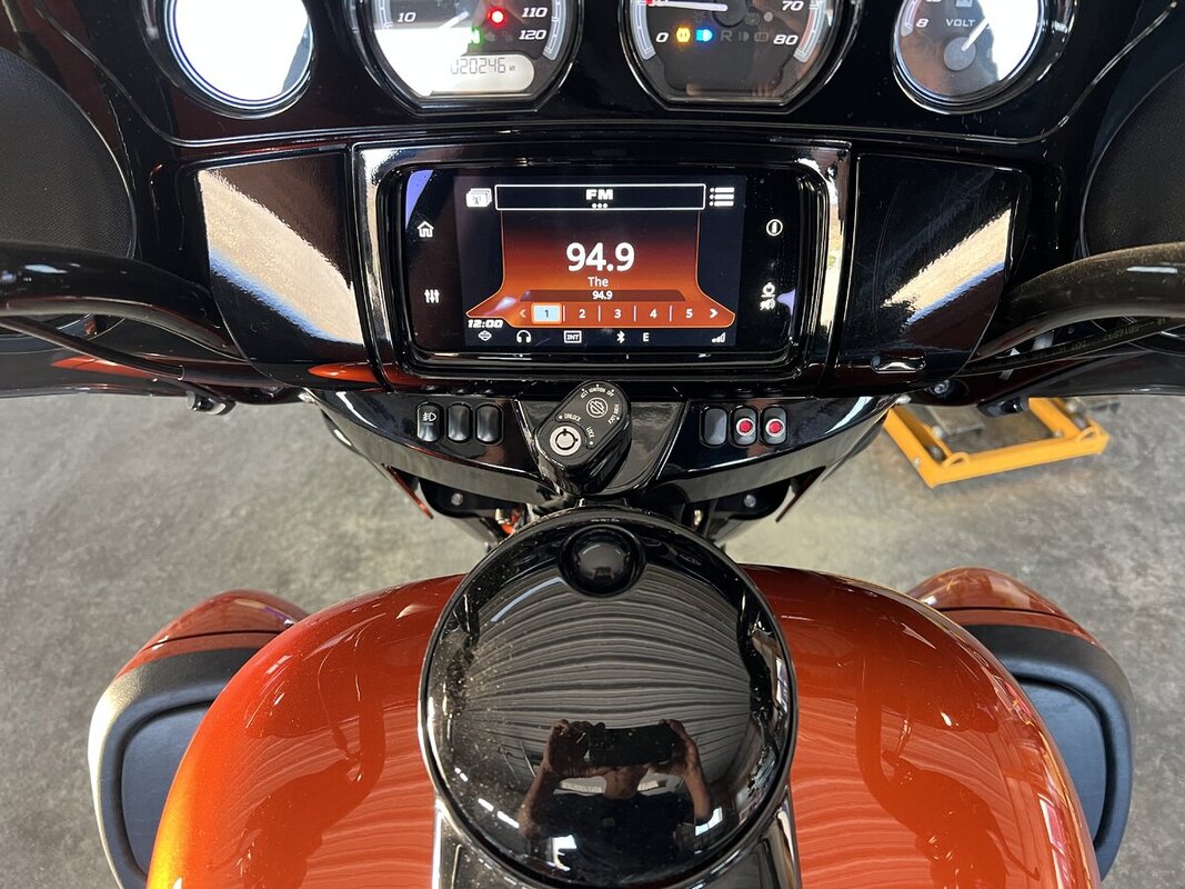

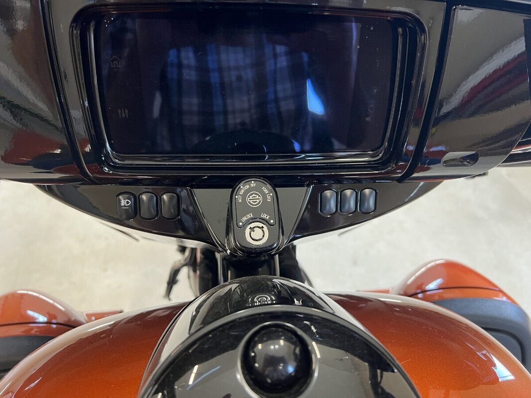

There is a switch panel on both sides of the ignition switch with 3 spots for a total of 6 switches. 1 of them is currently being used for the front Aux lights and the other 5 have a blank out in them.
Was thinking about ordering a Harley OEM Aux switch and mounting it on the left side, then drilling a hole in 2 of the blank outs on the right side to mount the LED telltale lights.
Or the other thought was to drill a hole in the left side cover panel under the seat and put the switch in it with a quick disconnect coupler. Then mount the 2 LED telltale's in the same switch panel blank outs as above.IMG_1344.jpegIMG_1345.jpegIMG_1346.jpeg

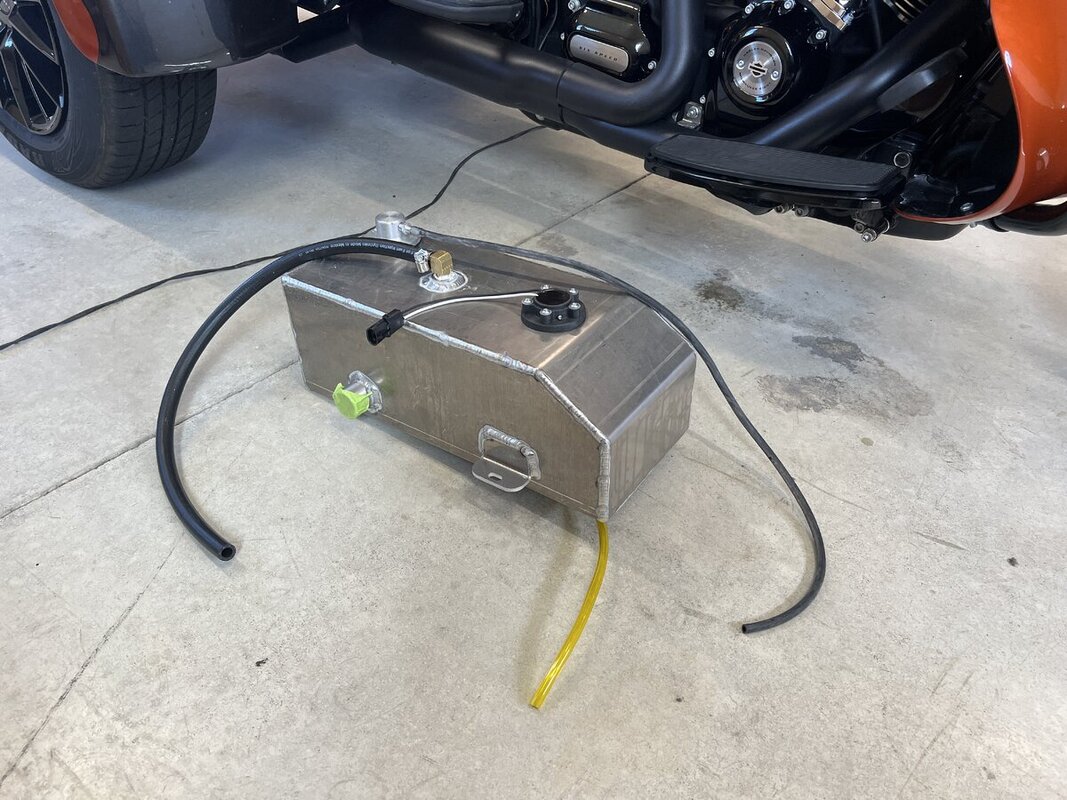

I finished up the Aux fuel tank install yesterday. Not really a hard job, but lots of little details to cipher out. Got sidetracked with having to clean out the main fuel tank after discovering some black crud in the fuel filter. Overall, very pleased how it went.

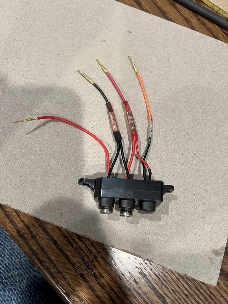

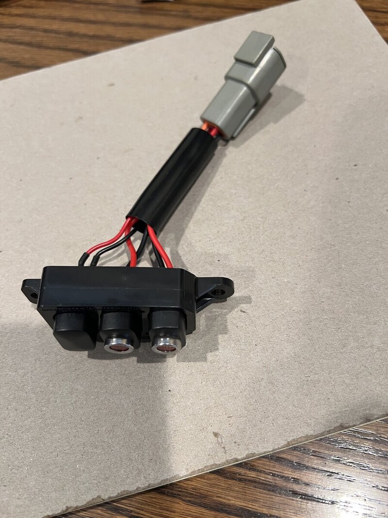

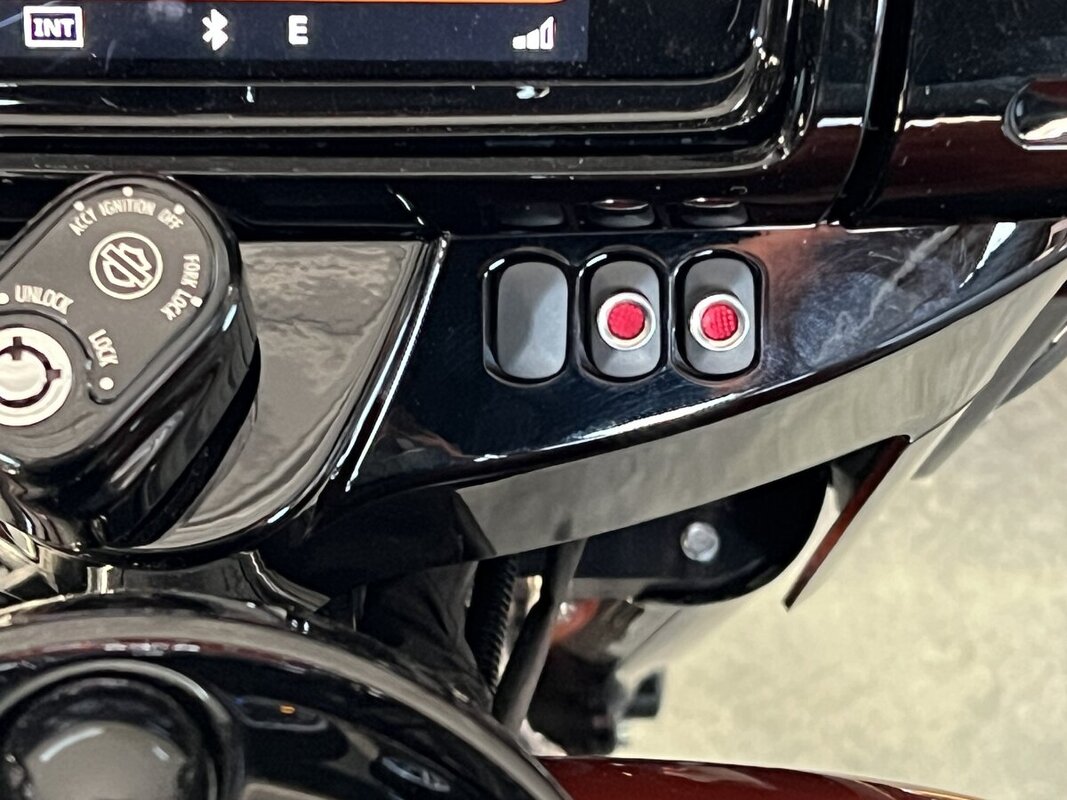

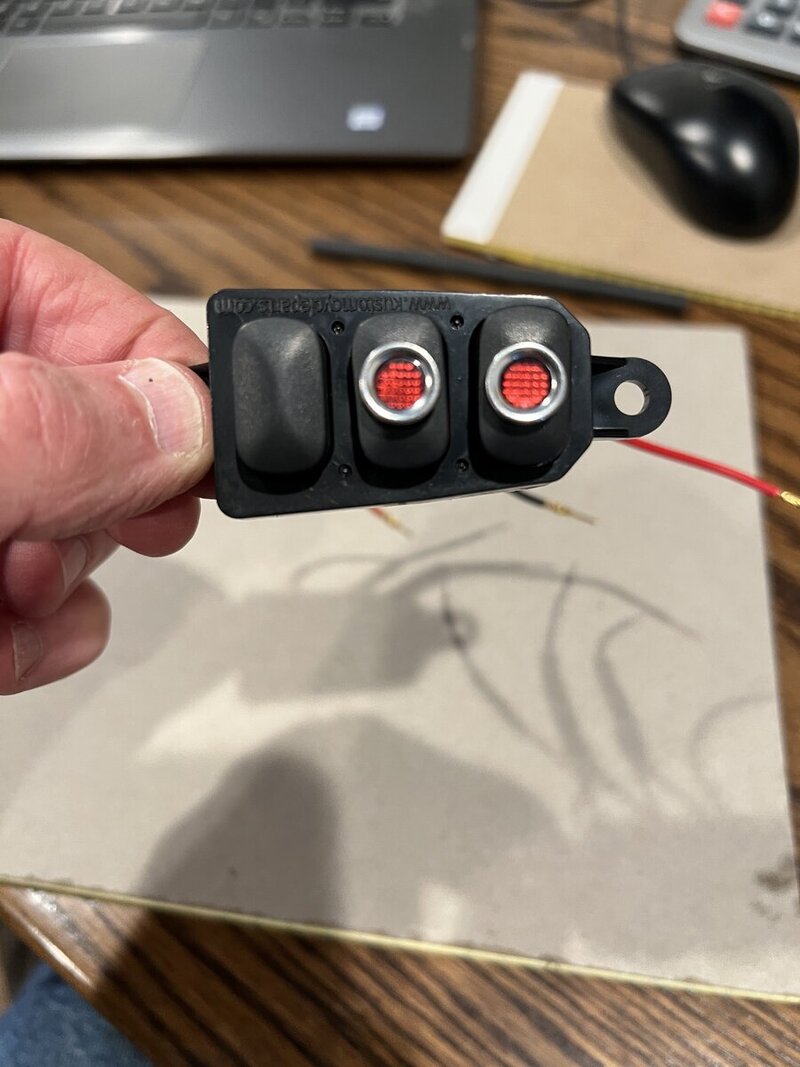

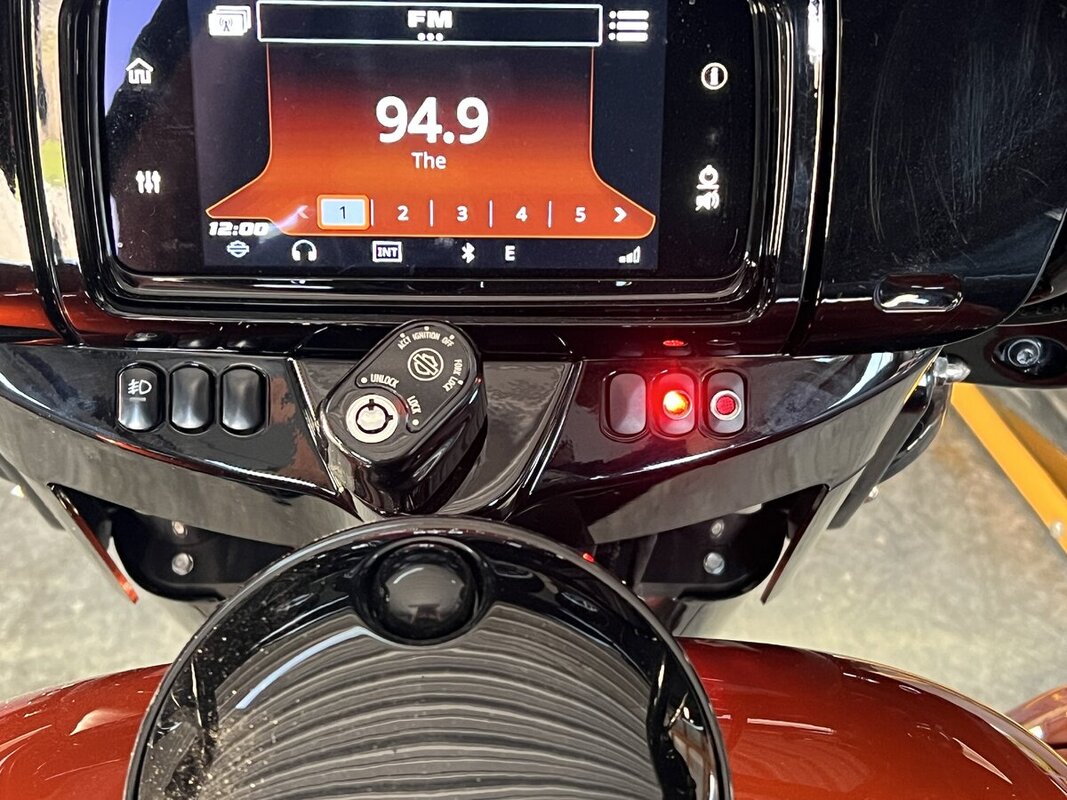

I spent some time modifying the switch I posted above from Kustom Cycle Parts. I ordered the single push button latching switch. I took it apart and swapped the switch position in the unit. I drilled holes in the other 2 blankouts and fitted the LED’s in them. Did some wiring on the backside, then pinned them out for a 4 pin Deutsch connector so I could take the bike apart in the future.
Here’s how I mounted the fuel transfer switch and 2 confirmation LED’s.IMG_1419.jpegIMG_1420.jpegIMG_1402.jpegIMG_1401.jpegIMG_1406.jpegIMG_1421.jpeg
