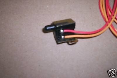

light swith.jpg This would be the switch inside the handle bars, am I guessing correctly that the hi amp switch could be directly wired only into the switch wires themselves?
I just tried to google a hi amp switch and didn't see what you might be talking about? do you have a link you could show this dummy?
View attachment 20895 This would be the switch inside the handle bars, am I guessing correctly that the hi amp switch could be directly wired only into the switch wires themselves?

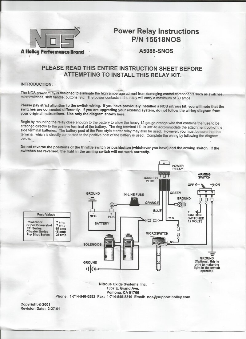

light swith.jpg Handle bar brake light switch
Scan.jpg Power relay switch (Click image to enlarge)
I would like your input please.
The orange fused wire goes to the battery?
The green wire is ground?
The red wire goes into which side of the above handlebar switch? hot side or the downstream side?
The blue wire will go Where? or is it necessary?
If the red wire goes down stream of the handlebar switch? why would I need the blue wire ?
This is what I see:
The red wire goes to the load side of the switch. It is what powers the relay. The blue wire is your new high amperage wire, which will go to your lights.
When you close the switch, the red wire turns the relay on, which closes the contacts, allowing your new source of power (orange wire) to go out on the blue wire to your load.

smiles%20slap%20head.gif Im still somewhat confused because I had not planned on including an arming switch.
I had planned to marry it directly into the brake light switch. Should do the same thing?
Maybe I need a diagram?:Shrug:
Same thing. Your original switch will have power on it already, the other side goes to the lights. Remove that wire, put the red one on your switch. Now the red one powers the relay instead of your lights. Then connect the blue wire to your lights. Away you go!
I agree with the previous poster (RcSuD - maybe sometimes you might share the origin of your user name?). Your handlebar switch has power in through the orange wire, and power out (to the brake lights) through the red wire. Find the red wire downstream from the handlebar switch and once you've selected a point in the wire where you want to tie in your relay, cut the red wire entirely. Now tie your handlebar switch's red wire to the red on your new relay. Tie the other end of the freshly cut wire (red) to the blue wire from the new relay. Send your high amp power (from the battery or similar hi-load source) to the orange input on your new relay. Ground the relay's green wire and you're done.
Red from handlebar switch --> red on relay
Red going to lights --> blue on relay
Battery or hi-amp power source --> orange on relay
Chassis ground the relay green wire
Relay box itslef does not need to be mounted in a grounded position, just somewhere to protect, even floating or attached to a wire bundle.
With that, when your handlebat switch closes, it sends +12v to the relay's low amperage coil. That coil, with +12v on one input and a grounded backend wire (Green) closes and joins orange (hi-amp +12v) to blue output now going to your lights. Instantaneous, quiet and usually good for a bike's lifetime.
Hope it all works as planned here, but again my recommendations are guaranteed or your money back!
