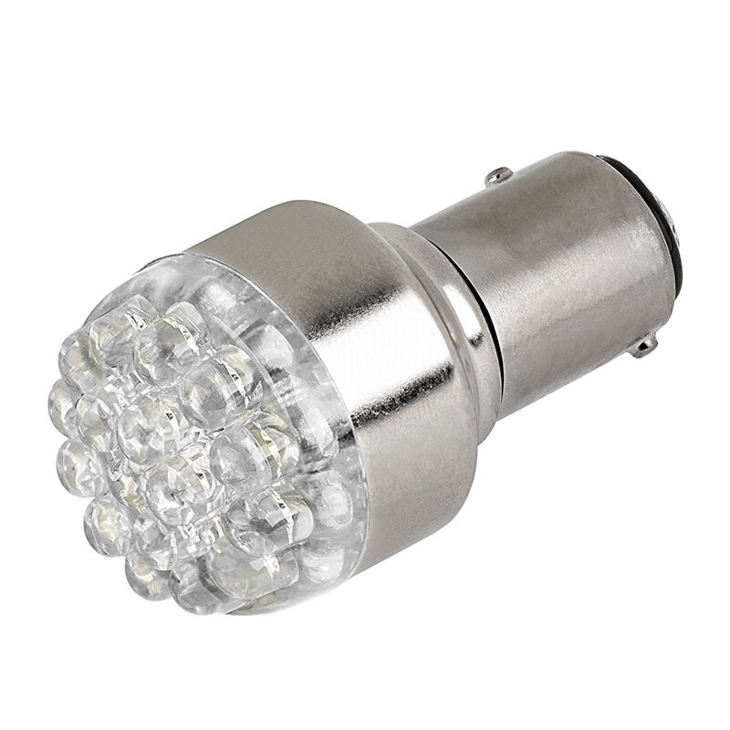

Thank you for the information, I am now planning on using ZEVO 1157 bulbs. Do I have to use a resistor with them? And are you saying you "Do Not" use s strobe controller on your bike?
Mike R
Available at most auto parts stores
Why can't you use LED replacements for the 1157 bulb ??
Lee, do you have a brand and part number for the bulb shown in your reply?
Thanks for your help,
Mike R
Lee,
I forgot to ask, will I need a resistor to use this bulb? If so can you recommend a source for it. You need to know your talking to a beginner with this task.
Thank you.
Mike R
This part is available at most auto parts stores. I used them in several bikes over the years. Replaces the standard 1157 bulb, no other mods needed, just plug and play.
