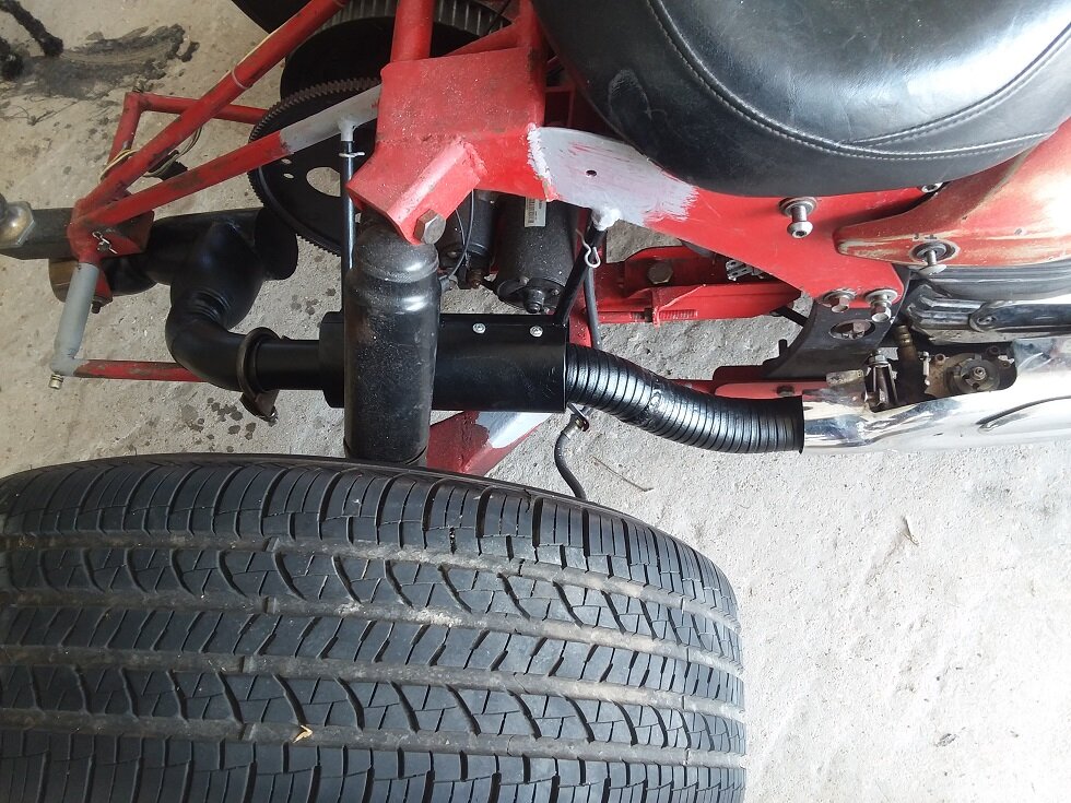

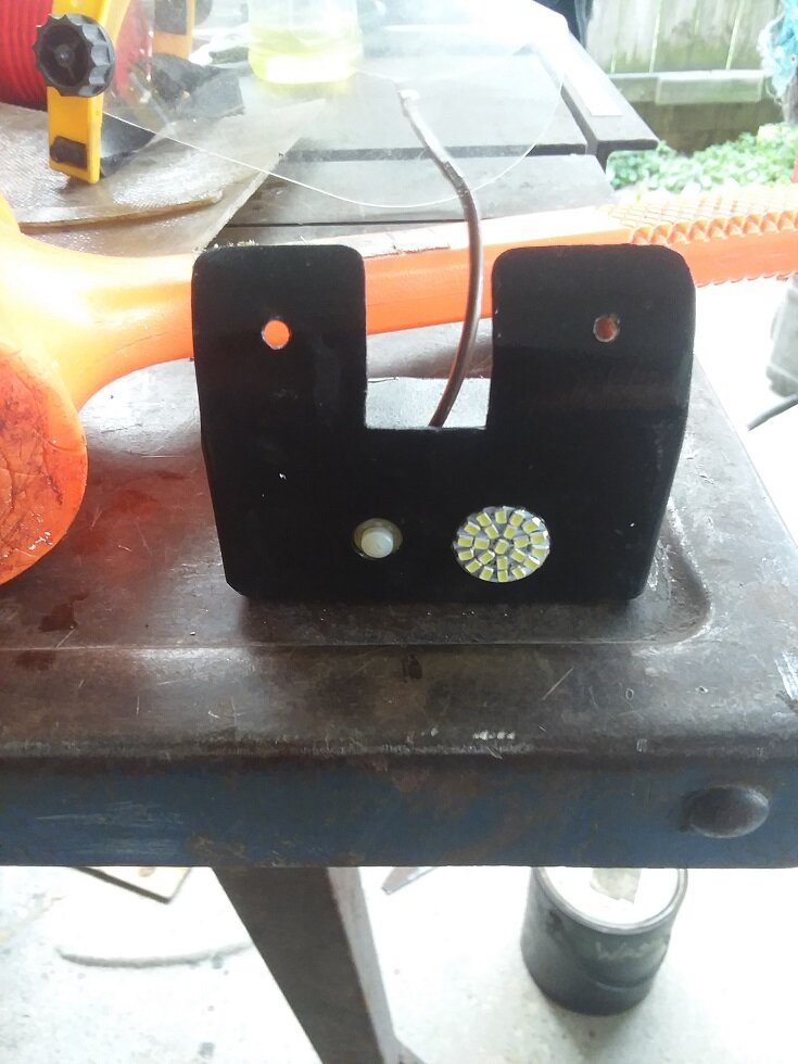

Finished the new exhaust. Took a Thrush Glass pack muffler, cut it in half, and welded the two pieces together with on at an angle to fit under the fiberglass body. The first "can" is a heat shield since the exhaust passes near the air shock line. Sandblasting and BBQ pit paint cleans it up. Sounds so much better now. The second picture is the switch to turn power on for the reverse. I put a brake/turn signal LED light on it to blind me while it's on. Pretty much won't forget to turn it off.

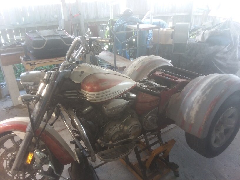

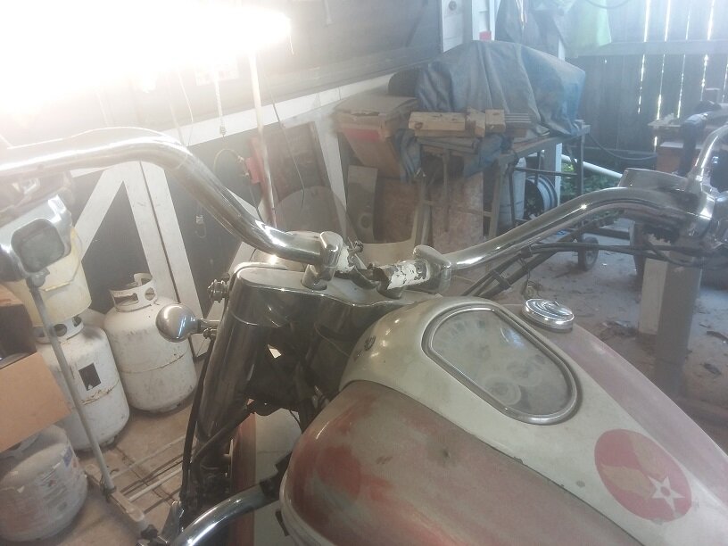

Our last ride to Arkansas we had to go through Lafayette, La TWICE. La Hwy 90 through that city is horrendous! Huge cracks in the pavement that WILL push/pull the bike side to side and the slabs drop at least one to two inches at every seam. While the Stratoliner remained mechanically sound, I can't say the same for the body. I had the trunk fiber-glassed to the body and that highway did a number on my back and cracked the body. On the return trip, I had to pull over in Lafayette to bungee cord the body together and hold the trunk on. Horrible, horrible, horrible, Dropped the speed down to 30 mph so I could physically keep riding while cars sped past us at 60+ mph. Not fun. Well now for today. Still have the issue with my wife's Roadstar starter/charging system which I'll work on tomorrow, but the Stratoliner is positioned for repairs. Pics and information will follow as I progress. Yes the handlebars I welded together some time back broke clean in two. Thankfully I was able to keep riding and get home. Ordered new ones today.
