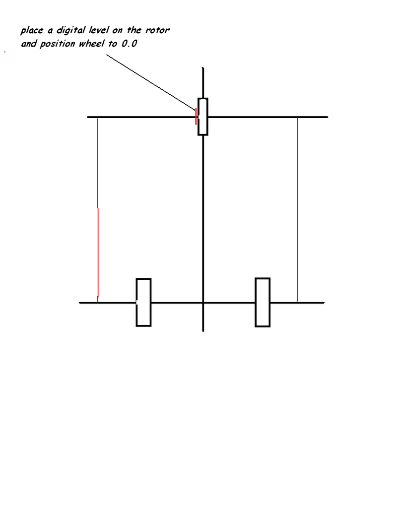

the wheel are not linning up even? the measurement are right , the trike was hit apperantly was told the trike was pushed but that was it? the right tire is ? it is foward about 2 1/4 inches the left is right on , thank you it just accured to me i might be looking at this in reverse? = I will let you know - wish i had a camera to show you? or to post? let see what happens? let you know tommorow;)
The rear might be out of alignment bit it sounds more like a body issue.
Check to see if the rear axle is centered with the front end first.
Jack each rear tire off ground, one at a time, and rotate. Not knowing if it was hit, maybe a bent axle or rear wheel. Front wheel could have been damaged if rear hit on one side only.
While measuring stuff, check rear tires / wheels for toe in / out condition (parallelism?).
Sounds like all three ain't pointing same direction at times, maybe in three directions?
Most side car rigs have either bikes rear tire or the side car's tire a bit forward or behind the other, but as long as they are generally parallel, the'le do OK.
