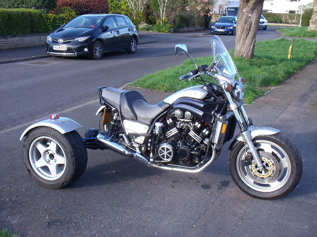

Trike: Yammy Vmax gen 1 with English axel (MK1 ford escort) soft tail rear end. YSS eco rr shocks (25/35 nm) set to minimal / zero sag without rider, rear tyres pressure 22psi front 42 psi (I tired all sorts for this & high is by far the best for steering & mitigating the below detailed head shake)
I know that the probable best cure for this sort of thing would be raked trees and I'm planning on that route eventually but for the mean time I'm looking for an easier/less expensive fix for the following problem.
This thing is super stable / rock solid at all speeds I've been brave enough to go at, inc. under the insane acceleration of V-boost, but I'm getting loads of nasty 'feedback' head shake induced by bumpy &/or potholed roads (& there are plenty around where I live), often causing my right hand to twitch the throttle which isn't good or at all pleasant.
I'm wondering if a steering damper might be the way to go? What say you?
