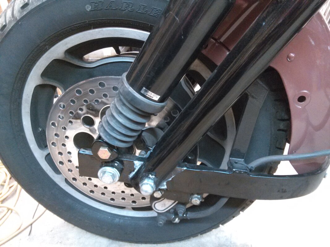

I just built a leading link and have 2 3/4 inch trail. new neck at i believe 38 degs. It is a lot easier than my old set up but still hard on my shoulders. I have no low speed wobble at all like i had before the winter make over . Just at speed the sharp turns on these NH roads require a lot of push pull:xzqxz: . 650lbs on front wheel, just hard on my shoulders. On the highways its a dream to drive

i would try making some longer "swing arms" to shorten the trail a little more, worth a try
is it much more than a couplr bars w 3 holes each??
Yea like a whole new lower swing arm, welding in brake caliper mounts , drilling and reaming holes for the pivot bushings. Drilling and reaming holes for axle, weld in new shock mounts . Lots going on in that small package lol. Hate to mess it up and not have it work. Maybe just make two arms with no brakes or fender mount just to try. Something crude but effective just to try

here is a side will get top later today

Its a solid grade 8 bolt i bought from mc master carr. I will check trail again when my help comes home. (wife). I have no wobble now at all and i can ride one hand but no way in hell can i turn at speed on back roads one hand.lol. All my history of this set up is posted here , hard for my ol mind to remember .
UPdate my trail is 2 1/4 to 2 1/2 so hard for me to be more accurate with all the crap on trike.
So your thinking i should move my axle toward front of swing arm to lower trail?

Ok, i think i know where im messing up on trail. With no load on trike my trail is around 2 1/2 now with my wife and i on trike the trail increases to three as the link is compressed upward and toward back and thereby increasing trail.. So maybe i do need to move axle 1 1/2 inch to front . Am i correct stacebg.. I could do that fairly easily like on your drawing

thats a lot of change... you might want to think about moving the pivot point back a ways too..(winter project).. not a big job,,, a couple dog legs at the bottom of the tubes and a longer swing arm.... your trail wont be affected as much, you will get more travel thus a better ride if it comes to a new swing arm i would opt for a pce of tube behind the tire rather than bare..stac
