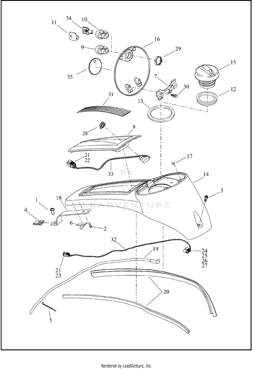

Remove your seat and locate the( evap line#19)coming from your gas tank, see if the line is kinked anywhere, you can also disconnect it where it runs down the backbone, connect another piece of hose to it and see if you can blow thru it
