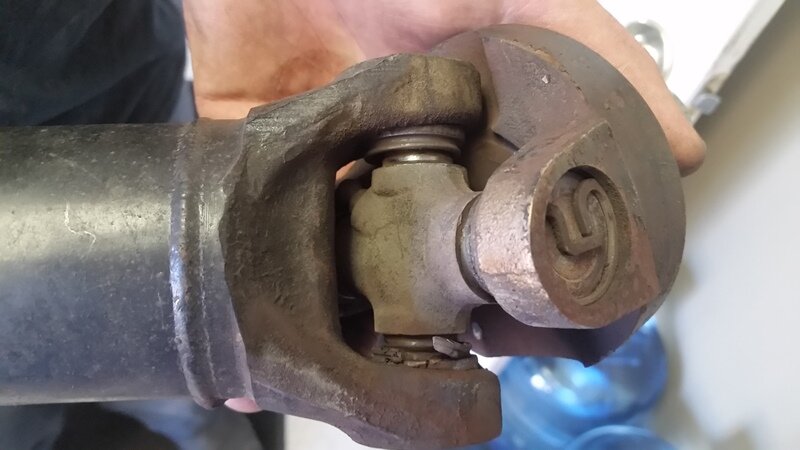

I was coming home from a rally traveling 75-80 mph. I started to feel a vibration thru the gas pedal and when I slowed down to stop for gas I could then hear the screeching sound. I limped it home and all fixed today. Easy to unbolt the u joints. It a ordinary joint so easy to find.
The real issue is trying to get grease in the joint. Very hard to get onto the fitting if you even due.

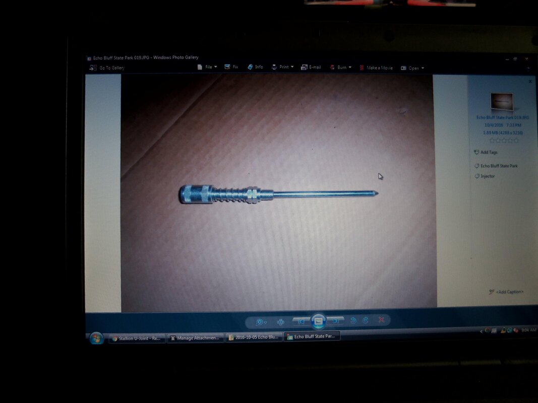

It appears a needle nozzle is needed:
I have lubed mine twice in 56K. I put the bike on ramps, then jack one wheel clear so that I can rotate it and get a clear shot on each fitting. I have one of those injectors, but I was able to get on it with a standard grease fitting. I use the Ford long life grease.
Greased the U-Joint with the injector and it worked great. I wish everything worked that easy.ThumbUp
Ed can you please post a picture of the "injector" that you used. I've yet to find one to work for me.
Ted, I got the injector at O'Reilly and the item number is PFM W54216 and it cost $7.99 I'm trying to send a picture but for some reason I've not been able to get it to download (to big).Injector 1 001.jpg
