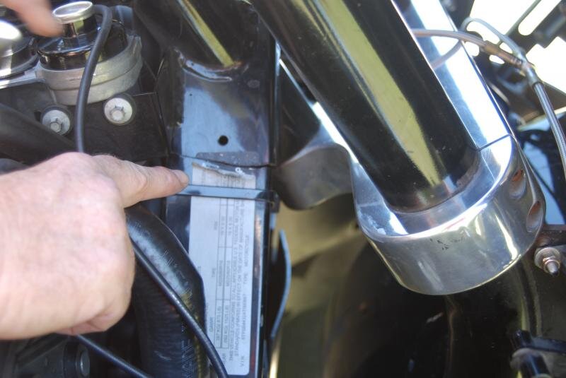

Anyone out there with a stallion that has this problem, check your Stallion closely...
about April of this year i was having an issue of my front light assy. resting on my front tire when the hood was opened...
also there was a pulling to the left when the brakes were applied...this all happened when we were on the interstate cruising...
i called TBMS and asked them about this being a big problem, and how to fix this....i know that my warranty ran out in Sept. last year.....they got back with me, Richard told me that they haven't had no frame issues at all...but he said if i get the Stallion to them in Texas they would look at it...with some negotiations i was to take it 3 hours into Georgia, and the would pick it up there and repair it and have it ready for Pick up in July...got it back...rides good...and they did it for free...wonder why?
TBMS stands behind their product...????
if your light assy. is resting on your tire? get your frame checked out.....

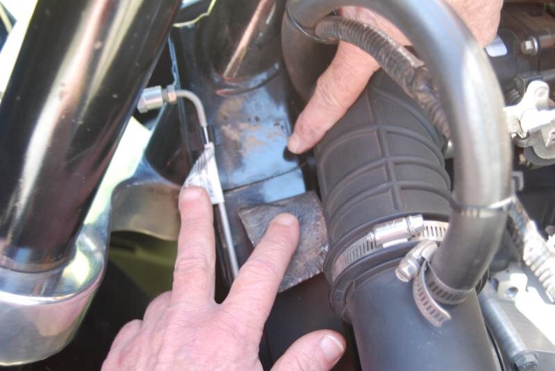

Guys fyi....when i stated that the light housing would rest on the tire....i meant that the weight of the hood would set on top of the tire when the hood was lifted...and the trike started to pull to the left after the frame broke.....and no...it was not the ladder bar that broke....the frame is on front the square looking tubes...

AND YES, THEY FIXED THE FRAME BY REPLACING IT...GOT IT BACK ON THE TIME THEY SAID, CAN'T HOLD THAT AGAINST THEM....
