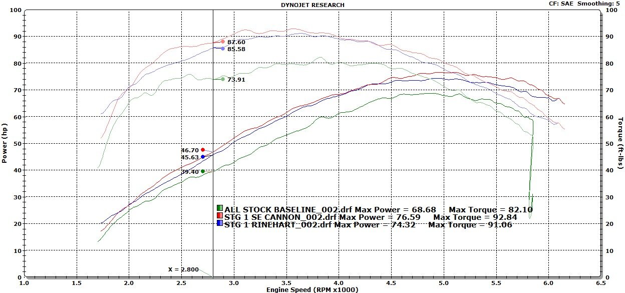

For comparison here is a sheet showing air cleaner and exhaust changes.
These dyno sheets come from Harley Davidson of Salt Lake City http://www.utahharleytech.com/?cat=12

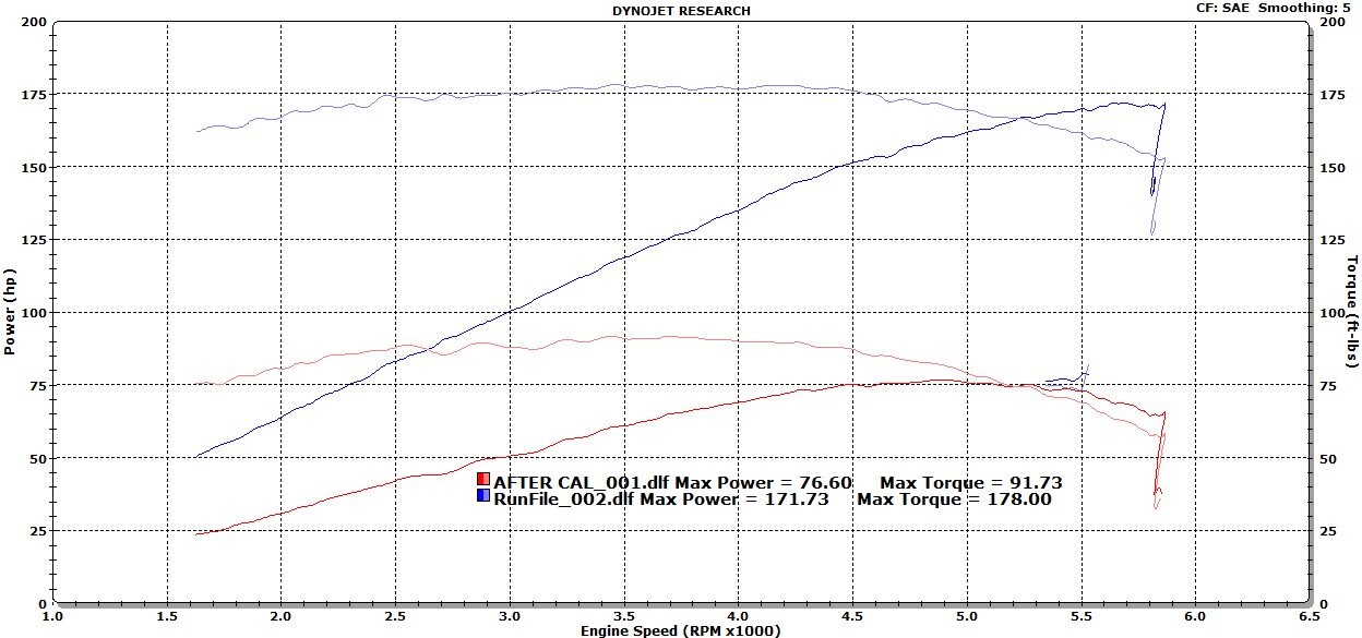

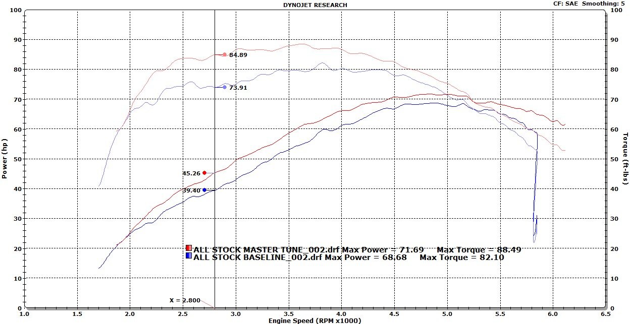

One thing I will say about dyno charts, they are not the end all be all when it comes to comparing parts. You have to take them with a grain of salt, a dyno can be manipulated to read way more power and torque than actually produced. This chart is also from the Salt Lake City Harley, it shows how you can make a stock 2014 look like a world beater. They manipulated the dyno settings to make it look like they produced way more power than it actually produced. If it looks to good to be true, more often than not it was fiddled to look good. When I'm looking at performance gains from a specific part, I try and find independent dyno charts from more than one source if possible.
9 lbs of tq with 5 hp increase is a pretty good increase for a trike.

Your right it is a nice little increase, but you need to also do the exhaust and tune it properly to obtain those results. On a trike the hp and torque readings will be lower due to the trike having more rotating mass than a 2 wheel motorcycle.

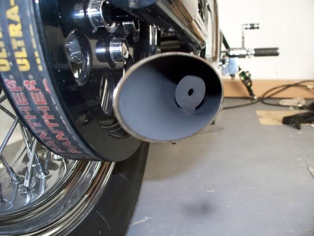

The larger the baffle the higher it will shift the torque in the RPM range thus making it feel like you lost power. The power is there, just not in the area you ride in.

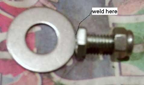

FWIW you could have rolled your own lollipops for the exhaust, guys have been doing it for years to help drag pipes make some bottom end on the street.

Of course if you don't have a tuneable disc muffler, you only have baffle size, baffle design, or placing some other sort of restriction in the muffler to modify how the sound waves move through the exhaust system when just replacing mufflers. This is why placing a lollipop at the outlet of the muffler can help shift the torque to the left. If you get into complete exhaust systems it gets even more interesting. With a exhaust header you can use length, type of bends and stepping to tune how the sound waves react.
