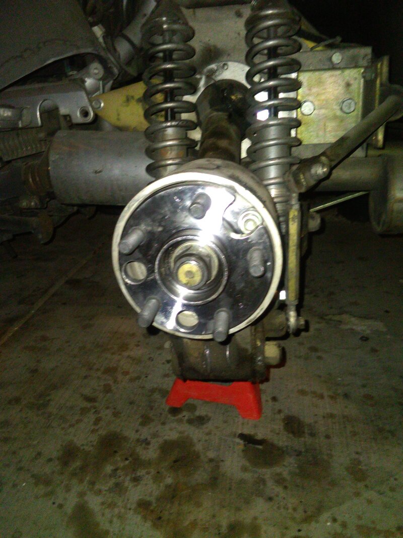

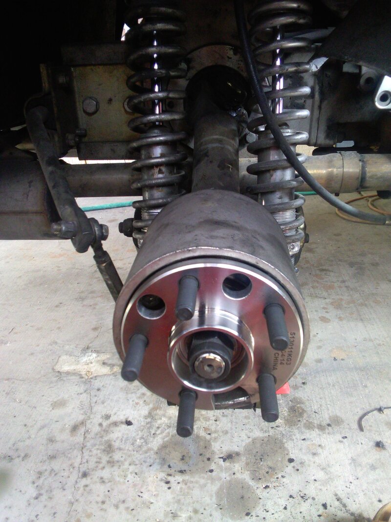

Im sorry I did not address the nut side of the axle, yes there is a thick thrust washer on the outside with the axle nut.
the washer on the back side is a thin washer. I assume It protects the bearing from the axle being directly in contact with the bearing.
The right side is done ready for tire install. then road.
yup I admit it, thats a stamp on the face and it says made in china. I got them on amazon for $30 each, I just could not afford $60 to $80 each, with the extra costs involved in my new front end I just could not do it. sorry:cxtv:

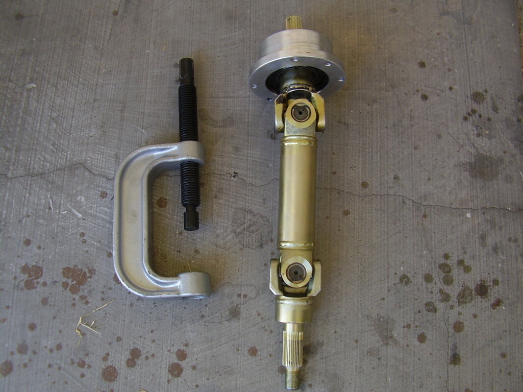

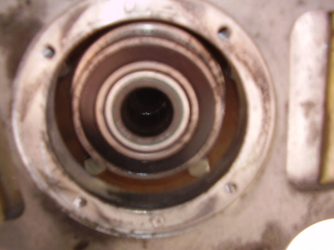

I found some old pics from when I replaced the half shaft, I found those 3 other bearings. 2 on the left and 1 on the right. on the right there would be one on the shaft only. as you can see on the left side there is 1 on the shaft and one on the differential.
