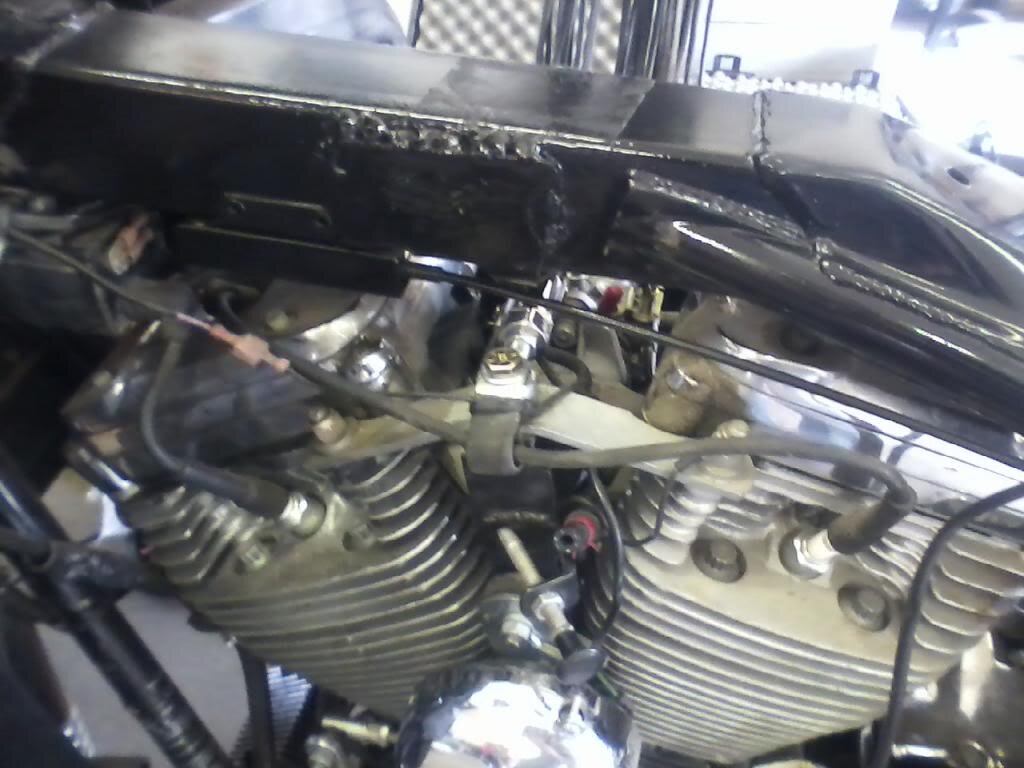

If this were an old Harley I would suggest checking the top engine mount bracket. It wouldn't hurt checking yours anyway as I don't know how yours is set up?
My old Harley as with any converted bike was never intended to be a trike. take off and acceleration will cause the engine to try to twist in the frame, ( especially with a rubber mounted engine.) so my old scoot required a beefed up top engine mounting bracket.
(champion provided it with the kit I bought.)
It comes with epoxy to mount the brackets to the main frame using your current brackets, I welded mine, The stiffener is much heavier
top mounting bracket and adjustable stiffener
Check for missing bolts and check the torque from time to time, Lock tight is a premier idea.
The newer Harleys already had a heavier mounting bracket and didn't need a different one.
One of the sure signs is having a horn honk for no good reason, and noise and vibration. believe me it's not the horn, It's the bracket?
Keep riding that way and the problem will become very obvious in a hell of a hurry.

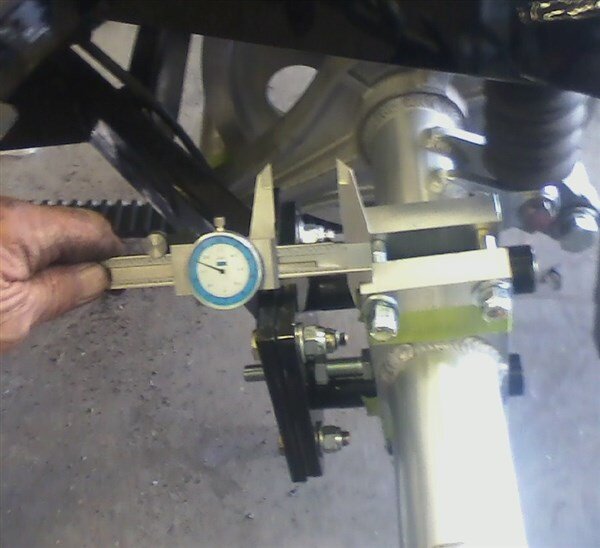

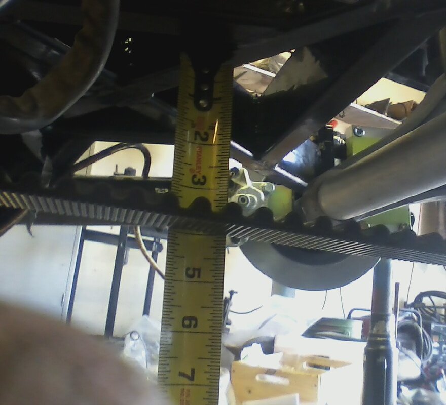

Checking belt tension
checking axle alignment
d-8-usingadialcalipertoadjustalighnmentonaxleanddrivepulleys_zpsfd2f8067 (600 x 548) (2).jpg
