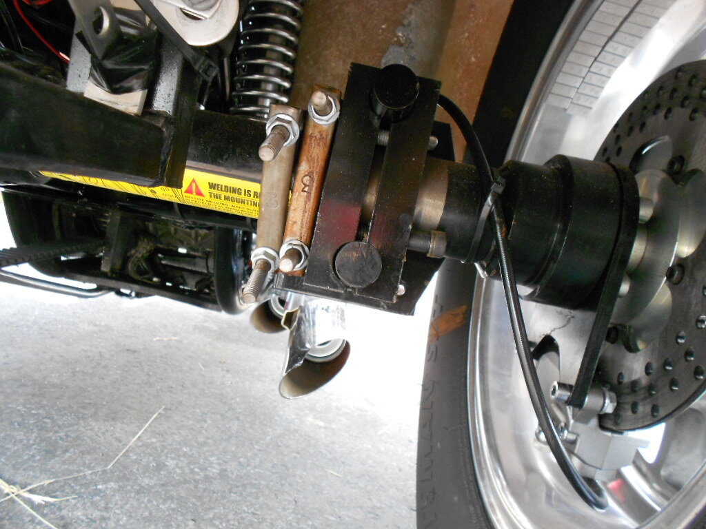

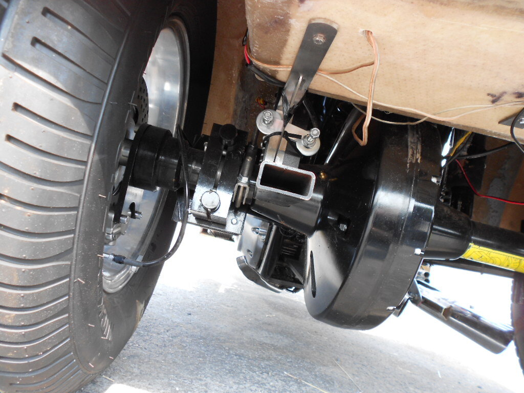

Thinking about a DNA axel and swingarm on a Softail
DNA rear axle and swingarm huh......
I would take the swingarm and study it so that I could re-enforce it where the shocks mount.
That shock bracket should have more bracing IMHO.
Don't be in a hurry, I had a local build a DNA trike with a 1993 FXLR and I wake up at night sometimes screaming.
He had been working on it for 6 months and I flat refused to straighten it out for him.
