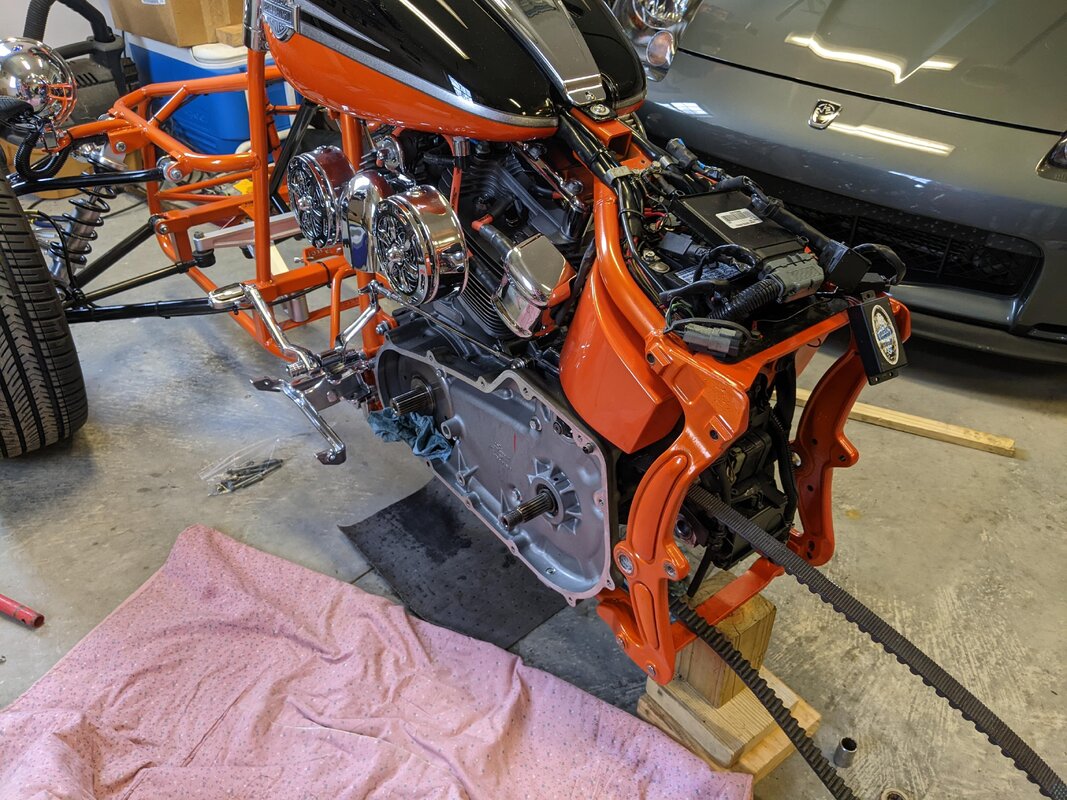

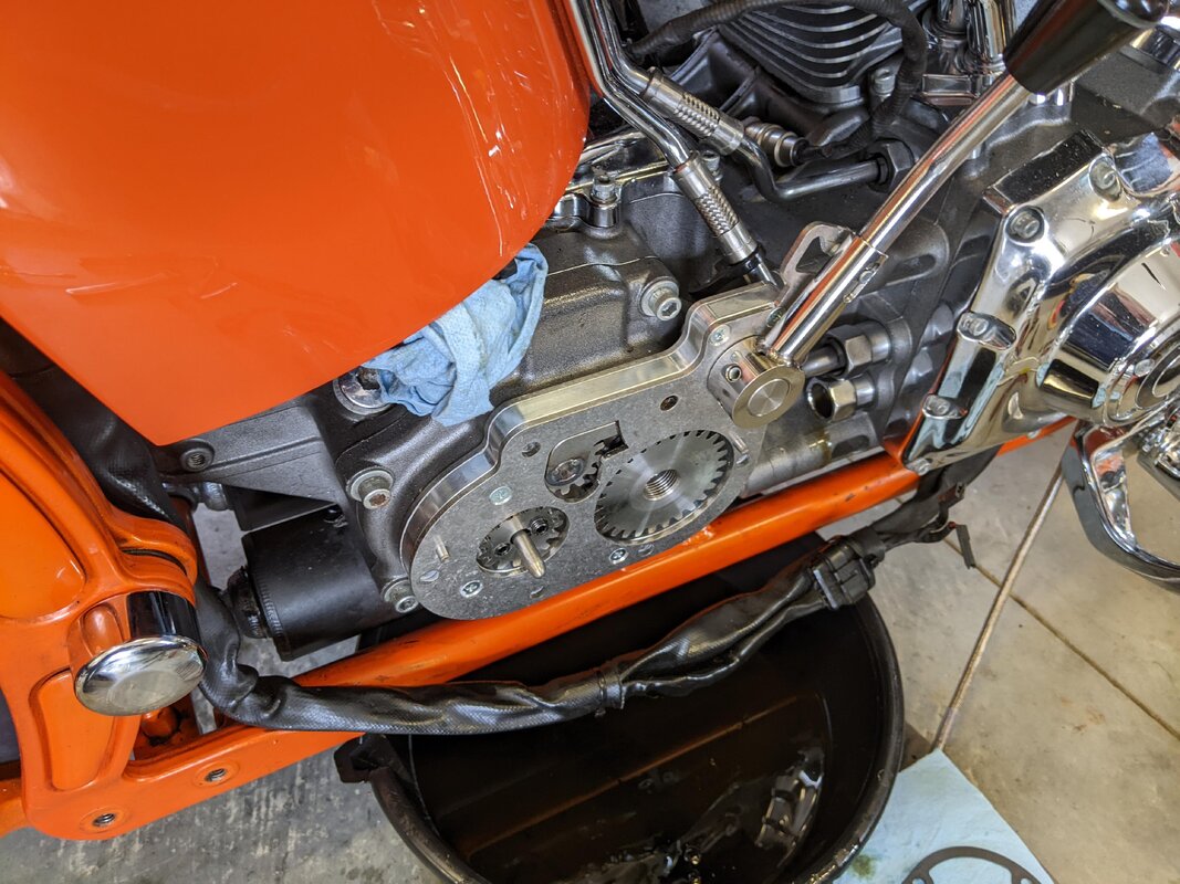

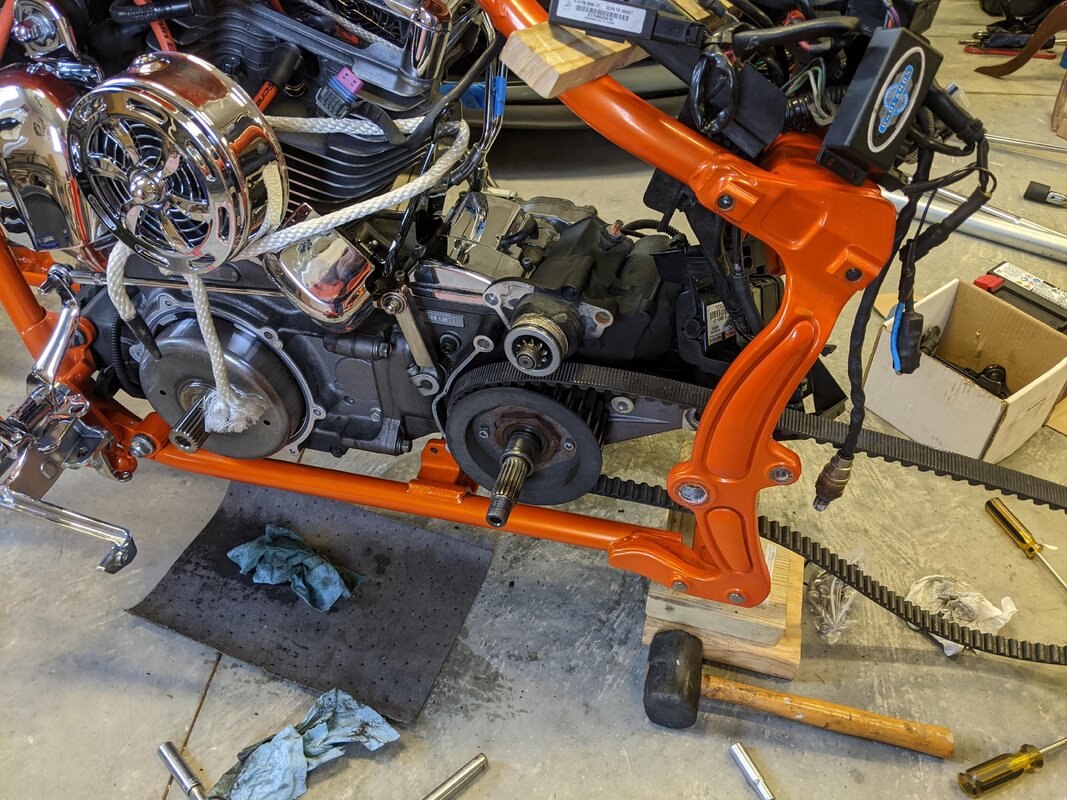

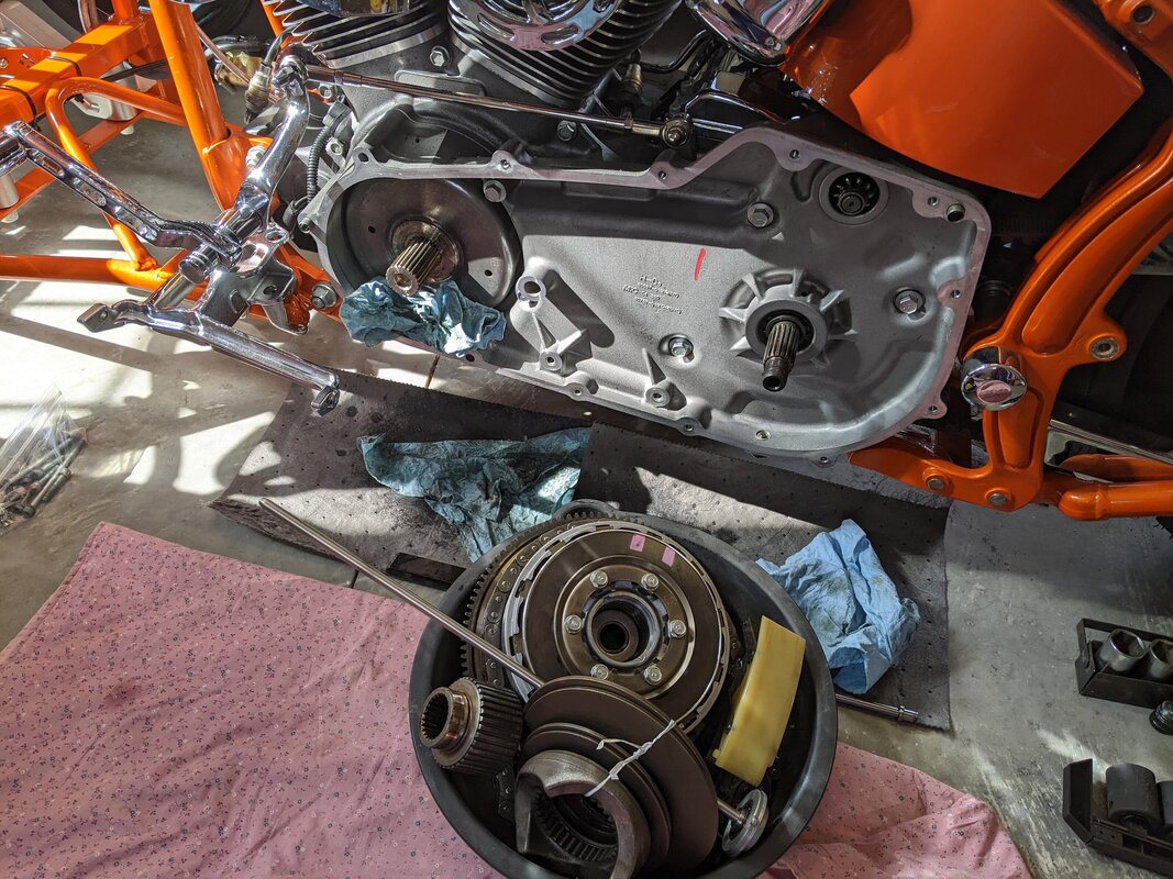

Major operation today; removed the rear end and installed a different drive belt for the rear kit. If you've never done a drive belt on a Harley, know this; everything has to come off the bike; the rear wheel, the oil tank, the primary drive and inner case.
OK, the swing arm didn't need to come off to change the belt; but it does come off for the rear kit.

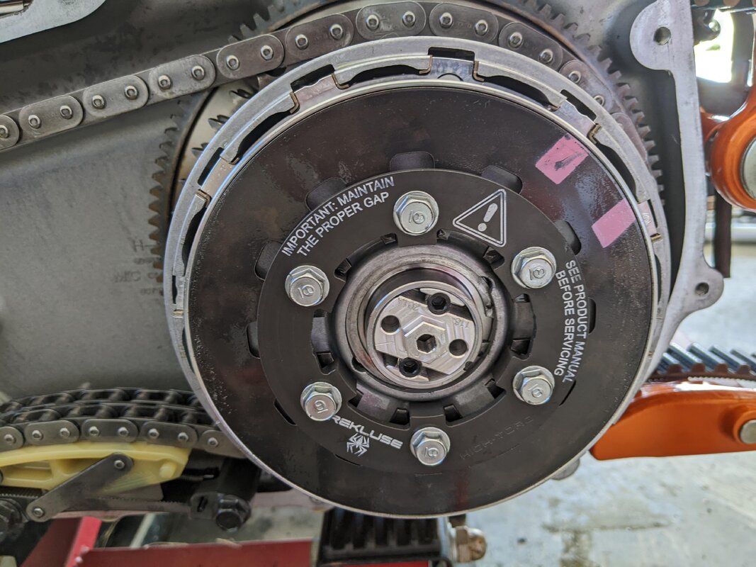

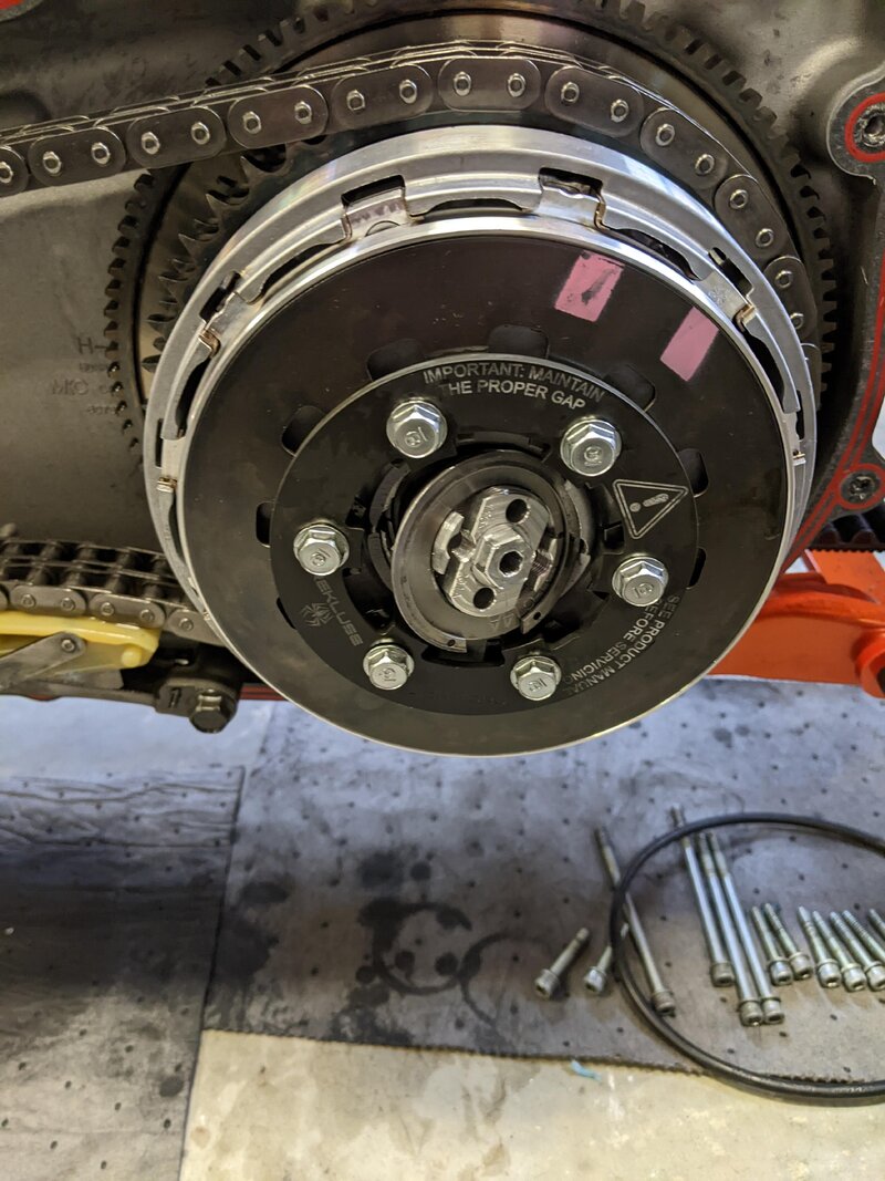

Clutch was rebuilt with a Rekluse kit. Had some issues with the installation manual here too because the page with the disk setup (stack) was missing. YouTube didn't help. Finally found a complete Installation Guide at the Rekluse web site.
I'm doing this auto clutch with a hydraulic throw-out and a Champion mechanical reverse; I hope it all works together!!

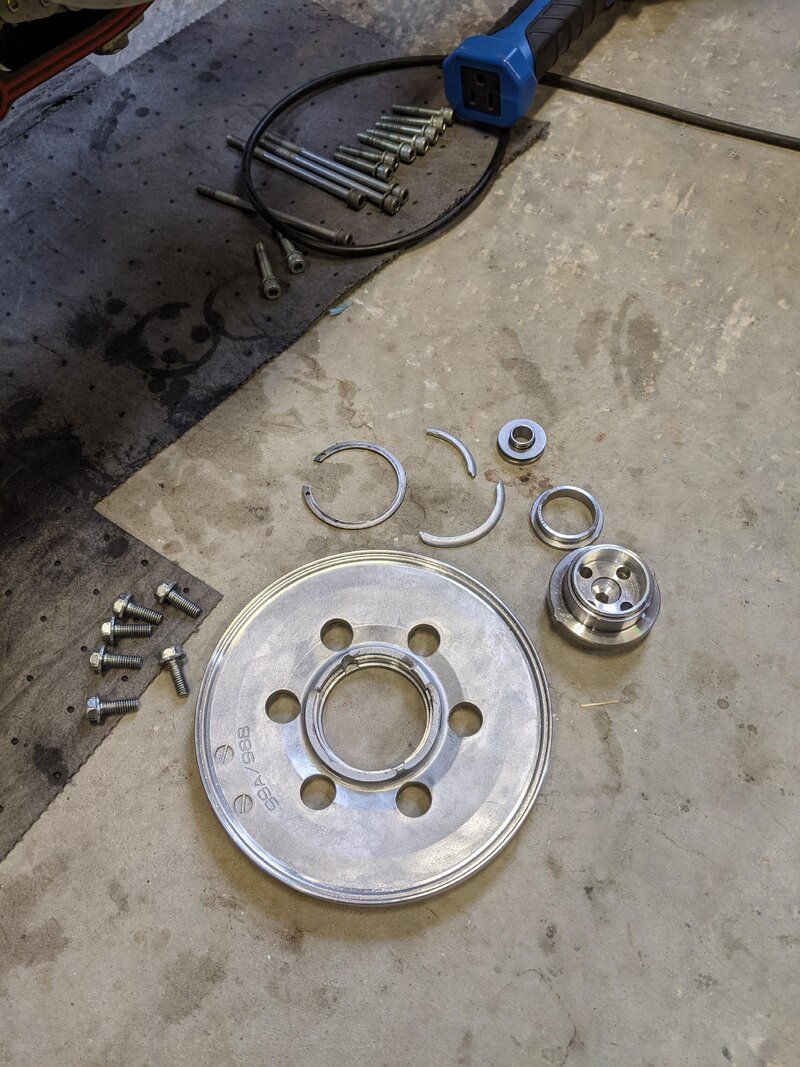

Main reason I haven't posted lately is because nothing's changed that much visually. I'm expecting the painted cowlings to be done next week, provided there are no unforeseen delays. I've also been struggling with a couple problems. First, the snap ring holding the adjuster assembly in the clutch popped out while I was bleeding the hydraulic actuator. The adjuster assembly replaces the OE throw-out bearing in the pressure plate. Then when I put it all back together, somehow I got part of the adjuster backwards and I actually broke the pressure plate trying to force it together. After getting a new pressure plate, it took several days of putting it together and taking it apart before I figured out what I'd done wrong.

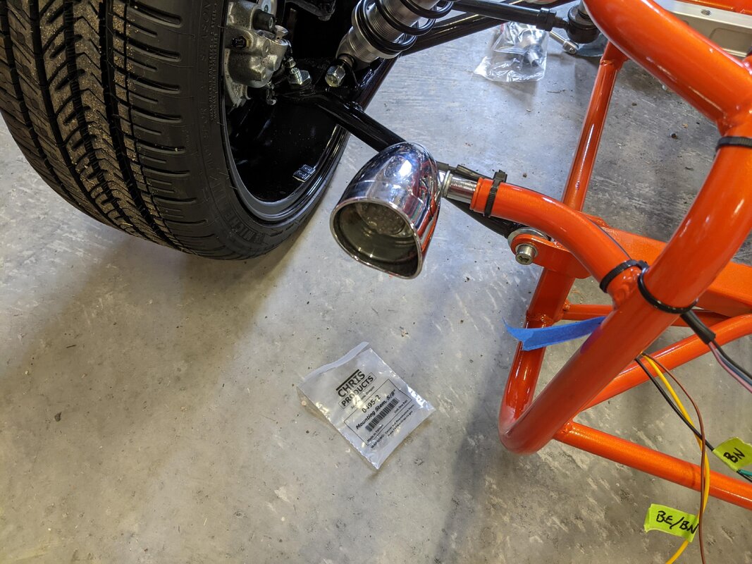

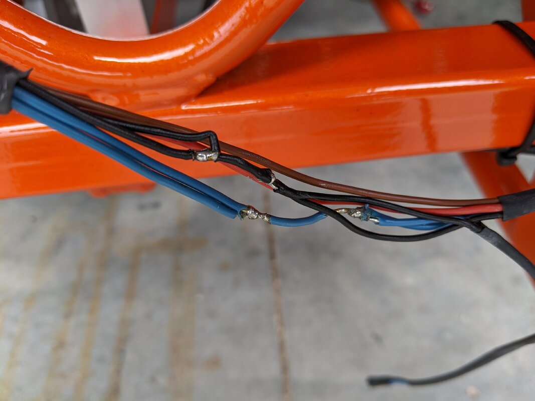

Next, I've been struggling with some electrical problems. Fuses blowing and turn signals not working. I thought it was my wiring job, but traced the problem in the rear wiring to the harness supplied with the kit. Whoever built the harness soldered wires together, but didn't use any shrink wrap to keep the connections apart. That won't work! A little insulation added between the black-ground and the blue-power wires. Rear has continuity now to running lights, brake lights, and turn signals; but It's still blowing the Ignition fuse as soon as I turn on the switch. tearing into the front harness now. Picture is the rear:

Lucky it seems that you have the knowledge To work through all this bullshit , How could they leave the wires like that ? crazy , Looks great Good Luck
Wow, that wiring was a hot mess
I would have fired a guy working for me like that

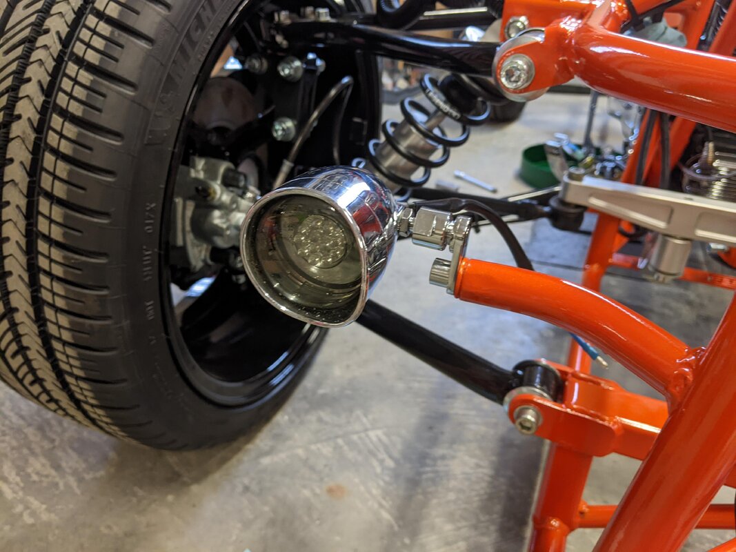

Couple days ago, I started looking at how the fenders mount. The struts bolt onto the steering knuckle/spindle in front and the wheel hub/spindle in the rear; and then glue to the fenders. The Dealer Manual (Installation Instructions) say, "Line the fender struts in line with the wheels with a minimum gap of 5 mm, this is for a better fitment of the fender." That's all you get for instructions; oh, and there's a couple pictures that show the installed struts wrapping around the side of the tire, with the suggested minimum gap (I guess?). Looking at the struts, they are different front [tire] and rear [tire]; but which is which? My brain said the rear fenders are bigger, so the bigger struts must go on the rear. Fail. Clue, if the wheels and tires won't go back on due to lack of clearance, then you've probably installed the struts wrong; disassemble and try again. Second try was a charm. Even installed in the correct positions, the struts require some serious tweaking to align the fenders close to centered on the tires. By tweaking, I mean get a long 2x4 or another type of pry bar and put some ass into it. The struts have to be bent into the best possible position. This picture is as installed, crooked as heck, rubbing on tire at rear, before prying:

With the fenders mounted, I found the headlights made contact with the front fenders when the wheel is turned (fenders turn with the wheels). I raised the headlights some, but it's not enough. I think I'll need to go up another inch or move them inboard a bit. Another problem to solve...

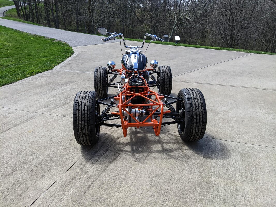

Road Warrior Wanabe
Test rode the quad bike on the street for the first time today. Speed limit for my road is 55 mph and the road is uneven and curvy; my first outing I got up to 35 mph. I felt like it was trying to throw me off, but I suspect some of that feeling is normal coming from 2 wheels and not knowing how much side-to-side rocking to expect. However, the steering was uncomfortably twitchy at this point. I brought it back home to do a little work on the wheel alignment. Up until now, I'd only eyeballed the toe-in. So, I did the next best thing, string and level. String for the toe-in and level for camber. Not sure how to adjust the caster on this thing yet. Front toe is set close to 1/8" in now and rear is close to zero. Took it back out and braved 50 mph. It still needs a professional alignment, if I can find a shop willing to do it. Otherwise, I will need to buy some more sophisticated equipment. 50 mph is work right now, 75 mph is unimaginable.
