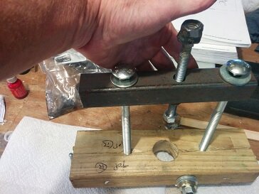

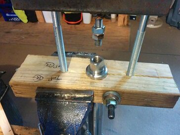

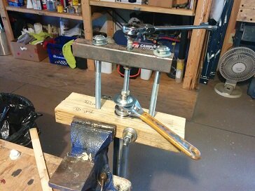

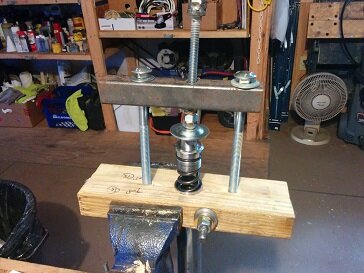

What I finally wound up doing was just getting rid of the old oil (pretty gross) cleaning the insides real good, and putting in a good quality 30w fork oil. bike now rides like a champ!!!
The hardest part to putting the tubes back together again was figuring out how to, as the manual puts it, "install springs." Yeah..right!!! Ever try to push them muthas down right after having a hernia operation? Yeah there are (expensive) tools you can purchase to do that but I was ready to get the bike back on the road...NOW... so I looked around the shop for materials and figured out a "press" system that would hold the tubes in the vice, without marring them, and then press the springs in. The attached photos should tell the story about how to be cheap AND productive... LOL!!! the tool ain't pretty but I had all the materials and, better yet, it works! Feel free to copy it!
The hole is drilled into a 2x4 smaller diameter than the fork then cut the 2x4 in half lengthways. The vise applies pressure to one side and the bolt applies pressure to the other side. Put the cap on top of the spring and a large washer on top of the cap (I used an indented washer from an old grinder to keep the cap from slipping out) and screw it down. Once it bottoms out use a wrench to slowly turn in the cap until done.
