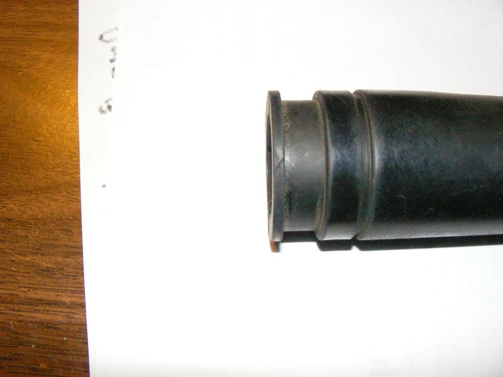

There is a second screw on the bottom, but I was looking in the wrong place. I was looking at the bottom of the reverse switch housing, and the screw was on the bottom of the horn/headlight switch housing. I was able to loosen the housing for the horn switch, and twist the grip out. There is a flange, that sits in a groove in the housing.
I cleaned the bar and the inside of the grip with 400 grit sandpaper, then spread some 2 part epoxy (because I had it here, and would have had to go buy hair spray). Twisted the grip into place, wiping off the excess before it got all the way up to the housing. Slipped the flange into the groove, and screwed the housing back down. Let it sit for a couple hours, and it is just fine.
Here is a pic of the end of the grip, showing the flange.
