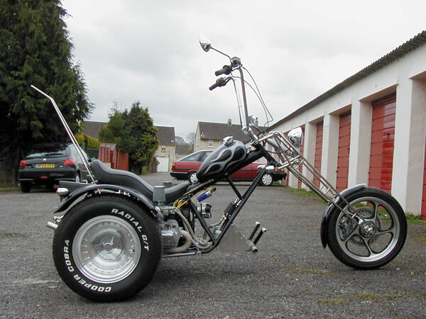

You can check my album for several shots of the NovaTrike style. It was initially designed to be very close to the dimensions of a touring Harley. Everything is weight balanced by design to target 100 pounds minimum on the front wheel dry and empty. By the time a driver is seated there is no tendency to bring the front wheel up with normal, or even moderately aggressive driving. Of course if you open the throttle and drop the clutch you get a similar reaction as a two wheel ride.
We put several hundred of these on the road and only ever had one complaint about it doing unexpected wheelies. When I personally drove 200 miles one way to talk to that customer face to face, he informed me that his trike was haunted and had once taken off all by itself and drove him into a ditch. In the interest of keeping customer satisfaction, I had had his damages repaired with no charge to him, and told him we had an exorcism to rid his trike of goblins and spirits. I personally think that too much spirits on his part caused a lot of the problems!;)

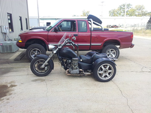

My wheelbase is 6 feet. Add to that the normal engine/exhaust/trailer hitch out back, and it's still pretty short. Handles great. Wheelies only when I want it to. The front frame is made of 3" 3/8" wall steel. Battery is also up front. I pull a trailer that puts about 40-60 lbs tongue weight on the back, and I t still doesn't come off the ground very easily, even with a healthy 1915 out back.
that is what i had in mind ! like the look. BJ
