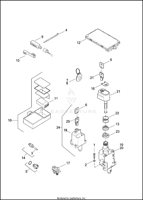

Ok. 2015 Freewheeler. The security system was working and now it is not. We can still start it with no FOB present. The red security light does not flash at all and there is a new battery in the FOB. What are some of the common things to look at? Thanks in advance.
Have you recently replaced the Trike battery?
Under the seat and on the left side near the battery is the Antenna for the security system
If bumped, moved or not fully plugged in it can cause some these symptoms
Have a look @ # 9 here
