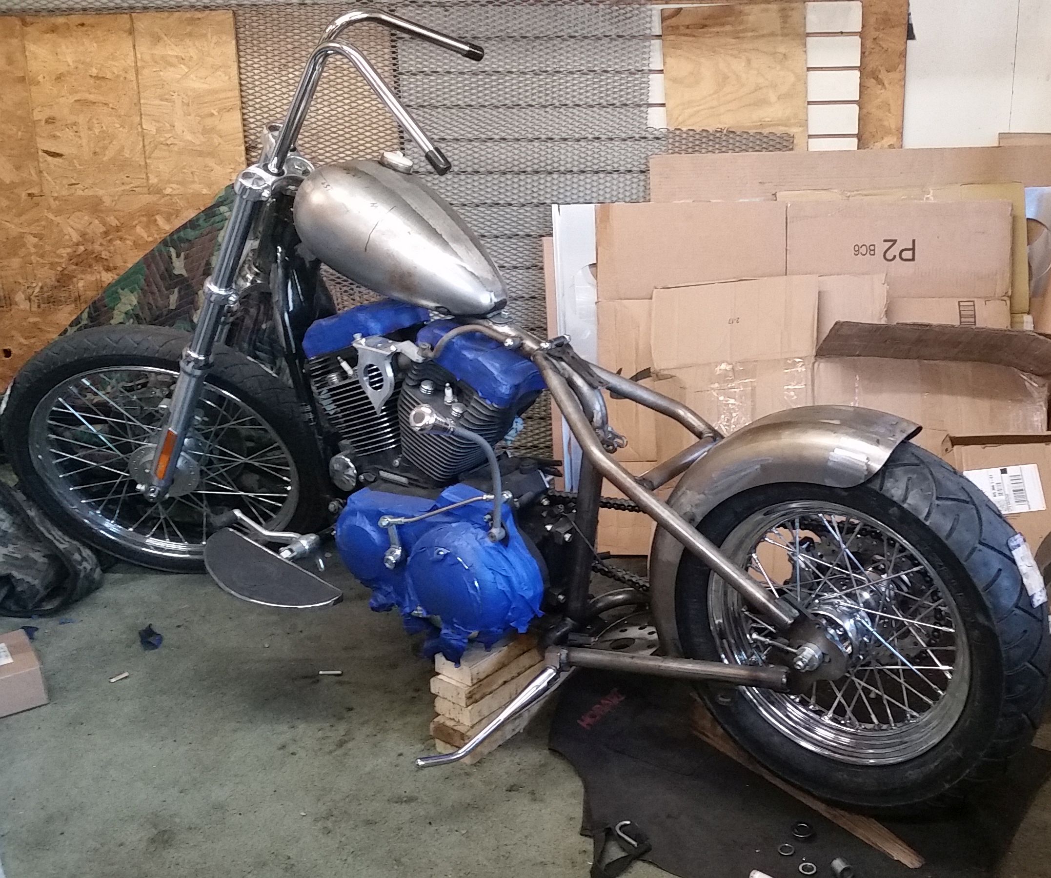

Wow! It has been a long time since we were able to work on the bike...like 3 months!
Today Devin and I penciled in some time in our schedule to work on it this coming Friday afternoon!
I did a bit on it today too.
First I had to get all the stuff that had piled up around it moved out of the way...
...there it is, just like I left it months ago.
The only thing I did today was pull the 2" fork extensions off....
...and replace them with 1" extensions.
Slide the tubes back into place...
...and it is ready for us to get some progress made on it this Friday afternoon.

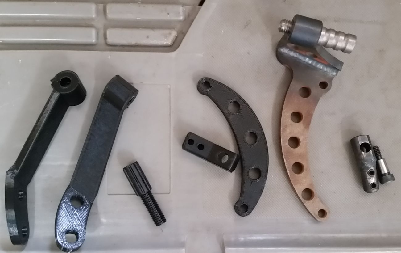

This is a suicide (foot) clutch set up that we bought, thinking we would use it.
It's just too fugly. The principle is solid, cable goes from the primary to the bracket pictured above...then between that and the attachment made to the Shifter arm (which will now be the clutch pedal).
We had designed our own from scratch a few months ago...it got way to complicated with cams, etc.
So we are going to take this simple design and clean it up a bit, make it more stealth/streamline.
We'll be making it in the plastic printer first, then once we have it how we want it, we'll laser cut the metal.

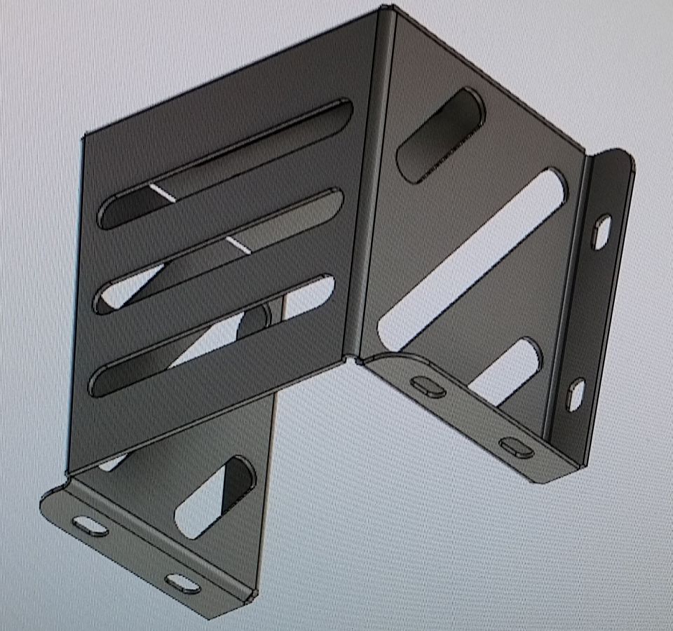

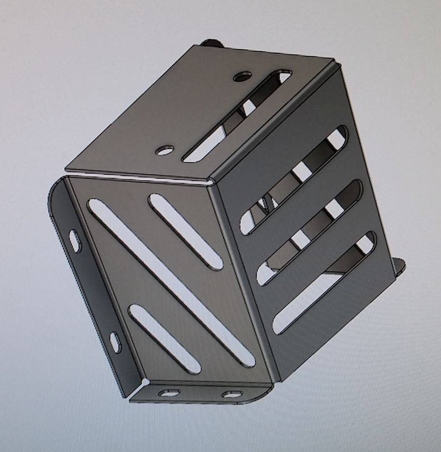

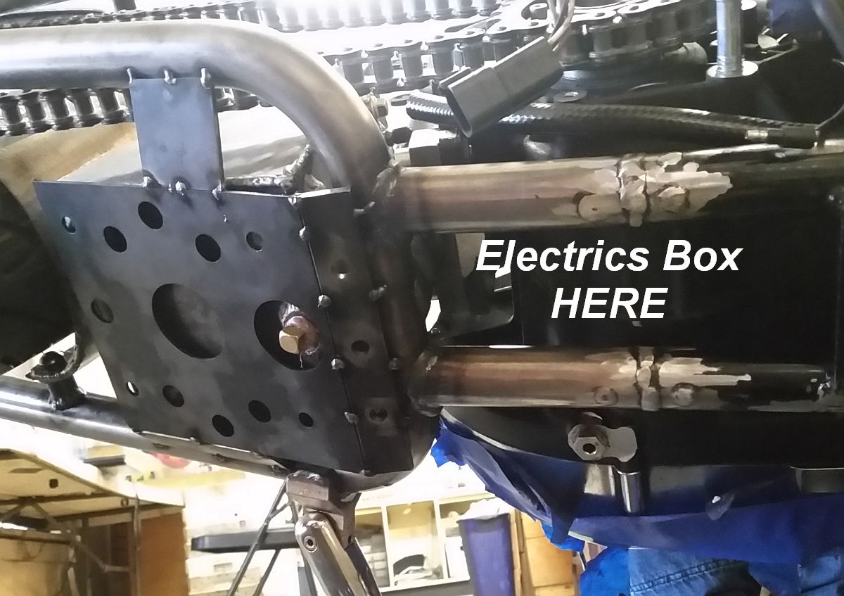

The turn signal switches, horn and ignition buttons are going to be built into the bottom of the frame, indicated in the photo above.
We are going to cut a rectangle out of the bottom, build a little box, 4" x 7/8", weld that box into the frame. There will be a cap that screws into the box, and that cap will have the switches built into it.
It will not be visible unless eye level gets lower than that part of the frame.
The wires will run down the backbone tube (that the rear of the engine is mounted to) and come out near the bottom, which is where we will be putting a small hidden electrics box.
There will be a fuse, a relay and the run-brake-turn controller in that box.

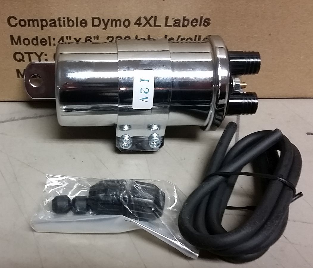

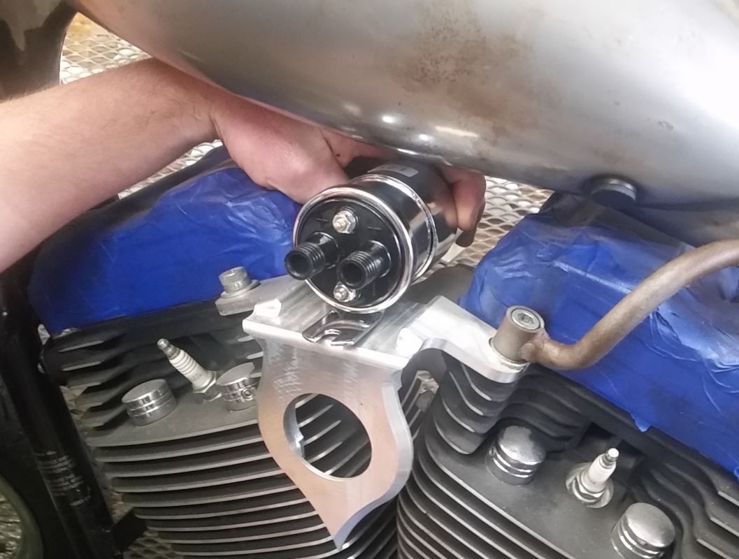

There will be a kill switch right behind the coil...not visible.

We also tested out the plastic printed Prototype for the foot clutch.
Here's a photo of the metal clunky parts, along side the plastic, more streamline parts.
Here is what the original looks like-
And what the more streamlined one looks like-
We need to tweak the angles a bit on another plastic printed piece, test it out, then cut it from metal.

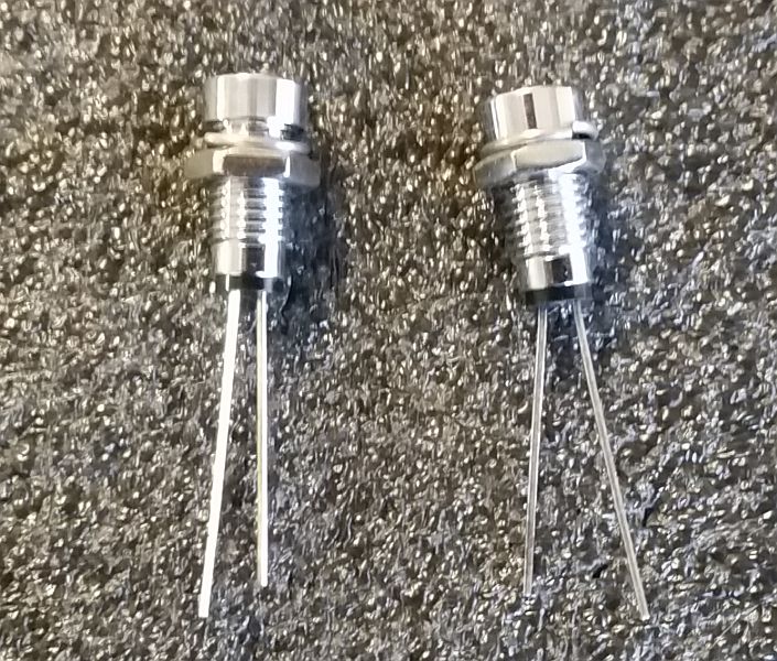

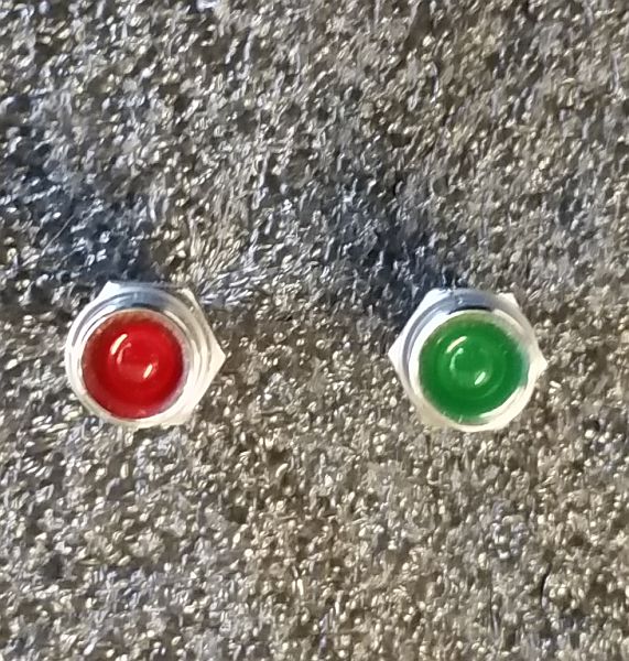

The first of some parts I ordered last week came in.
Oil pressure and neutral lights.
In keeping with the minimalist theme, these are the only two idiot lights I will be using.
I am planning on mounting them on the top side of my headlight bucket...with a toggle for the high/low beam in-between them.

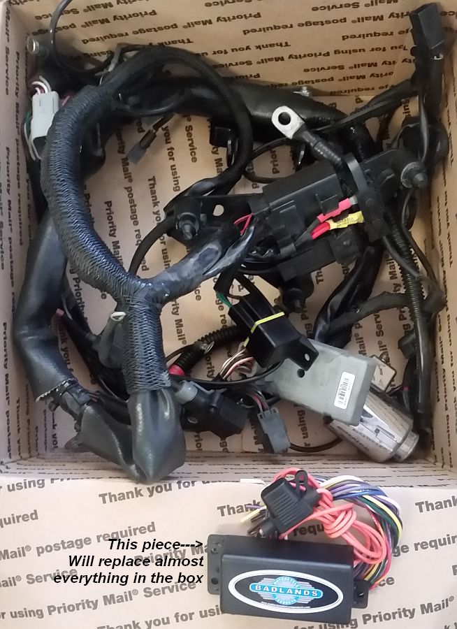

Badlands Controller for Running lights, Brake lights and auto-cancelling turn signals.
Photo below shows a box with just some of the wiring that came off the stock 2003 1200 Custom. Almost all of that box of wires will be replaced with the little Badlands Controller, also pictured.
Friday we decided to tackle laying out all the electrical to make sure we were getting all the components needed.
This is the factory wiring diagram for the bike.
We spent a couple of hours understanding everything....
...so we could figure out exactly what we could do away with...
...so we knew what we had to have.
This is what we came up with-
The only thing we kept that I wasn't planning on was the bank angle sensor. It feeds back an 11 volt negative, and rather than figure out how to short cut that (we've tried before, unsuccessfully), we're just going to use the factory sensor.
There are other ignitions that don't need that 11 volt negative feed, but the ignition I have works, so we're going with it.
The new wiring diagram will feed everything that's going on the bike. The only things that are not going to be on the bike that are factory are:

The pared down wiring will have self canceling turn signals, front and rear brake light, running lights, flashers, on/off switch, kill switch, high low beam toggle, oil light, & neutral light.
It will have a manual solenoid starter button.

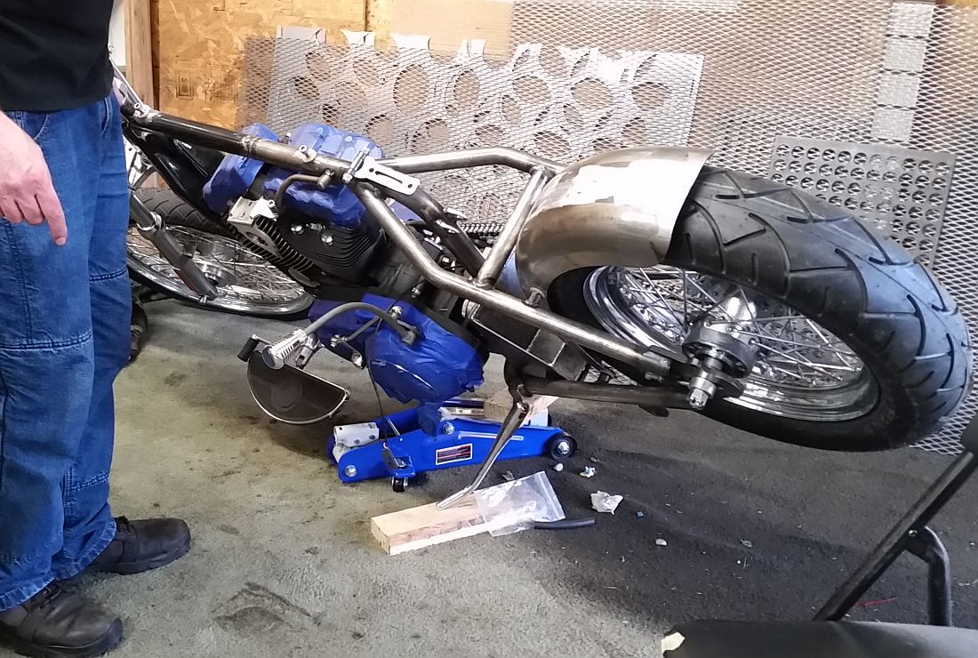

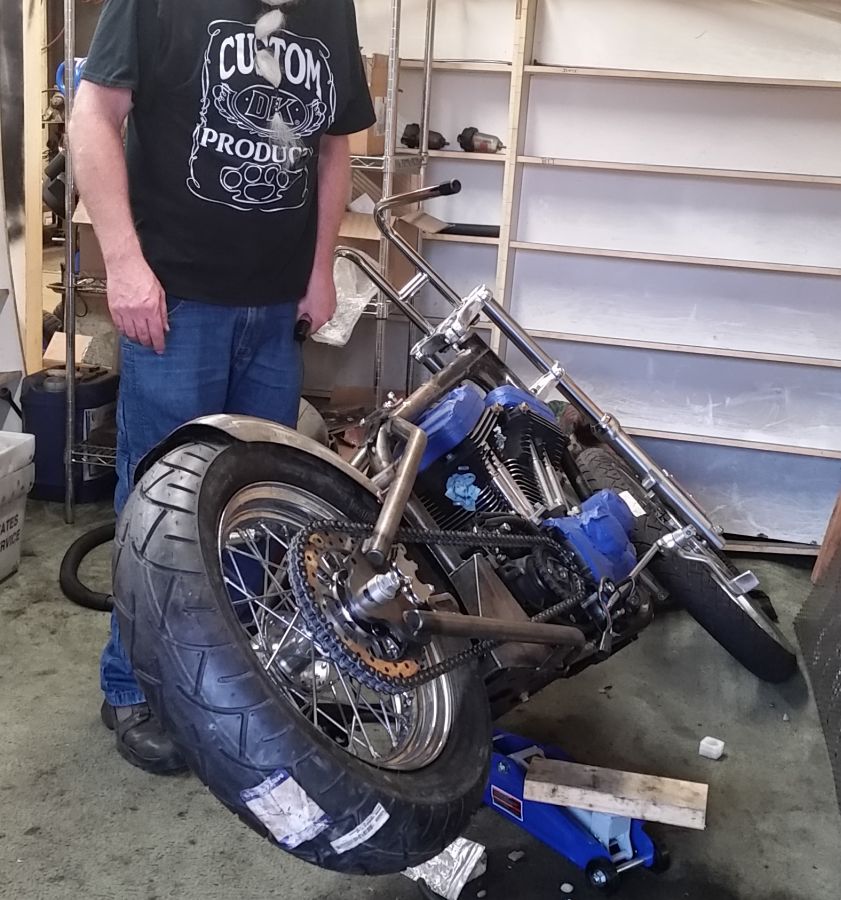

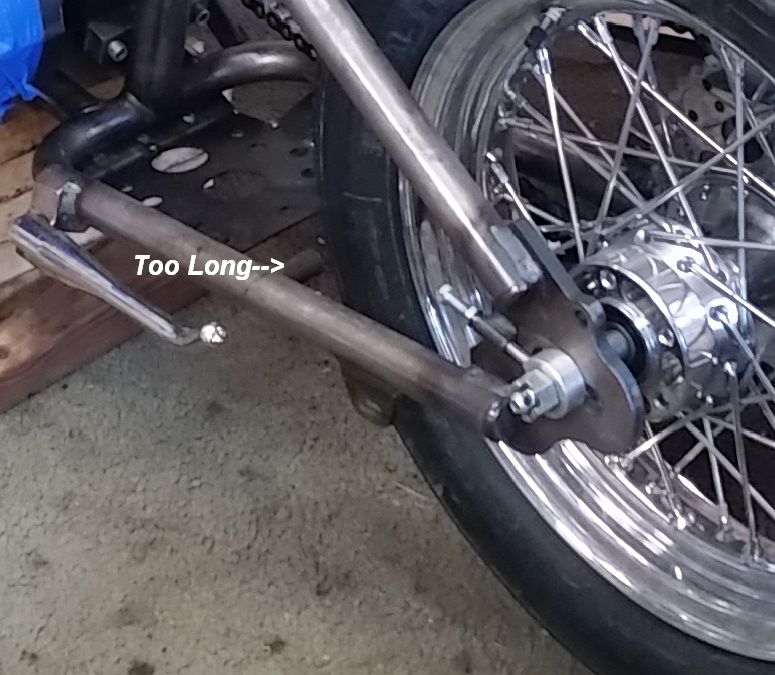

The other thing we worked Friday on was the rear axle spacers, & a fender mounting bung.
We don't have a motorcycle jack or lift at the shop...Devin and I both have one at each of our home shops.
We both thought the other had brought theirs in.
No problem...
...we used 2x4's. :)
This mounting bung was too long...
...so we removed the rear wheel, and cut it off to length.
These three points are where the fender will mount to the frame.
We thought we had the spacers right months ago....but when we looked at it Friday, it was obviously off...and we could not find any combination that set it right.
So we started from scratch.

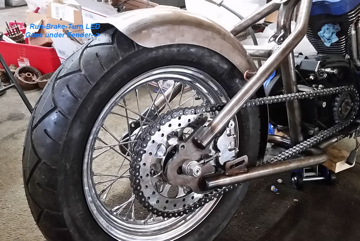

The tire is now dead centered. The chain is almost straight, but we can't move the wheel over that last 3/32" of an inch. So we will be milling just a touch off the front sprocket to get it in line with the rear sprocket.

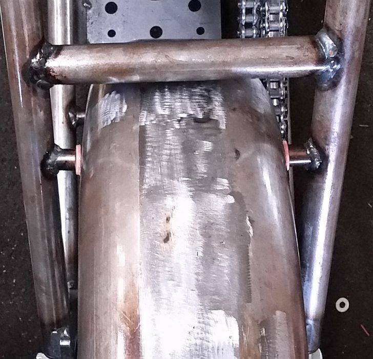

Bungs are in line, and this is very close to how the fender will be mounted...
There will be a Run-Brake-Turn LED on the underside of the fender, above the tire.
Next week we will put an additional support on the underside of the fender, then drill it and bolt it up.
So we got a good amount done yesterday, even though we only ended up with 3 hours to work on the bike.

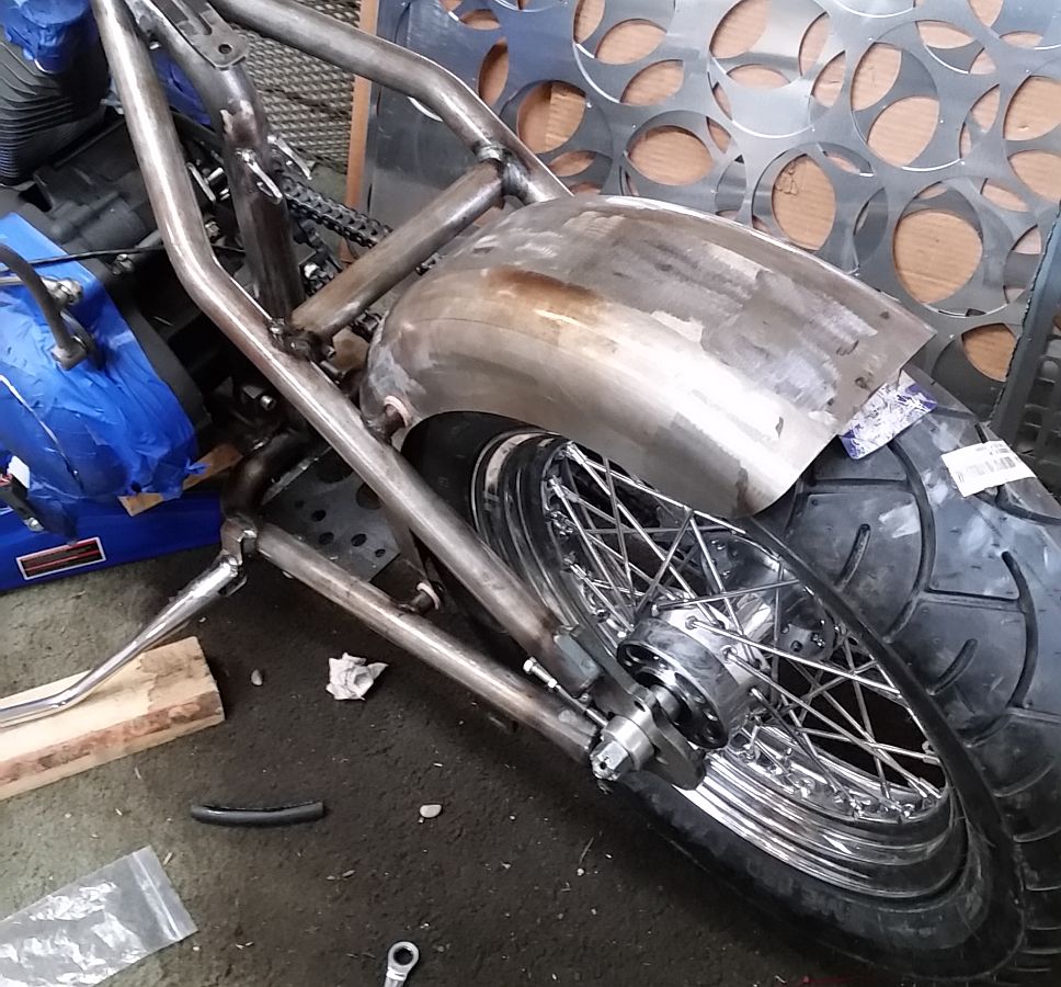

First thing we did was get the tire ready for fitting the fender-
Took a look at it from all directions...
...making adjustments to get it...
...sitting symmetrically over the tire.
In theory it seems like a simple task, but getting it an even distance from the tire, front to back on both sides, then an even distance from the center of the tire, top to bottom....lol, it can be a challenge.
Once we got it how we wanted, we measured, in mm, how much distance was needed between the bungs and the fender, taking into account the leather washers that will be used between fender and bung, as well as the thickness of the powder on the frame and the paint and clear on the fender.
The bottom left bung was perfect.
The top left bung needed just a bit taken off...
Note the welding aprons covering all chrome and powder finishes. The top right bung needed more taken off...used the cutoff wheel first, then the finisher.

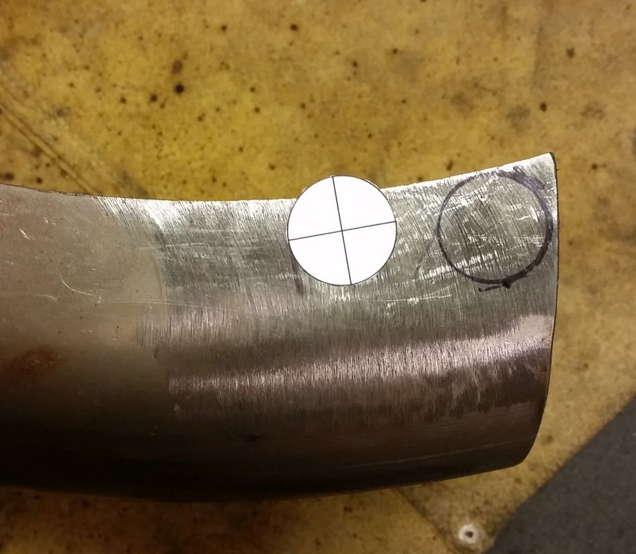

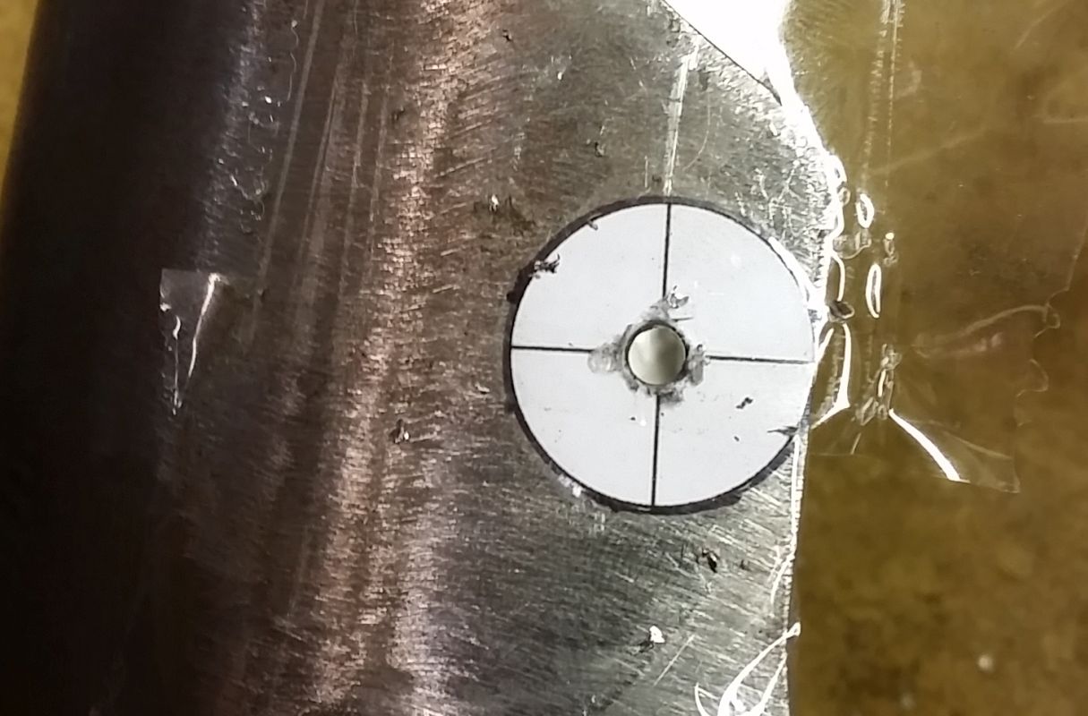

Next up was marking where the pilot holes need to be drilled for the fender bolts.
If we get these wrong, then the fender is not going to be straight over the tire. X marks the spot. :)
Pilot holes drilled.

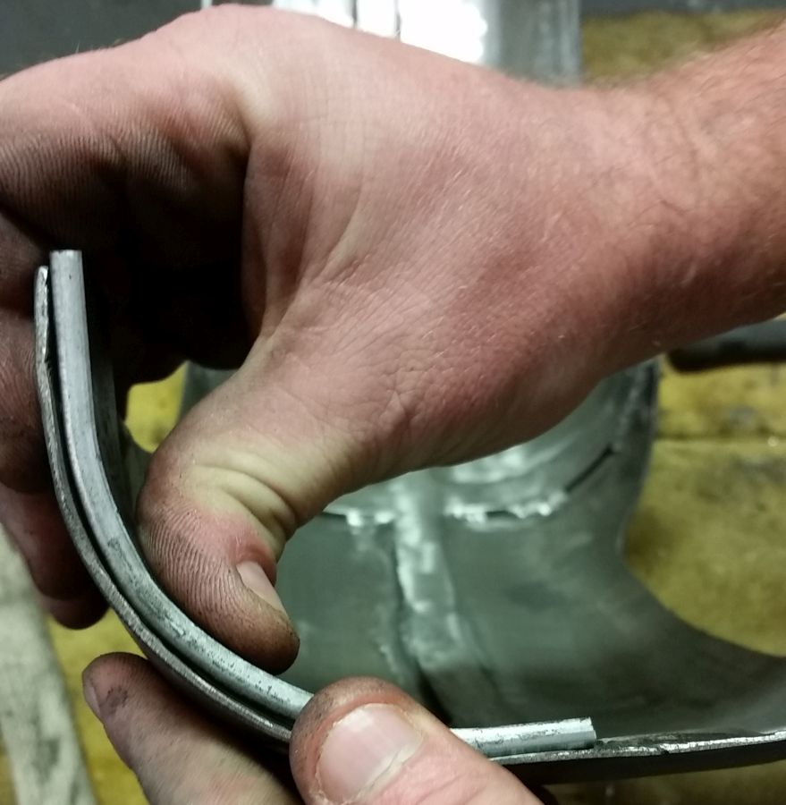

Measuring for the last brace.
Taking some flat stock and starting to bend it...
Still needs more...
That looks pretty good...
...now to weld it up.

Only 3 mounting points...bottom left, and then in the center, on either side.
Mounted up, with the leather washer between the bung and the fender.
From the top down-
These washers will compress more, but they are tight for now...we will be having powder on the frame and paint on the fender that will be eating up some space.
Looking at it from the right. Sproter and brake caliper in place. RBT LED goes under the fender...will eat up a bit of the space between the tire and the fender.
For all the photos that I've posted with the fender on the bike...this is the first time the fender is secured in place.
It is very solid, which is what we were looking for.
Although not really needed unless you plan on putting a "pillion pad" on it, are you going to put a fender brace on it?
If not, the fender brace tabs on the frame look "lonely"...;)
No pillion.
Fender brace tabs...are you referring to the holes on the axle plates? Planning on filling those, and then re-contouring the axle plates. Yep, gotta go add that to the white board right now...forgot to put that on the list.

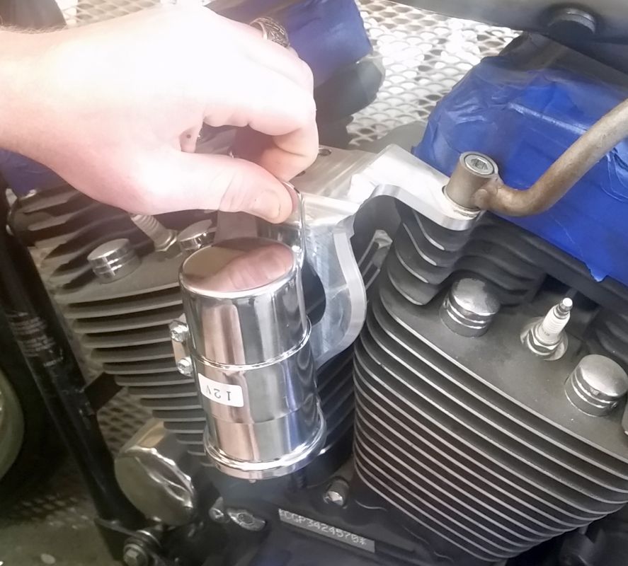

Got into the shop today and the chrome coil was here.
Gonna wait til we verify it works to take the 12V sticker off it. Will probably Not use the wires that came with it....probably will use the 409 Pro-Race wires.
Friday may have time to fiddle around with various mounting locations.
I like the chrome bobber style coil
You could use an EFI coil BUT
You would be 4 ever playing with it to get the ohm resistance down enough to lite the fire all the time with out burning up your wires
Yeah, we started down that path with the EFI Coil, realized it was not really workable. I'm liking the look of the chrome one too...gotta decide where to put it.
We had some more time this last Friday. Progress is slow but steady.
We played around with different places to put the coil-
(the aluminum piece between the cylinders is going to be gone. We just have not made the new piece yet)
No!
Looks good from the right side, but horrible on the left.
Ack-No!
That's worse!
That looks pretty good! Yes!
Unless we come up with a better idea, we'll be welding some threaded bungs into the frame to mount the coil there.

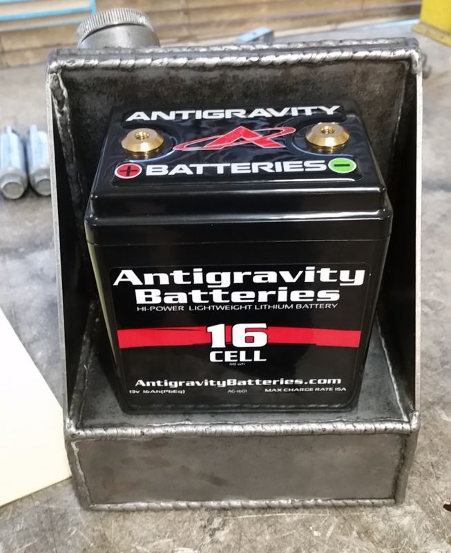

Next up was to nail down the battery mount.
The battery will be sitting on some rubber mounts, up off the oil tank. There will also be some rubber mounts between the tank and the back of the battery, for the cover to push the battery against.
There will be air circulating around all 6 sides of the battery...no part of it will be in contact with the oil tank.
We are going to use some sheet metal and fabricate a 4 sided cover (similar to what the Dynas' use with the foam strips on the inside of the cover to go against the battery. There will be some cut-outs for the two terminals and one that will show the "+ Batteries -" writing on the top.
There will also be some cut-outs in the cover, w/ mesh behind the cut-outs for a little contrast.
The cover will be fastened to the oil tank, holding the battery in place.
Next up was to measure exactly how much space we have for the electrics box.
Good welding, and a strong kick-stand from TC Bros. made it easy to lean it over and take a look. :)
Just the front tire and tip of the kick-stand was the perfect balance point, that took no effort to hold it there.
The space shown below is wedge shaped...and smaller than we thought. We will be using it, but may have to find a second location to hide a bit more...this is probably not going to be big enough for everything.
Notice the oil tank mount is just tacked together still...and the frame still needs a bunch of finish work.

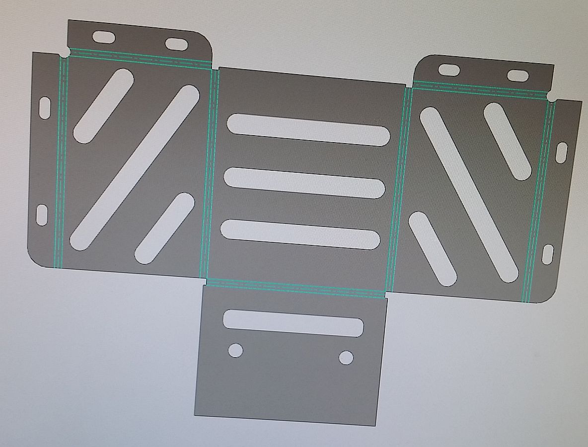

Yesterday we got sidetracked working on our 2018 product development list...but we did get a bit done on the SBS Chop.
Last week I described the 4 sided cover that will go around the battery, securing it into the oil tank shelf.
Here is a drawing of the sheet metal, before it is folded.
A couple of looks at it after it is folded up.
The two round holes on the top are to access the two terminals. All the slots, except the one on the top, will have mesh screen behind them.
Before we cut out the metal, we are going to 3D print it...making sure everything fits and we like it.
In the 3D printer drawing above, you can see it is taking 9 hours to print it this weekend...it will use 38 meters of plastic wire, and weigh 303 grams.
