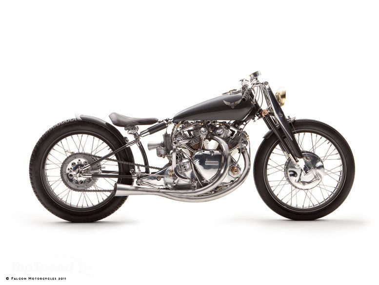

Too late for this frame idea, but it looks cool in its own way...
