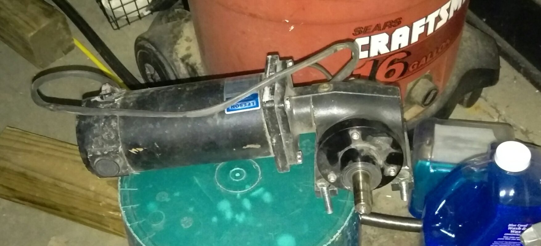

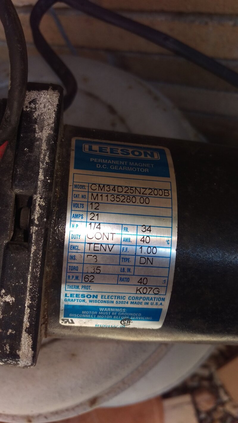

Hello all, I'm New here and to triking. I recently bought a 2004 Harley Roadking with a Roadsmith trike conversion. The reverse motor tries to move but when I look underneath and push the button it looks like the gear motor that works it might be skipping teeth Inside the gear box. Has anyone had any experience with these reverse motors and how much they Cost to replace ?

Welcome to Trike talk, look here is this your reverse set up? If it is my guess is a good electric motor shop should be able to rebuild it for you. Good Luck and check back in

So it turns out that the motor gearbox shaft keyway is broken out along with the belt sprocket being ruined. I called Roadsmith and they no longer using that motor or sprocket but are using a new reverse kit that cost $850.00 .

So I know it's been a while but I ended up finding a machine shop close to me that Made a new shaft for the gear box and made a brass bushing for the sprocket that meshes with the drive sprocket. I got it back yesterday and installing today.
So, I installed my reverse motor yesterday and it works like its supposed to but I can understand why it doesn't last. When you let off the button going backwards it stops immediately with no drift. That has to be hard on the plastic gear that turns it.
