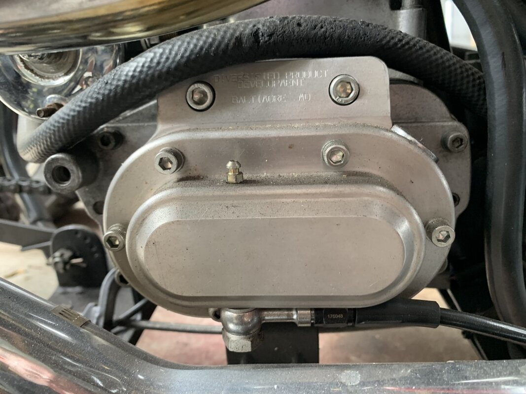

can anyone tell me if an aftermarket hydraulic clutch will work with the mmd reverse.thanks
You will need a longer push rod and the MMD will add at least 3/4" to length of transmission.
The hydraulic assembly should bolt up OK except for the slight cover modification.
thanks. ive got the extended rod with the reverse kit.what cover mods needed.ill also have to put an indentation in the exhaust pipe to get clearance
