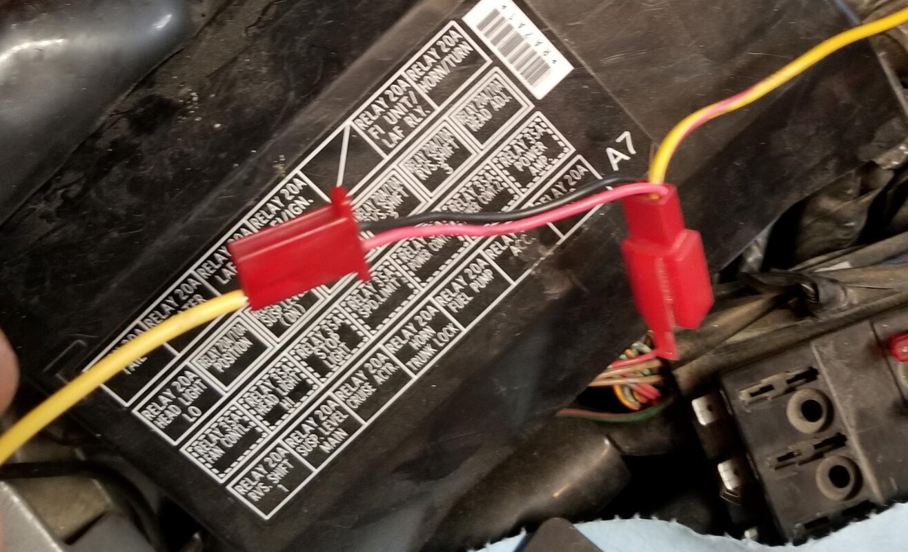

Here is a view of the yellow/red wire I was talking about. It is attached to a red connector. That connector harness has a red male and a red female connector and attaches inline to the starter solenoid. The particular inline harness only seems to be there for that yellow/red wire. So it seems like if I can find a 12v source that is only powered during reverse mode, I can just connect it to the yellow/red wire, eliminate the pass through extra solenoid harness, and I will have full time reverse lights...

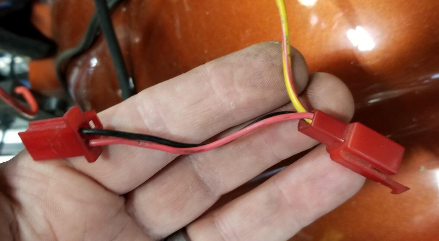

Here is a View of that part of the harness disconnected. It is actually part of the CSC harness that gets added during the conversion. It T's into the GL1800 wiring at the solenoid to grab power. From the Viper installation manual, that wire then goes to a relay that I haven't been able to locate and is connected to pin# 85 on the relay. From my limited electrical knowledge, when power is applied to pin# 85, it energizes the relay and allows power to flow through the relay and turns on whatever is being powered by the relay.
I tested it on a multimeter and with just the reverse mode button pressed and 5he reverse indicator light activated on the dash, that wire is dead. It only got power when the start/reverse button was also pressed. So from everything I have been able to figure out, it is just the trigger wire for the CSC supplied reverse lights relay. My plan is to completely delete that small T connection and only utilize the yellow/red wire. Doing this, it will no longer be connected to the solenoid. Now I just need to figure out a source of 12v that is turned on only during reverse mode. And like I mentioned, the fuses will not work. I am researching other options...

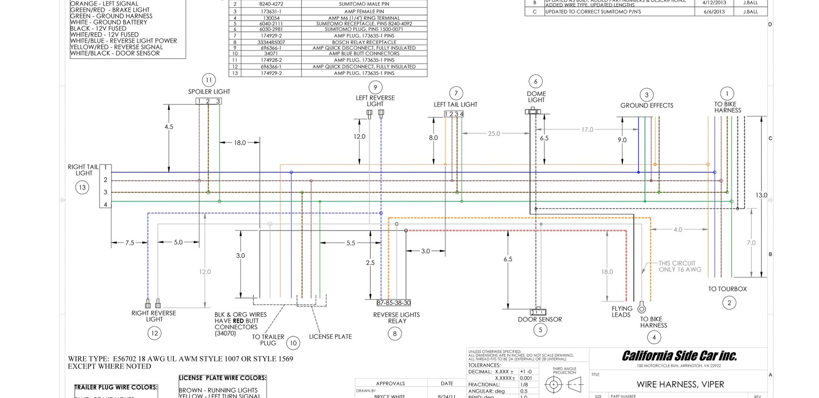

I dont know if this will work or you will be able to enlarge it but this is a copy of the wiring diagram in the Viper manual...

It also appears that the CSC wiring diagram may be mislabeled. It shows terminal 30 as 12v power, terminal # 38 as ground, terminal # 85 as a 12v trigger source, and terminal # 87 as 12v output to the reverse lights. I cant seem to find any relays with that configuration. The relay information I can find on 4 terminal relays have 30, 85, 86, and 87. Based on that the CSC relay is correct on 30 and 87 but 38 should probably be #85 and is ground and #85 should probably be #86 and is the 12v source used to energize the relay. Does that seem correct?

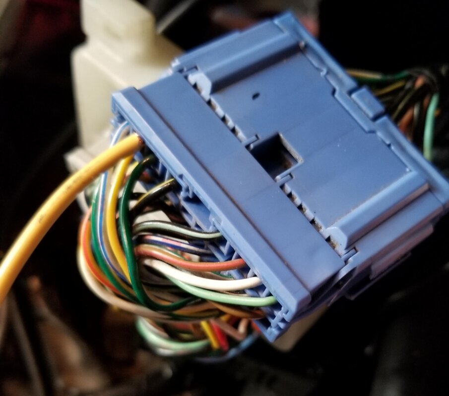

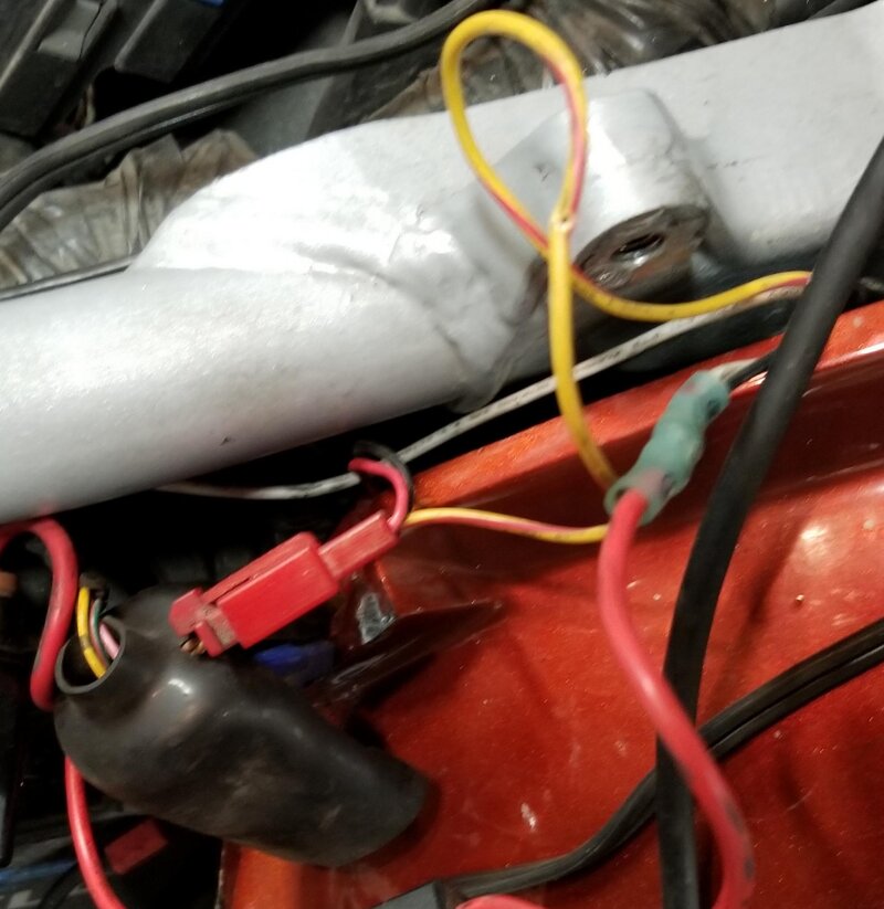

With the help from another forum, I think I have come up with a solution. It was discovered that in the C18 connector which is tucked into the right side of the fairing, there is a yellow/white wire that goes between the reverse mode switch on right handlebars and the cruise/reverse module. When the reverse mode button is pushed in, there is power on that yellow/white wire. When the reverse mode button is pushed in and released to get out of reverse mode, there is no longer any power on that wire.
I made a makeshift test lead and connected it to the C18 connector and then disconnected the CSC solenoid harness and connected the other end of the test lead to that. When testing, no reverse lights on back of Viper when in normal mode. When I press the reverse mode switch, the Viper reverse lights come on. Now I just have to permanently attach the wire and I will have full time reverse lights. It's not the easy solution I was looking for and not sure how it could be implemented in the kits but it does work...
In the photos, my test lead is a yellow wire and its temporarily connected to the top left of the blue connector, 2nd pin. In the bottom picture, I temporarily attached my yellow wire to the positive pin in the CSC solenoid harness.
