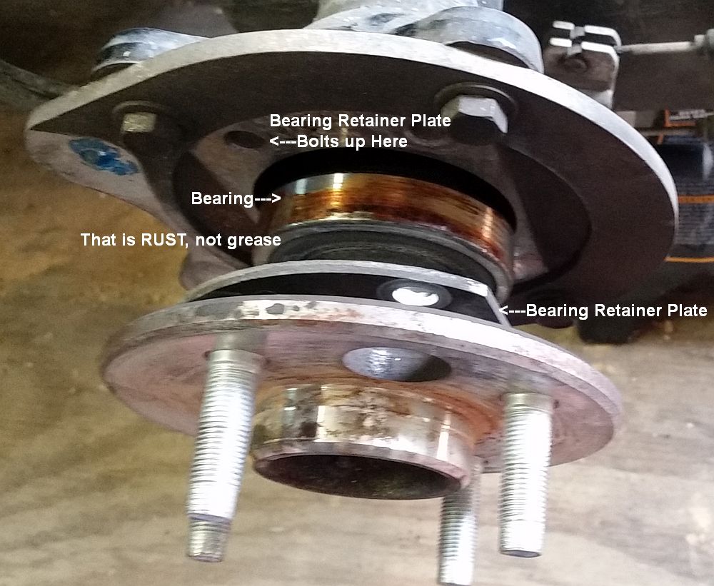

The bearing retainer plate is supposed to hold the bearing tight in the housing. It was not. Instead, the plate was allowing the bearing to rock in the housing. Below is a photo of what we saw right off the bat...
...witness marks on the plate where the bearing was banging up against it.

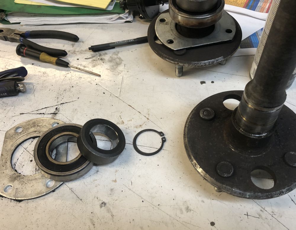

Here's a better photo of both plates, where the witness marks are clearly visible.

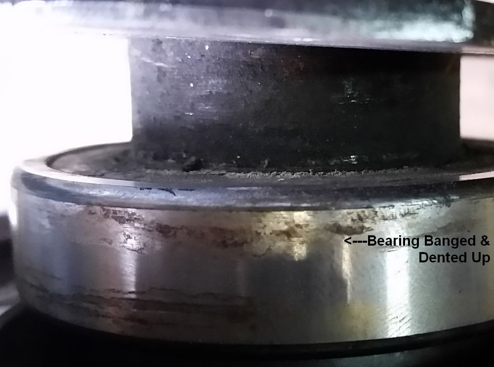

What may be even more disconcerting is how much the outer surface of the bearings were banged up from all the movement in the axle housing.

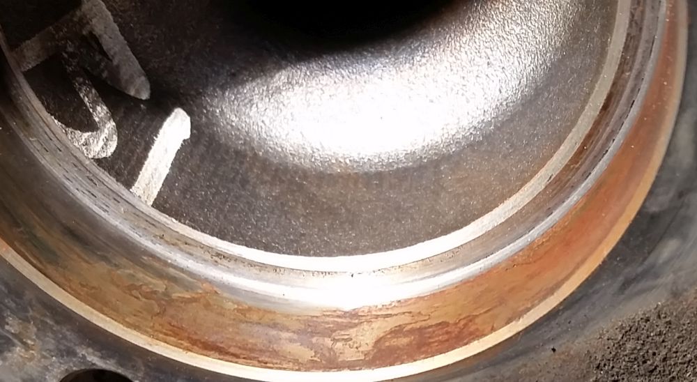

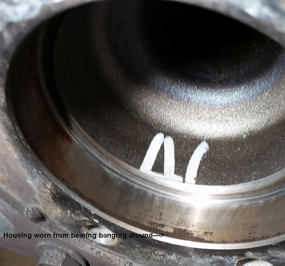

Photo of axle housing worn because of bearing movement-

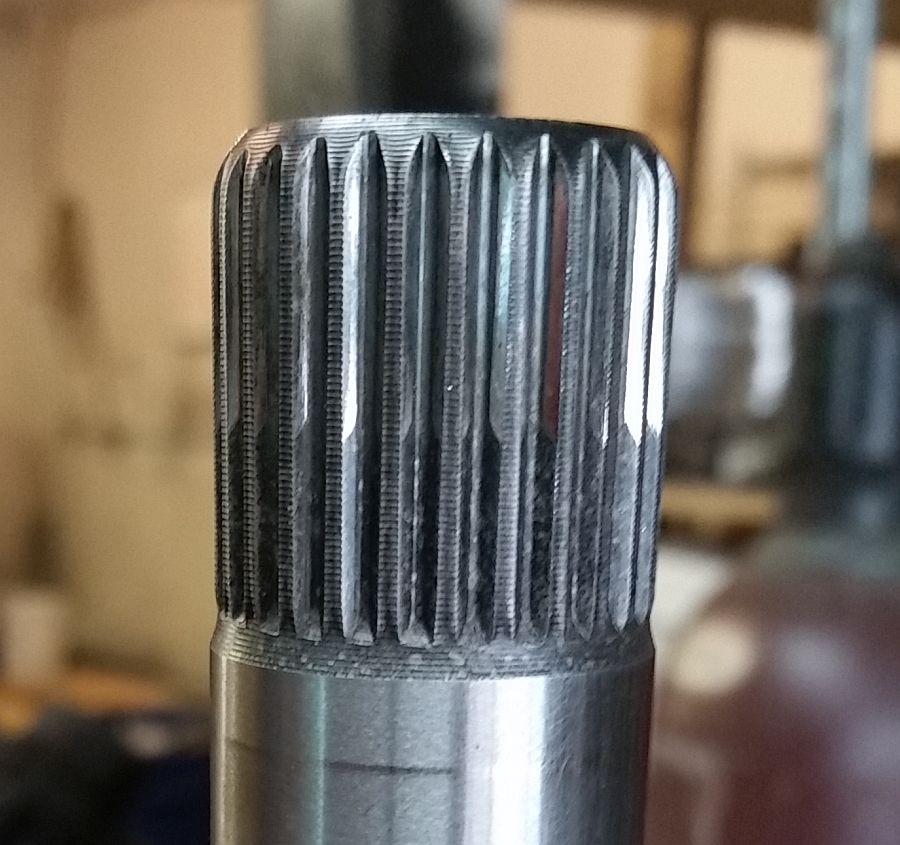

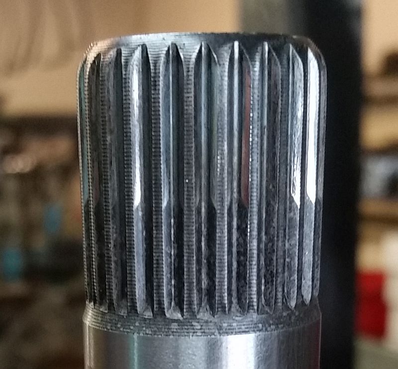

Photo of worn splines...
...these are not horrible, because I caught it early enough.
The last thing we saw that we did not like, although it is not a potential for catastrophic failure like the above, is that there is not a good seal to keep water out of the axle housing.
As seen in this photo, water can just sit in the axle housing and start rusting-

First thing we did was pull the snap rings, then press off the the axle retainers and bearings. That gave us access to the defective retainer plates.

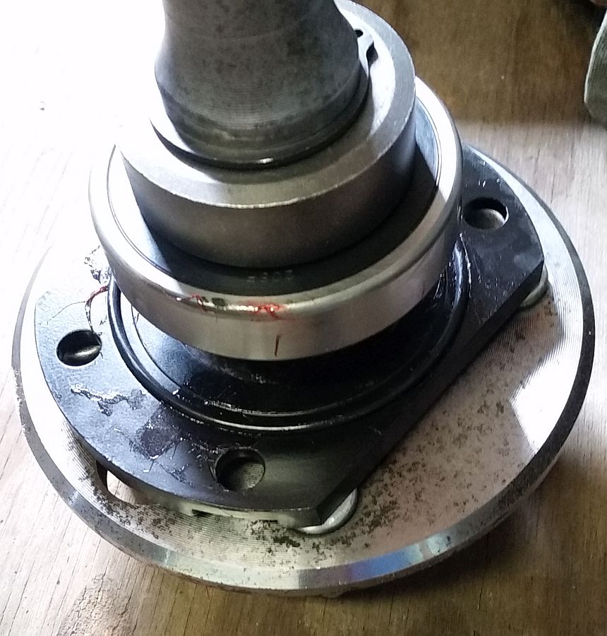

Devin then designed a new plate. 2.5 x's as thick. It is cut from 1018 American Steel...not stamped.
It also has a 2/100" shoulder that butts up against the bearing. This makes sure that there is NO rocking or movement of the bearing in the axle housing, even if that surface it bolts to is not completely flat (accommodating poor tolerances).
It also has a place for an o-ring, so there is no chance of water getting in there and sitting.

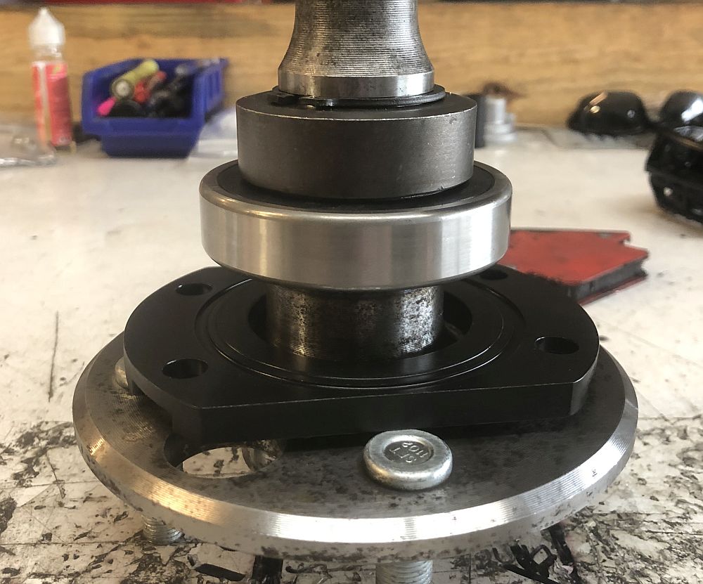

Ready to install with new bearing and plate with an o-ring.

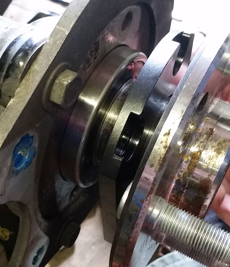

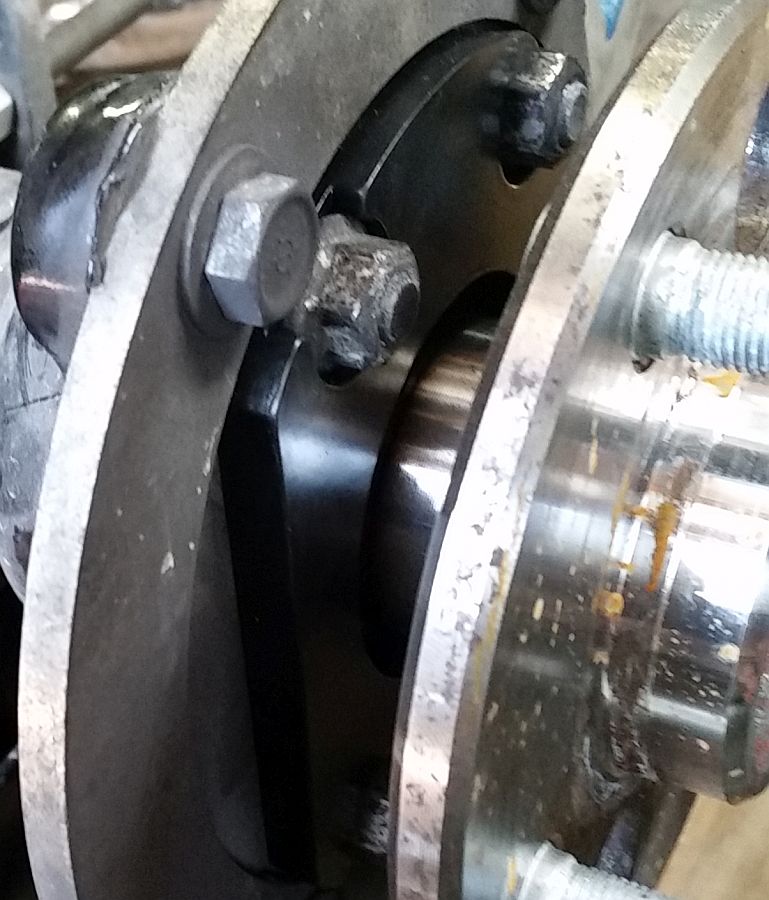

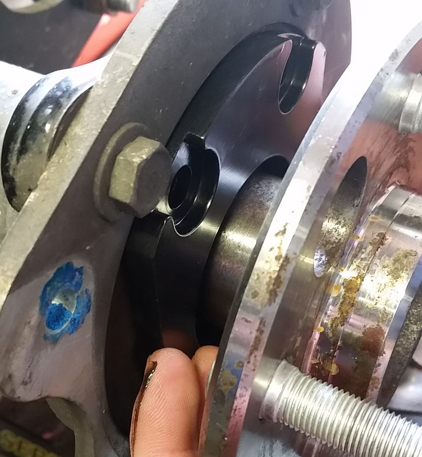

Installation went easy-
All done!
I now have several hundred miles with this new setup. It is rock solid with no clicking, clacking or wandering.
