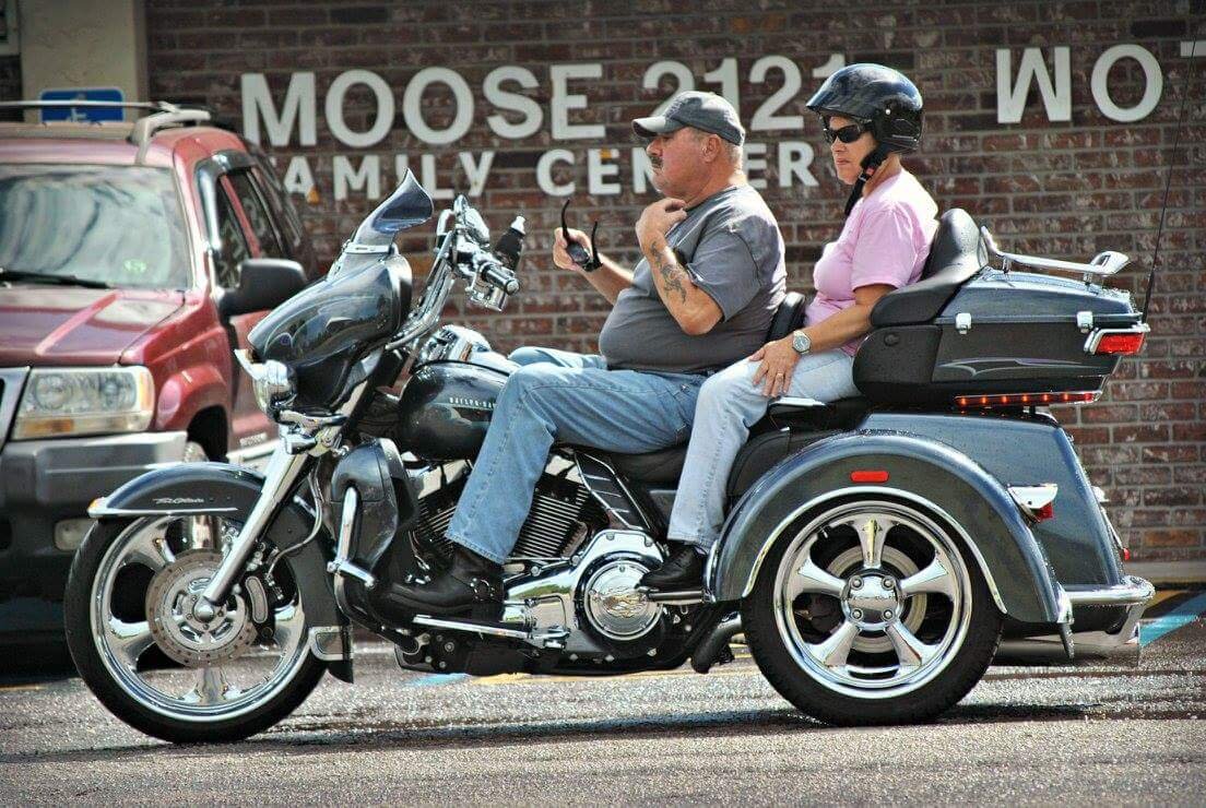

My friend put new wheels on his. The larger front rim diameter coupled with the change in tire profile made it easier to turn.
He also has the shock bracket lift.
I've seen that guy posting in a couple of TriGlide owners groups on Facebook. Nice trike!
IIRC,it has an 21" front and 18" rear wheels.
