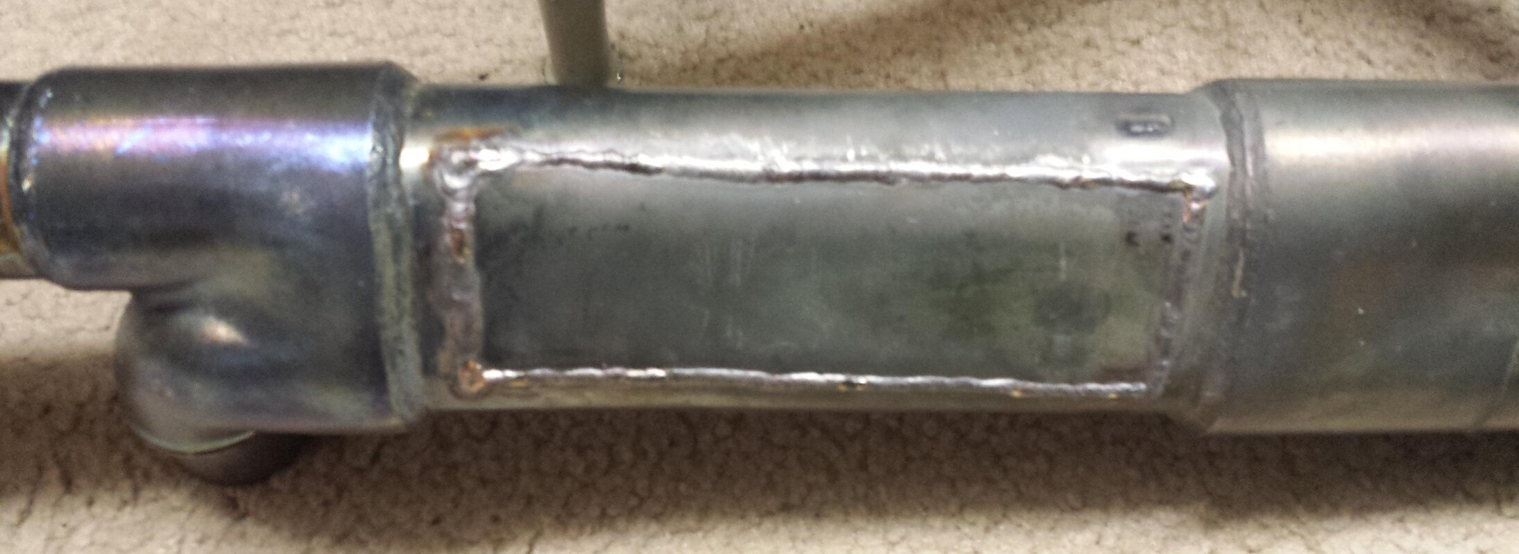

I de-catted my head pipe (or you can get one already done from wildpigpipes.com for $150 and get $50 back if you turn in your original pipes) and use the Nightrider FL-Vied-10s (50% setting) to richen it up. I'm running the stock Air Cleaner and mufflers.
It runs much better and way cooler, and sounds a bit louder.
This was a simple cost effective solution that matched my just cruising around riding style.
I was looking at the Nightrider site the reviews and think I am going with it. Will be taken my cat out all so. I may buy a header all ready done but I am able to cut mine and weld it back.
