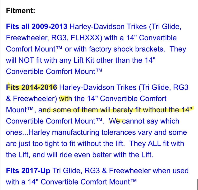

If the deal is good, I would definitely scoop them up.
They should fit without any lift brackets.
If you have lift brackets, they will not fit as it’s too much lift.
14” shocks will fit with their “convertible comfort mount” brackets… or OEM stock brackets.
They do have a side note on their site saying
Some will barely fit.
I have 2014 Tri Glide and have no clearance issues whatsoever. (I’m currently running 14” Pro Action shocks, but brand should not matter)
Pic of side note from their site:
But they should fit without any problems. (Just No “Lift brackets”).
