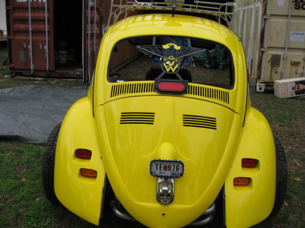

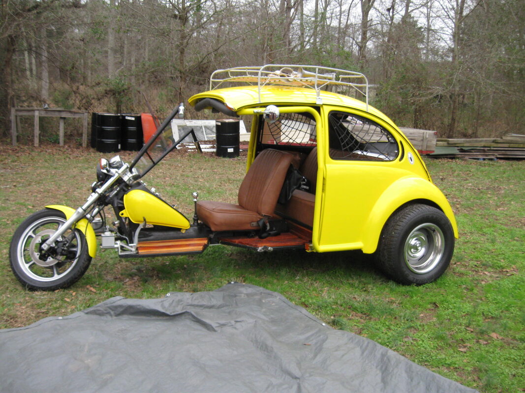

Here is what I currently ride but am building another with autostick. Will be different configeration from this one . Will support rear VW shell look just like a stock VW from the rear. Pictures of the build later
Thanks for asking for pictures, I too love looking at the differences being built

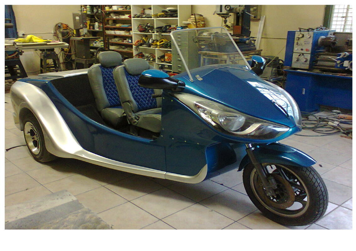

Photo0347.jpgMy knowledge about the front forks are zero. What can I do to make them stiffer. The front weighs about 70Kg. Small pot holes make it reach max movement. I never opened them. Maybe a service would do the trick.

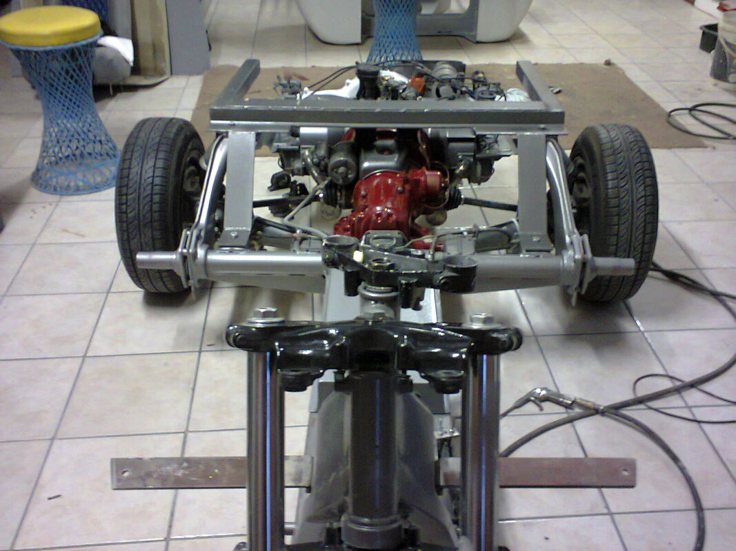

Body-off profile.
Nice work!:clapping: Do you have a picture showing a body-off profile shot of the frame?
Thanks a lot. Still a lot to do. I had to drive it to get some motivation. Taking a chance driving in the streets of my tiny town. Not registered yet.Wiring done, but no instruments and switches yet. Still working on my third dashboard design.
