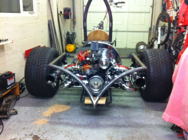

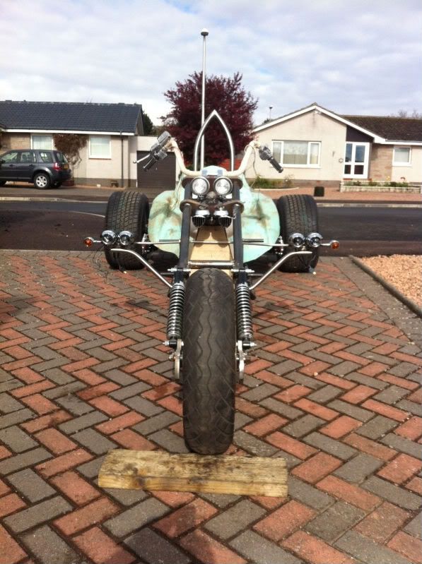

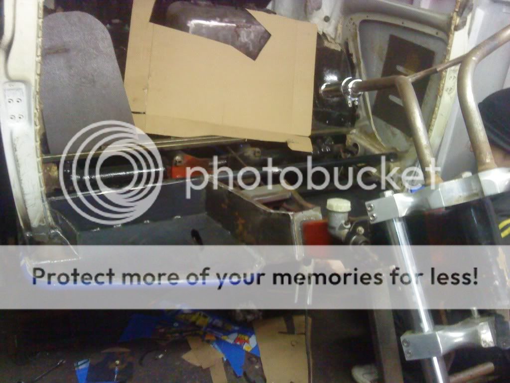

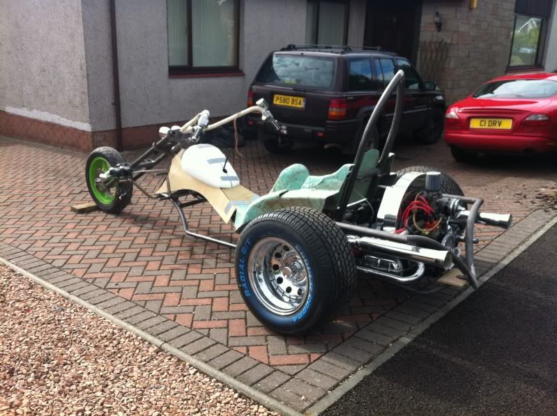

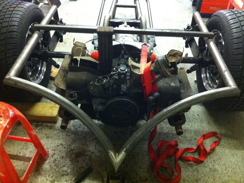

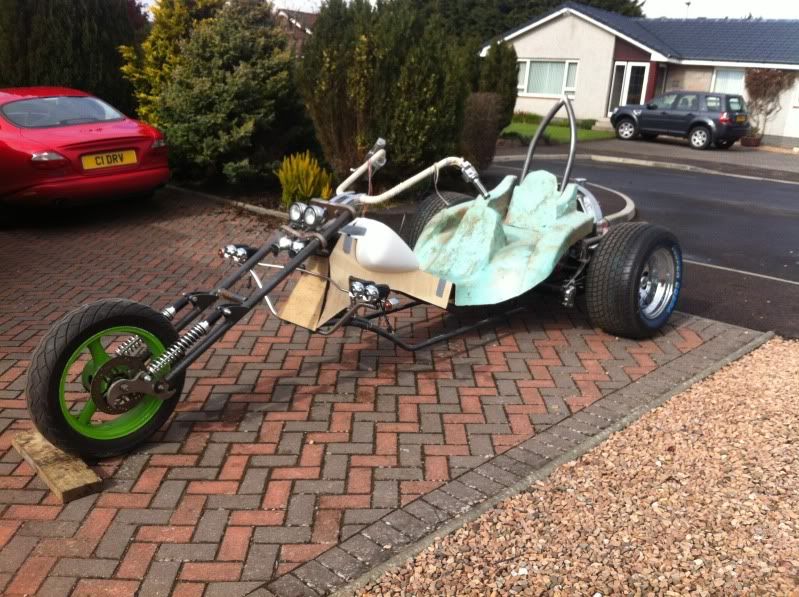

Mine when i had just trial fitted the rear shell
And from today making a new floor

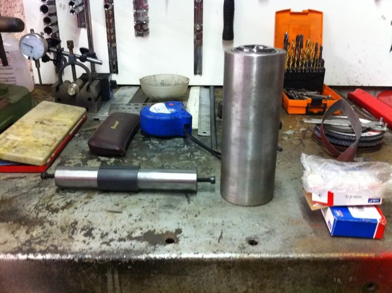

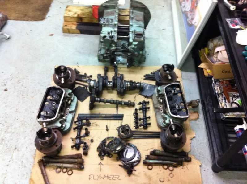

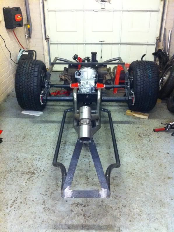

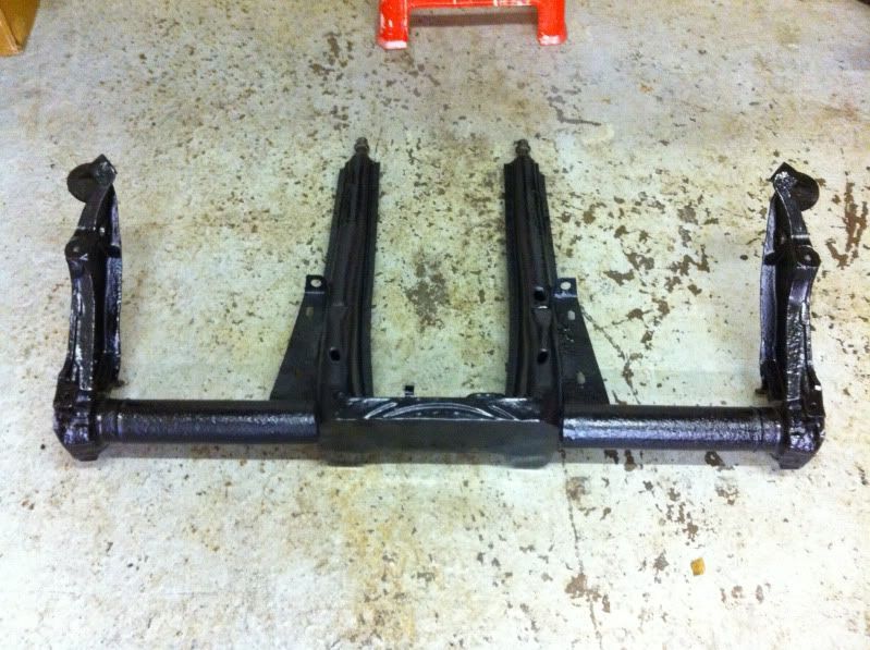

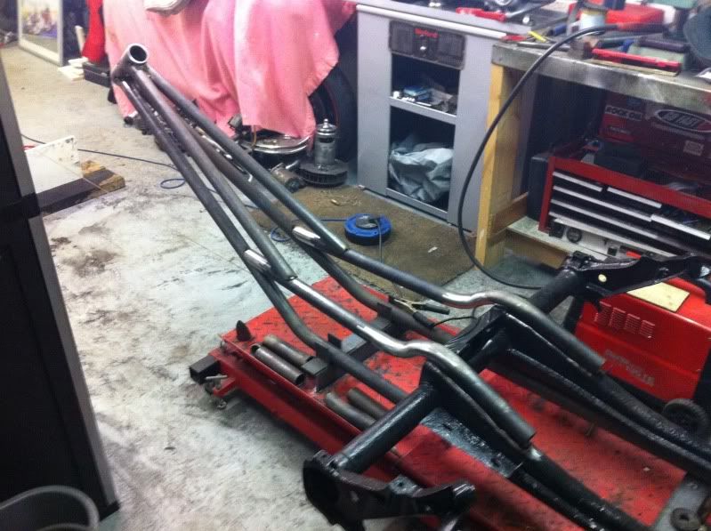

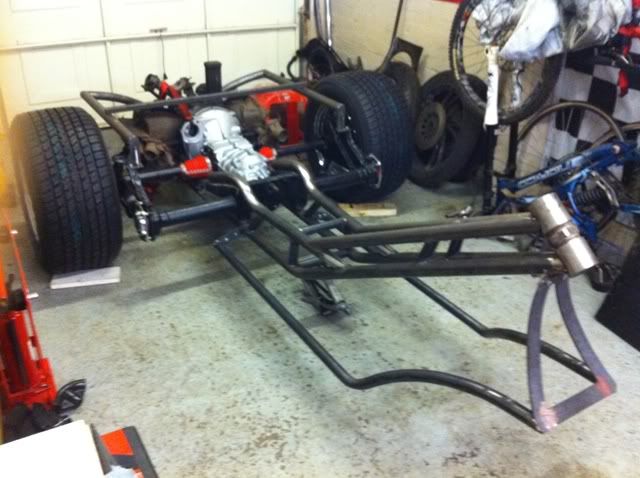

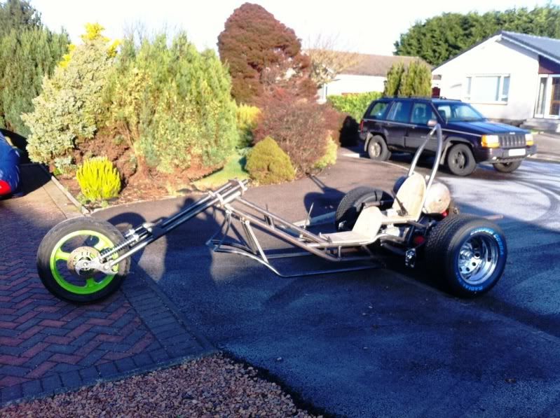

Please see latest build pictures.
Frame in primer coat
Gear linkage sorted
Extended bell housing built with clutch mechanism and relocated starter motor
Suspension link arms built
Front forks (Harley Fat boy) and wheel
My previous pictures were mainly mocked up for design purposes. I am now at the dry build stage. No way can they fully fabricate a bike from start to finish in 10 days on biker build off.
Hope you like it.

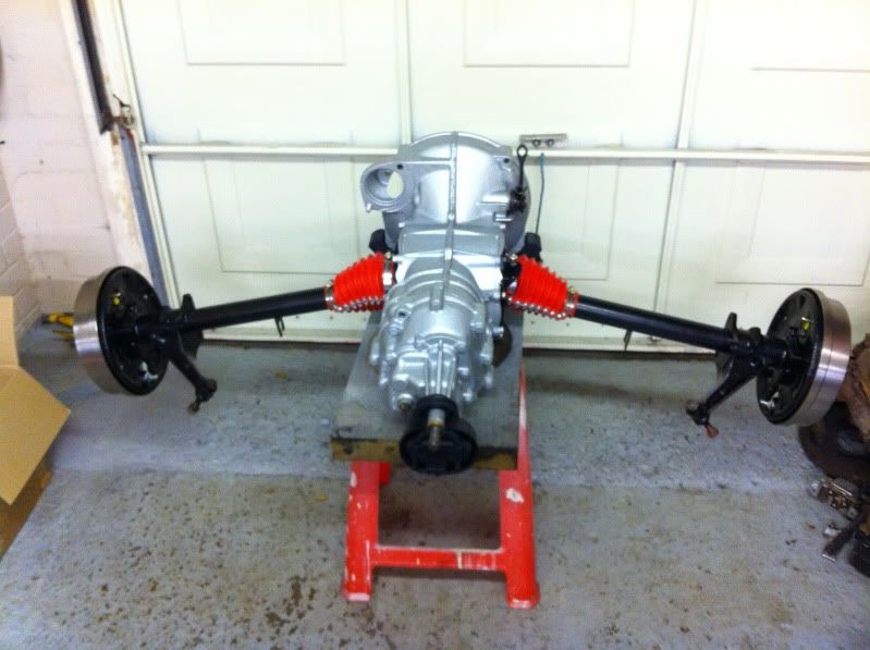

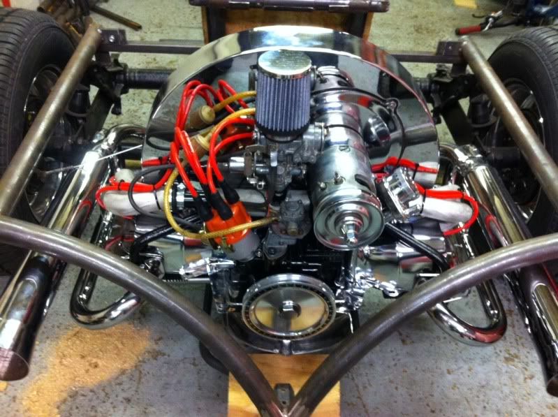

Ok where to start. Engine is a 2110 stroker. 82mm super race crank. 90.5 Cima jugs. Eagle 2246 cam. Super case. 1.25 ratio rockers. 050 d-ported heads. 42mm in 37.5 out ss valves. 44 idf clone carbs. Somewhere around 160 hp. Trans is swing axle. Early (1965) short axle that is shortened 5 inch per side. Oiling and misc parts remachined to run upside down. Hd splined gear shafts. 1.26 third. 0.82 fourth. 3.44 Rancho ring and pinion. Billit side covers. Crown super diff. The chassis is a honda front end. Honda handle bars and controlls. Honda seat pan and trunk. The frame is water pipe frome home depot. Rear suspension is ss swing arms with cross mounted boat trailer spring. Fenders are axle mounted boat trailer units. Lots and lots of hand made pieces to make it all work.
Re: Post Your VW Trike Pictures HERE
The reason the tranny is mounted upside down is that the engine has been forward mounted, not rear as usual for these engine so if the diff was mounted around the right way up you would have four reverse gears and one forward, so fitting the gearbox upside down swings the diff to the opposite side of the pinion and awwla you solve the problem and you have four forward gears with the engine forward mounted successfully simple solution to a complexing problem VW's, ahh so versatile.:wave4:
The main reason was to lower the ground clearance down to chopper motorcycle height without cambering the axles badly. Secondly it puts the center of gravity below the axle centers. Formula "V" racers used to do this. Thirdly I did not want to run on the "heal" of the ring and pinion. I have never heard of anyone having a problem with a flipped ring gear but from an engineering point of view I think you would be pulling on the coast side of the teeth. Flip the whole trans and the ring is still on the correct side of pinion. You caint just flip one upside down, it does take some machine work to the oiling system. Had to build the trans anyhow to get the gear ratios I wanted, so might as well do it how I wanted.
