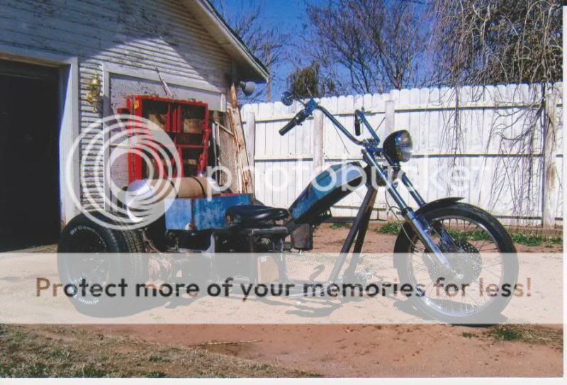

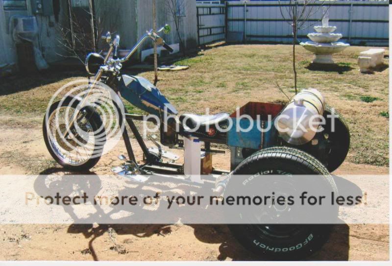

Here is the newest pictures of my project. Still need to plumb and wire it, as well as figure out a front brake [Illinois law-dumb!] Oh well, still in the build stage. Havin' fun. And, last but not least, my camera shy welder/painter/pinstriper, the infamous Garld 'Toby' Jones.

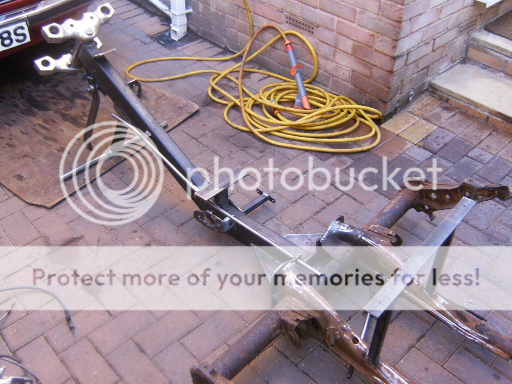

Are work in progress pics any good ignore welding its rough and to be re done lol
The frame i Purchased
Getting on with the build seat bases not finished yet

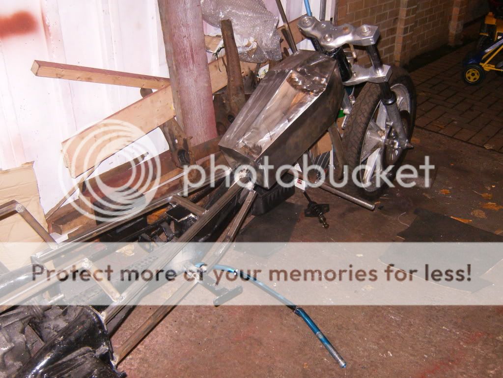

This is what I am building mid engine no cooling tin - 345 wide tyres 15 x 12 wheels.
Building everything myself including frame.
Have parted engine from gearbox by 6" so that the wheels could be made very narrow. Each axle is only 6" long. Building extended bell housing to house clutch mechanism and slave cylinder which will all be hidden in side the new bell housing. Starter motor will be moved to the underside.
I am using CBR 900 carbs split in two.

Another picture for you:
p.s. Front end is Harley fat boy. Will be replacing front wheel with an 80 spoke skinny 21" wheel. This should exaggerate the wide rear wheels nicely.
Final trike will be full chrome and gloss black.
