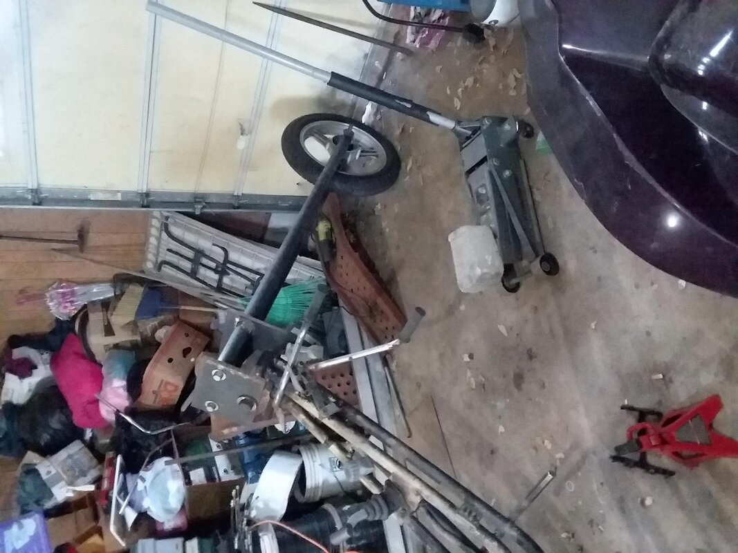

Here are some more frozen trike pictures. My daughter wants me to pay all of the rent this month so she can catch up on the other bills. She had an on the job injury in about May, was cut off of Workers Comp, but was not released by the doctor so she couldn't go back to work. She slapped a lawsuit on everyone. She just collected on the first of this month. She owes $3850 in back rent, which she is paying Friday. I don't ask about her business, so I can't say how much she got from the settlement, or who, or what she owes. The gist of this is that there will not be many trike parts bought this month, and no garage heat either. Ferrell Gas has no deliveries in this area, they only have a filling yard for their trucks here.Purple engine 1.jpgPurple engine 2.jpgPurple Five foot long, cold rolled, solid steel down tube.jpgPurple Front Brake Caliper Assembly 1.jpgPurple Honda 350 dog bones.jpgPurple Hydraulic clutch.jpgPurple Only wiring left on trike.jpgPurple Neck welding 1.jpgPurple Neck welding 2.jpg :dancing-santa:

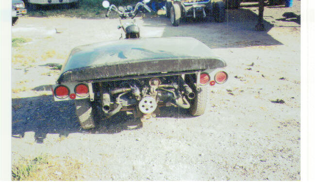

One of the trikes I built from the mid 90s.

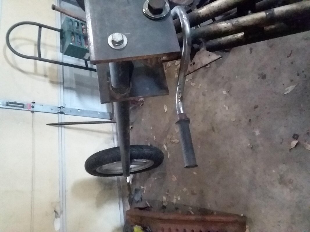

Played out in the garage for the last couple of days. Put this on Pig trike. Have to refine the trees, cut the Honda neck off because there were pieces of the down tube clamps broken, the down tubes wouldn't hold oil, and because I want to put the leading link front end on it. Then I have to weld the leading link neck on. It will be kicked out at over a 45 degree angle so I can turn without having to lean off of the trike withe wide swing of the handlebars. The leading link neck has Timken 07204 1" cup and cone bearings in it. It is a 7" long, thick wall, heavy gauge tube. The down tubes are two pieces of 2" round, by 5' long, cold rolled solid steel bars. Had the bottoms of the down tubes drilled 1" from the end through the center of the tubes for bolting the rockers inside the tubes. Had a machine shop drill and tap the center top of each tube for a 1" wide screw to hold the tube to the top tree. Had a machine shop drill a 1/2" hole through the center, 1" from the bottom end, and put a 4" tall slit through the hole in the tubes to mount the rockers into. I still have to figure out the length of the rockers, I have the metal for them cut and drilled, I'm just not sure I'll use them the length they're cut to. The front end was for the trike I was making in Lodi before I moved into my daughter's house. I brought most of it with me. The rest is in my VW in Lodi storage. At least I got this much done, no matter how many times I have to redo it to get it the way I want it. :clap:
It is just kinda bolted through the Honda neck with no bearings, and I still need to put the rockers on, but I can't find all of the bolts I got for putting it together.
