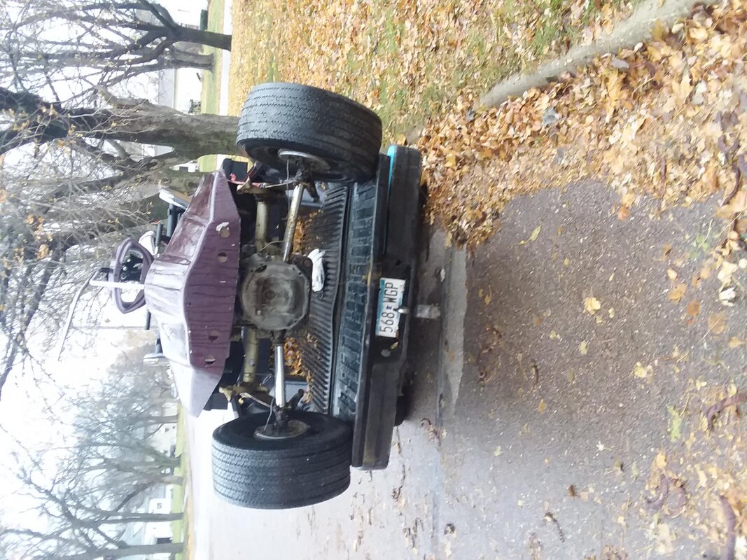

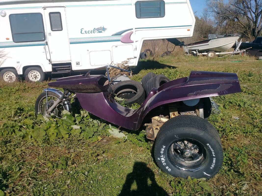

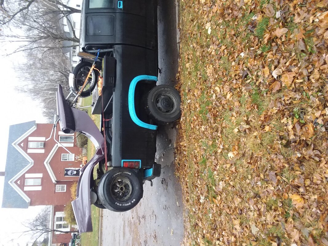

:presents: I found this setting in a side yard in the country. After some haggling, we settled on $200.00.
We put it in my daughter's pickup bed, and went home. My daughter told me that since it was my trike, and it was hiding her tail lights, I had to drive the 50 plus miles home. I made it.
I got two cardboard boxes of parts, a plastic bucket of rusted nuts and bolts and a late style "rebuilt" engine.
If someone has spare engine parts they want to sell, please let me know. It is a 1600 dual port engine. No engine tin at all, no part of an intake manifold, no fan housing, no alternator, and no fan. I do have a new (10 plus years old still in the package) oil pump with an attached filter, and a distributor drive gear. No carburetor, no rear pulley, not much of anything really. I'm not begging for handouts, I'm want to pay for what I get. Purple Pig 11.jpgPurple Pig 1.jpgPurple Pig 2.jpgPurple Pig 3.jpgPurple Pig 4.jpgPurple Pig 3.jpgPurple Pig 6.jpg
This poor old pig trike has been setting in a side yard for six years, and unknown years in other places, but I will get it going again.
Thank you.:titanic:

There are a lot more pictures of the trike from before I started taking it apart. I will get on the pictures now that it is inside, and in a bunch of pieces.

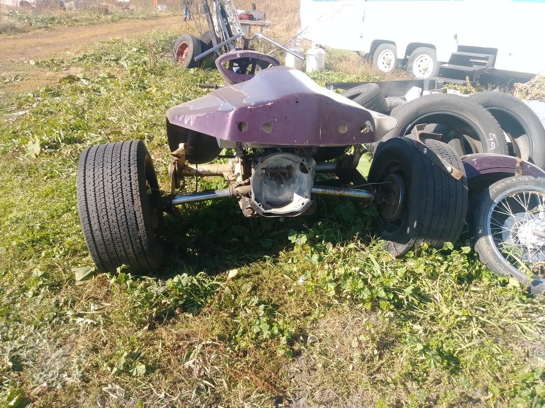

Taking off the body is good, as one should look over all welding joints and all so inspect the frame for damage or bent parts from previous accident. With frame bare one can roll it over a square drawn on the garage floor to see how all lines up.
Next the trike has hydl. front fork's , or inner tube springs ?
Both of these suspensions have a limit in their operation. From what I have read (rebuilding my front end) is that they start to fall short on working properly once you get to or past 45 degrees in rake angle. I also read on article that said 42.5 degree's is when they start to diminish in compression ratings.
*** The body is off, and from the measurements from the outsides of the torsion bar tubes to the center rear of the neck it is within a 32nd of an inch, and that could be form the bolt being loose in the hole.
Next the trike has hydl. front fork's , or inner tube springs ? Both of these suspensions have a limit in their operation. From what I have read (rebuilding my front end) is that they start to fall short on working properly once you get to or past 45 degrees in rake angle. I also read an article that said 42.5 degree's is when they start to diminish in compression ratings.
***The trike has hydraulic forks. It looks kinda like a 350 Honda, but I'm sure it isn't. I'll post more pictures. I didn't do a rake angle yet, as my rake magnet is in my Bajie bug in Lodi. Ill get one this next week, weather permitting. I made a leading link with a set of 5' down tubes that I'm considering using if I can get some co-operation from the dmv here. I want to cut the neck that's on the trike off and use the neck I had made for the leading link. If I use the complete front end, there will be less hassles. If I get to change the neck, the front end will be at a ridiculous rake, but it will only have about two inches of trail, and it will ride like a Cady on the road, and a go cart in the curves, minus the slipping off the road.

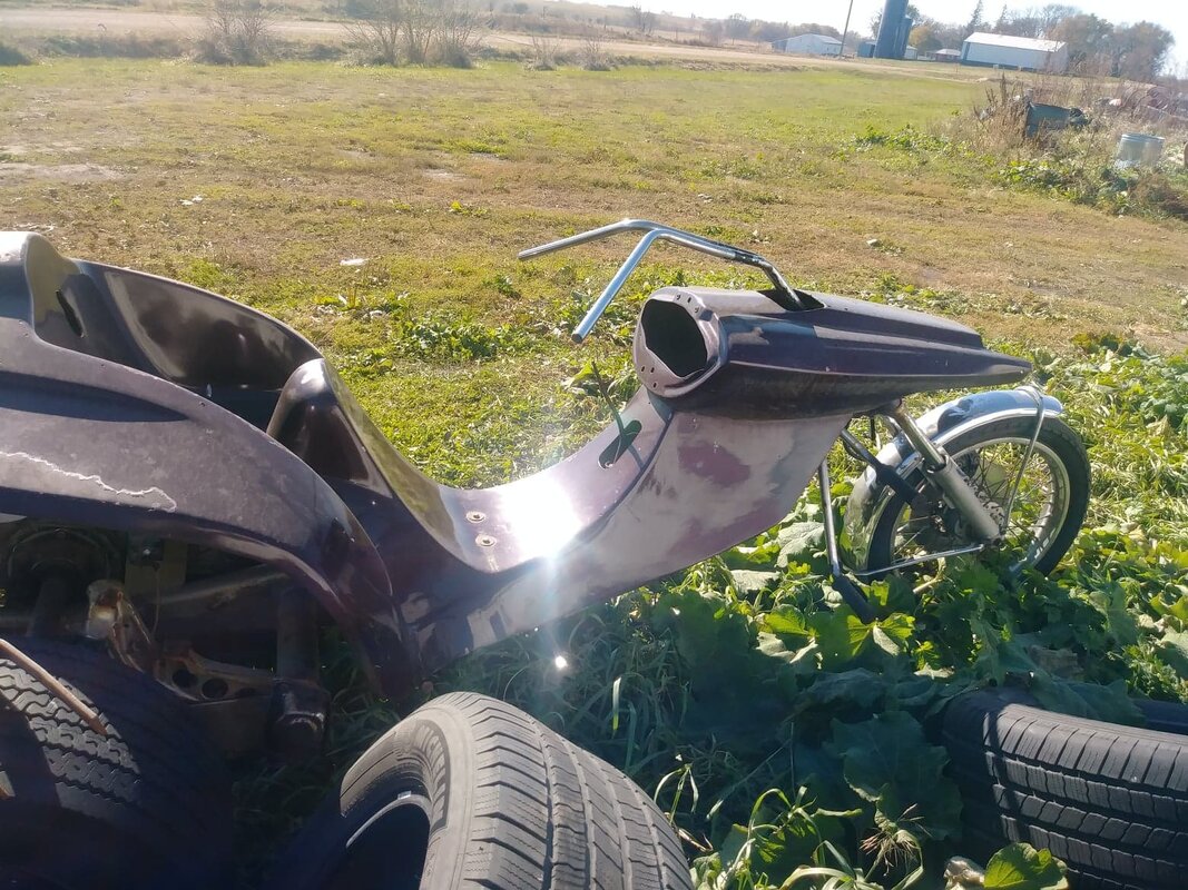

Here are more pictures of the pig trike, so named because I rescued the trike from a pig farm, kinda. Well, the trike was setting in a side yard, and the man did have pigs on his property, about a quarter mile or so away. My daughter was setting in the pickup when the smell hit her in the nose. "What's that god awful smell", she cried, literally. The man said "money". "Money", she's crying and slinging snot like a pro. The man took a deep breath and said "Yep, it smells like money to me". :laugh:Purple Pig 13.jpgPurple Pig 15.jpg
I'll add more after I chop the ice from the garage door so I can get inside.
