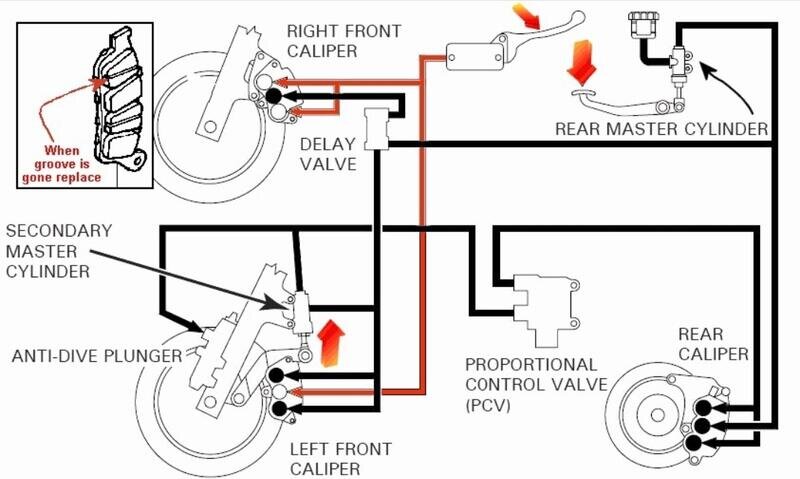

Just changed the front brake pads on my 2008. The left side was worn much more than the right. How do the rear pads tend to wear by comparison to the front?

the right side front will wear faster than the left side front if you have linked brakes. the right side is linked with the rear. in my case i use the ffoot brake alot more than the hand brake so my right side wears more.
as far as the rear pads. iv'e got 25,000 miles on mine and the rears are close to needing replaced. but like i said i use the foot brake primarily.
Assuming that your brake system is still linked, rear brake pedal as well as the front brake lever will operate both front brake calipers as well as rear. With rear brake lever, this is why when bleeding rear brake system, part of the bleeding procedure involves bleeding both front calipers as well as rear caliper or calipers for trikes. Although front brake lever only applies pressure to front calipers, the left caliper is attached to the secondary master and when left caliper is activated, it will cause secondary master to activate and send pressure to rear calipers. Here is a diagram that explains this.
Now as far as right brake pad, if I was to take a guess is that the right caliper is rigid and doesn't move where the left pad has a bit of movement to be able to activate the secondary master. Because it is rigid, maybe it experiences more force and increases the rate of wear???
