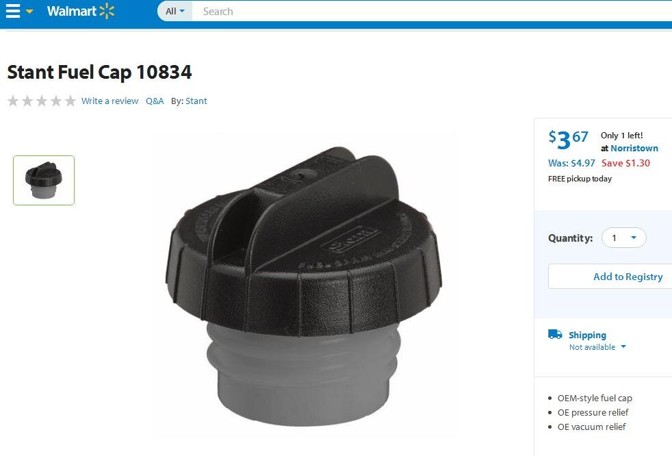

HDBOB is the Stant 10834 the cap that you are using? I'm going to try and use it and see what happens. I went over to the Harley Davidson forum and from what I read, it's the ethanol in the gas making the cap swell. I went and took the gas cap out and left it out over night and low and behold it went in nice and easy when it dried out. This doesn't solve the problem it just shows a probable cause, as you know you can't keep a gas cap from getting wet with gas. The only other thing I can think of doing besides using the Stant cap is to keep a spare Harley Davidson cap with me all the time. This isn't something I really want to do, I guess I could keep it in a Tupperware container with some vent holes cut into it. Thank you Harley Davidson for the P.I.T.A factor in your design of the trike !
